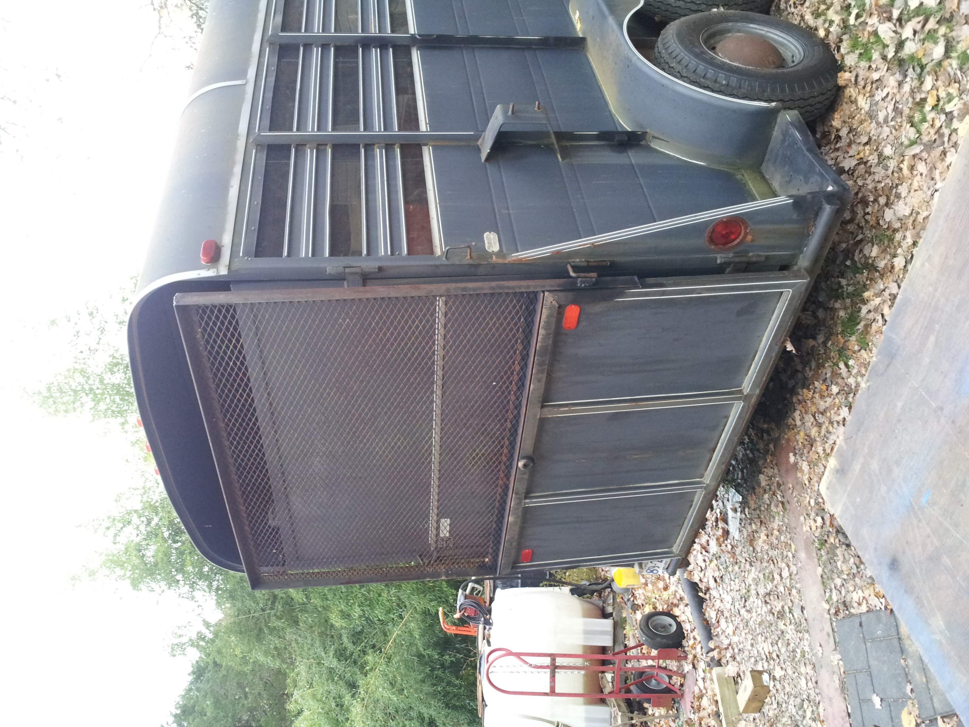

Is there a web site or book I can get to learn how to calculate material strengths for a project?
For example, I just bought a stock trailer to store my stump grinder in, for the shelter and transportation. It was much cheaper than an enclosed cargo trailer, from the prices I see around here. The trailer came with a 3' ramp that was too short for the height of the trailer, when driving a stump grinding up it. I used some angle and expanded metal from a dirt strainer project I did a few years ago to lengthen the ramp. The angle iron used is 2"x2"x1/8" cold roll and I overlapped the old ramp by 12", and extended the ramp out 45" from the original 3'. I welded it on to the old ramp in strategic locations and proceeded to try it out.
As I drove the 3000 lb stump grinder across the ramp it bowed beginning where the ramp extension overlaps the old ramp and extending along the ramp extension.
My best guess at this time is that the 2"x2"x1/8" angle on the sides is not strong enough and I need to reinforce it. I'm thinking that I could just overlay another piece of angle there, of the same dimensions, and double my thickness for that area. I'm not sure how long a piece I should use, if I should go the entire length of the ramp extension or just a 12-18", or what.
This is why I would like to learn how to calculate what I need, so I don't have to be back and redo these things. Usually I overbuild things so I don't have to worry about it, but in this case I need to keep the weight down as I'm the one that has to lift this ramp twice at every stump job.

Unless you have engineering experience, you might still have a hard time working with some references. You will probably be using hot-rolled steel stock regardless, so that simplifies the material characteristics. From there, you'd want to look at beam calculations or tables. Might be easier to look at commercially built trailer ramps and copy what they do.
If you want some free advice from a mech engineer, I'd say you absolutely need some supports in the middle (ie, parallel to the sides, so that they are vertical when the gate is folded up). That would keep the expanded metal "deck" from bowing and dragging the sides down with it. For a 3000# machine, it's going to have to be heavy, no way around it.
For reference, my 7x16 landscape trailer gate uses 0.065" square tube framing, 1.5" square, which has about 2.9X the load capacity of equivalent sized angle iron according to my engineering handbook. There are 8 of the tubes across the width of the 7' ramp, about 12" apart. It's strong enough for my Kubota B2920 and implements, which gets into the 2500# range. One man can tilt it up/down, but it takes two people to easily remove and re-attach the gate (or I use the tractor).
If I reverse engineer my gate design and then re-engineer it using 1/8"x2" angle iron, it suggests I'd need approximately 6 pieces of 1/8"x2" angle to have about the same strength as 8 0.065"x1.5" square tubes. Right now you only have 2 pieces of angle, so you're about 1/3 of where you need to be. Add 4 more angles spaced evenly in between the existing two sides, and I bet you'll be in good shape. Add an extra if there is any doubt, or for extra margin.
I hope that helps.
   / How to do engineering calculations? #7
Personally, I would remove the paint on the bottom of the "ribs" and weld on 4 1.5"x3/16 square tubes. Then, I would add on 4 "feet" that were welded about there the old gate ends and are long enough to reach the ground (possibly make them adjustable?).
I don't see any lift assist springs, so I would also make something like a Gorilla-Lift 2-Sided Tailgate Lift Assist, Model# 40101042G | Trailer Lift Gates| Northern Tool + Equipment to help lift the gate.
I would probbaly also remove the swinging back door to save on weight.
Our 3000# landscape trailer uses six pieces of 2"x2"x3/16" angle for the tailgate (its a split gate so each side goes down separately) and those aren't quite strong enough for our BX2660 and B7500.

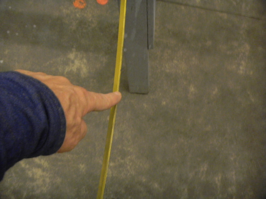

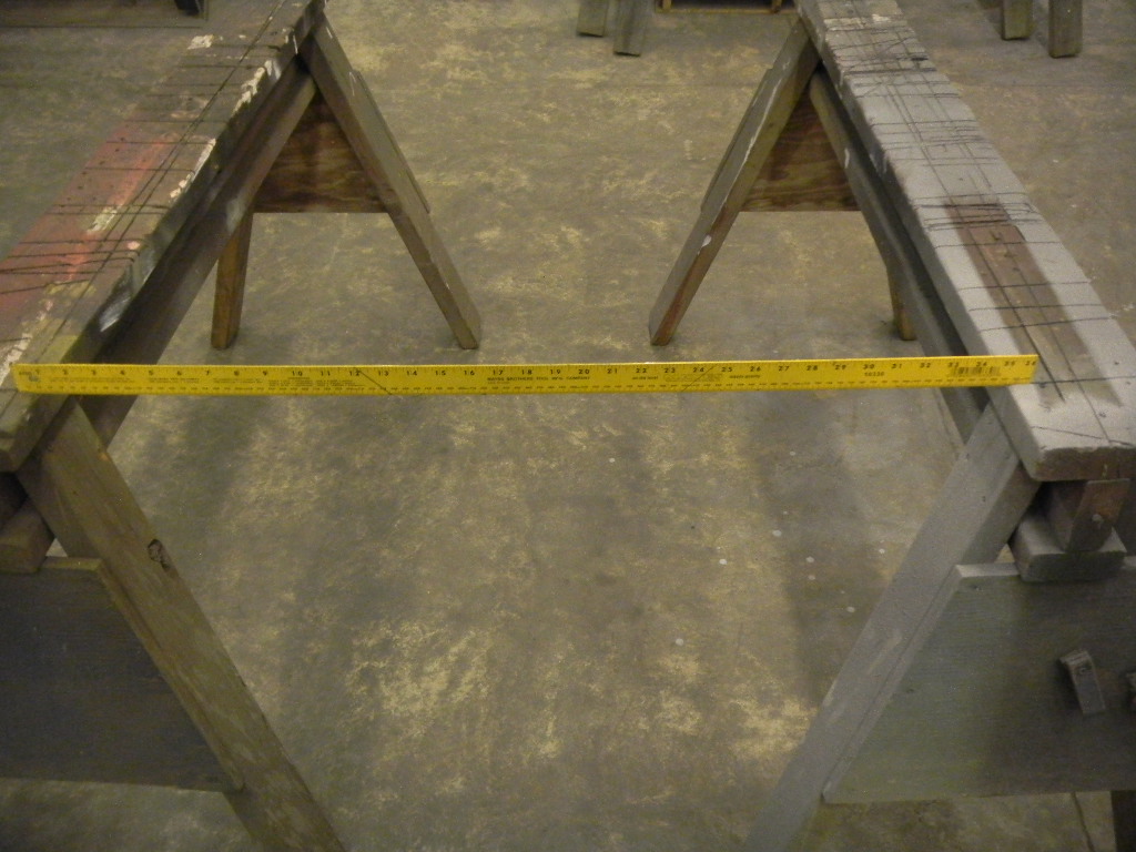

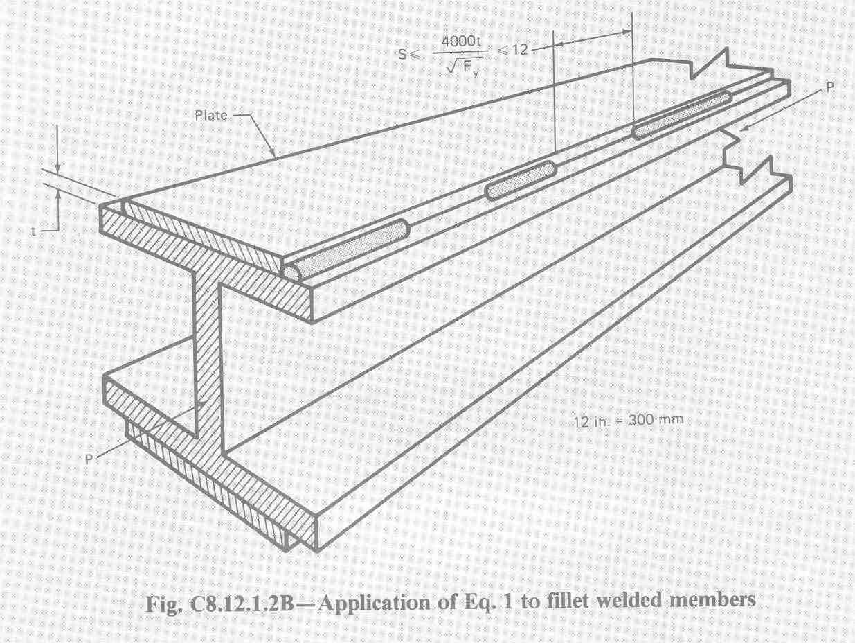

First thing to fail on a beam is the flange. That's why engineers will have you add plate / flatbar to the flanges if the beam is in question.
A "PE" used this analogy to explain to me how a beam fails under load. Take a yardstick, support the ends, push down in the center of the yardstick, what happens? The yardstick bows out to one side or the other. It doesn't go straight down. It bows out to the side until it buckles. So if you beef up the flanges of the beam. Or box the beam in some how. The trick is to keep the beam from bowing to the side. The web has little effect to the strength on the beam.
