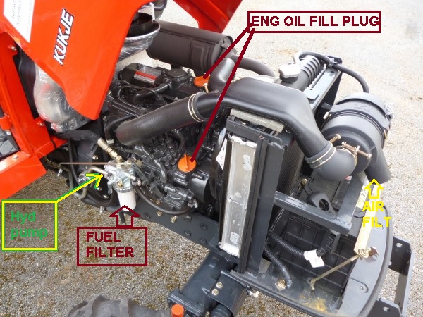

Hello, I bought a used Branson Model #2100 a few months ago. All is working fine, but I have one question. On the very top of the engine is a filler cap, for the engine oil. Just below that is another filler cap to the left of the engine, which is for the hydraulic pump, to power the bucket loader. There is no dip stick there, and I can see the gears in the hydraulic pump, but no oil.
Is there supposed to be a dip stick here to check for proper levels? and how much hydraulic oil is the capacity? and what grade?......Thanks for your future help..Bob

Bobby, can you post pictures?
The hydraulic pump should never have gears visible.
It draws oil from the sump of the rear of the tractor. I don't see how it's possible to "see gears".
Are you looking inside the engine oil fill plug near the fuel injection pump of the engine?
My engine (1.7 liter) has two oil fill plugs, yours may be the same.

I found a picture of a Kukje 2100 engine online and "doctored it up"
Does this help?

Thanks for the picture you forwarded. The illustration sure looks like the one I have. Why would they have 2 engine oil fill plug caps. Is there 2 dip sticks? I only found one. Thanks for your past and future help... Bob .....I have a service manual for this and the illustrations don"t show this, Do I need a owners manual...
Why would they have 2 engine oil fill plug caps. Is there 2 dip sticks? ...
You're welcome.
I guess its a "Cummins thing"?
I have two oil fills on the Cummins in my truck, also - - one on top of the valve cover, the other down in front of the gear that drives the injection pump.
I always just use the "top one" on everything - it's easier to hold the funnel.
I suppose the one on the side is so you can add oil without popping the hood open?
Just one dipstick - - don't overthink this, LOL!
I check my engine oil once every 25 hours - it doesn't use a drop.
