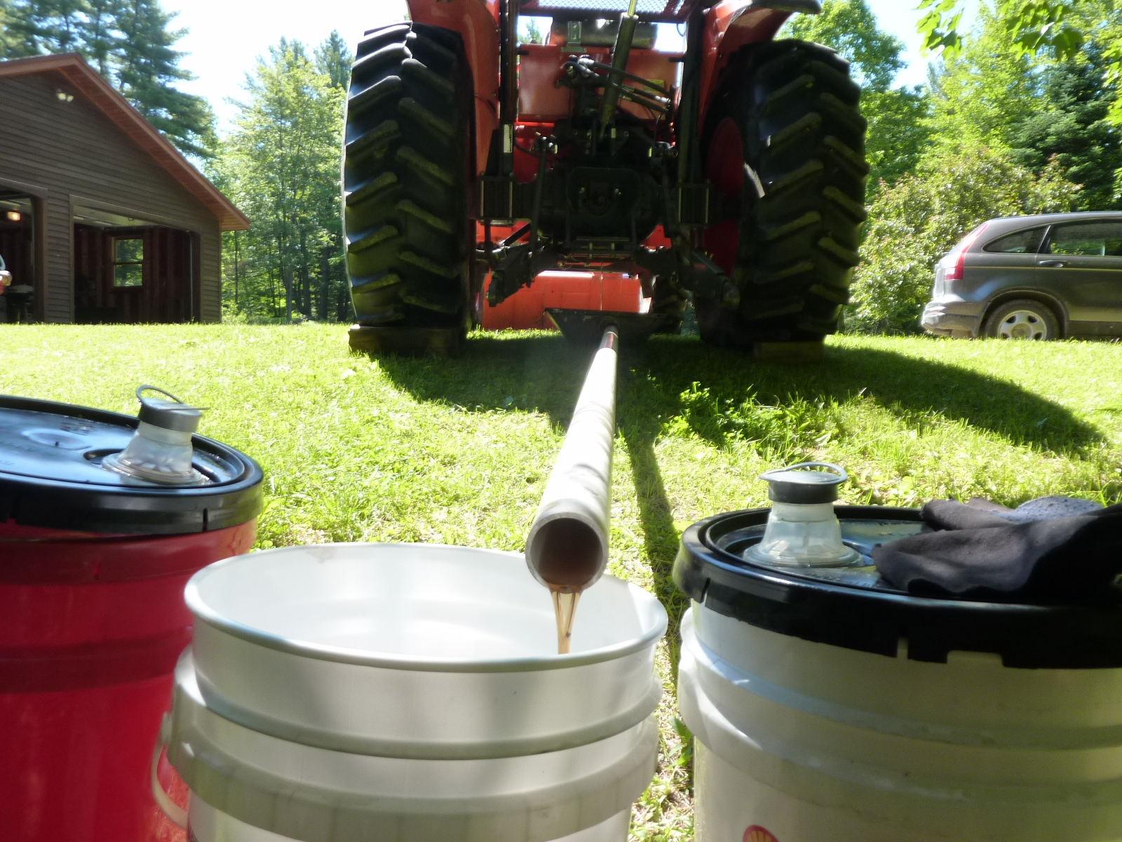

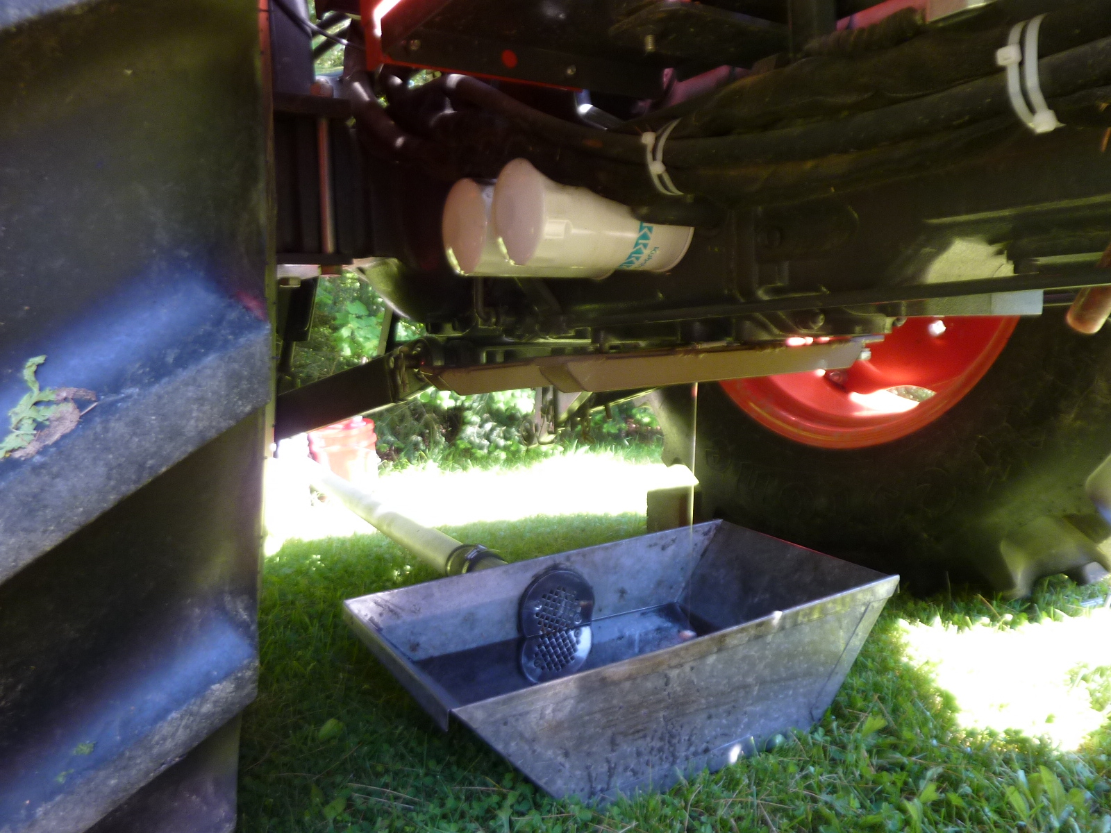

This is how I do it. An old oil pan with a shower drain fitting in the side. A length of PVC down the bank to the buckets. Easy to swing the pipe to the next bucket w/o spilling any oil.

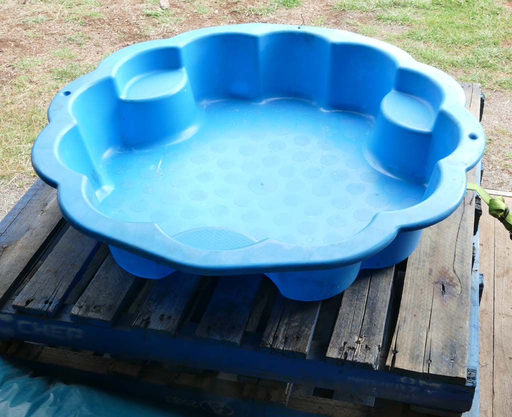

I like the idea of pumping the fluid out, but what I've been doing up till now is drain the oil into a plastic kid's wading pool. Cheap as chips, capacity 110 litres (29 US gallons). In the pic below, it's sitting on a standard pallet (the square one, not the rectangular Euro ones), and slides easily under the tractor from the side.
Looks like an addendum to pallets in the field:eek:
   / How to catch 11 gallons of oil? #24
Don't your kids cry?
