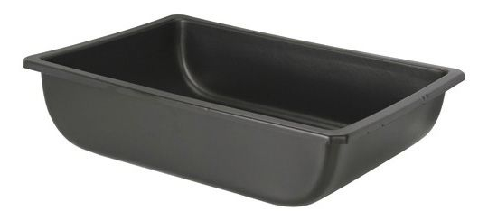

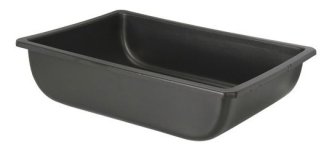

   / How to catch 11 gallons of oil? #12
I get two plastic cement mixing tubs like shown below from Lowe's.
Then, I drain some of the oil so the first tub is about 3/4 full. I put the plug back in the tractor and the tub is big enough to catch any spillage. Slide it out from under the tractor and get a gallon sized plastic water jug. Cut it into a scoop to empty enough of the tub so I can pick the tub up and dump into a 5 gallon bucket with funnel.
Then I do it again with the other tub and empty same way. Or do the two tubs at once. I rarely spill even a drop.

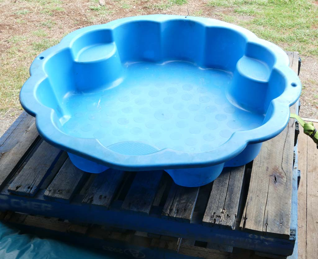

   / How to catch 11 gallons of oil? #18
I like the idea of pumping the fluid out, but what I've been doing up till now is drain the oil into a plastic kid's wading pool. Cheap as chips, capacity 110 litres (29 US gallons). In the pic below, it's sitting on a standard pallet (the square one, not the rectangular Euro ones), and slides easily under the tractor from the side.
