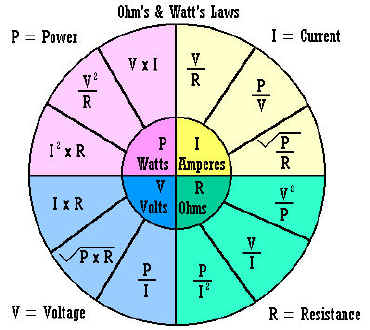

   / How to calculate the change in watts if input voltage is changed? #6
Here's a list of all the formula's you'll be needing.
   / How to calculate the change in watts if input voltage is changed? #7
For the algebraically challenged, like me :laughing:, we were taught the old finger on the circle trick:
E
I R
I = E/R
R = E/I
E = IxR
I wonder if the power factor varies enough between the various generators to make a significant difference?
