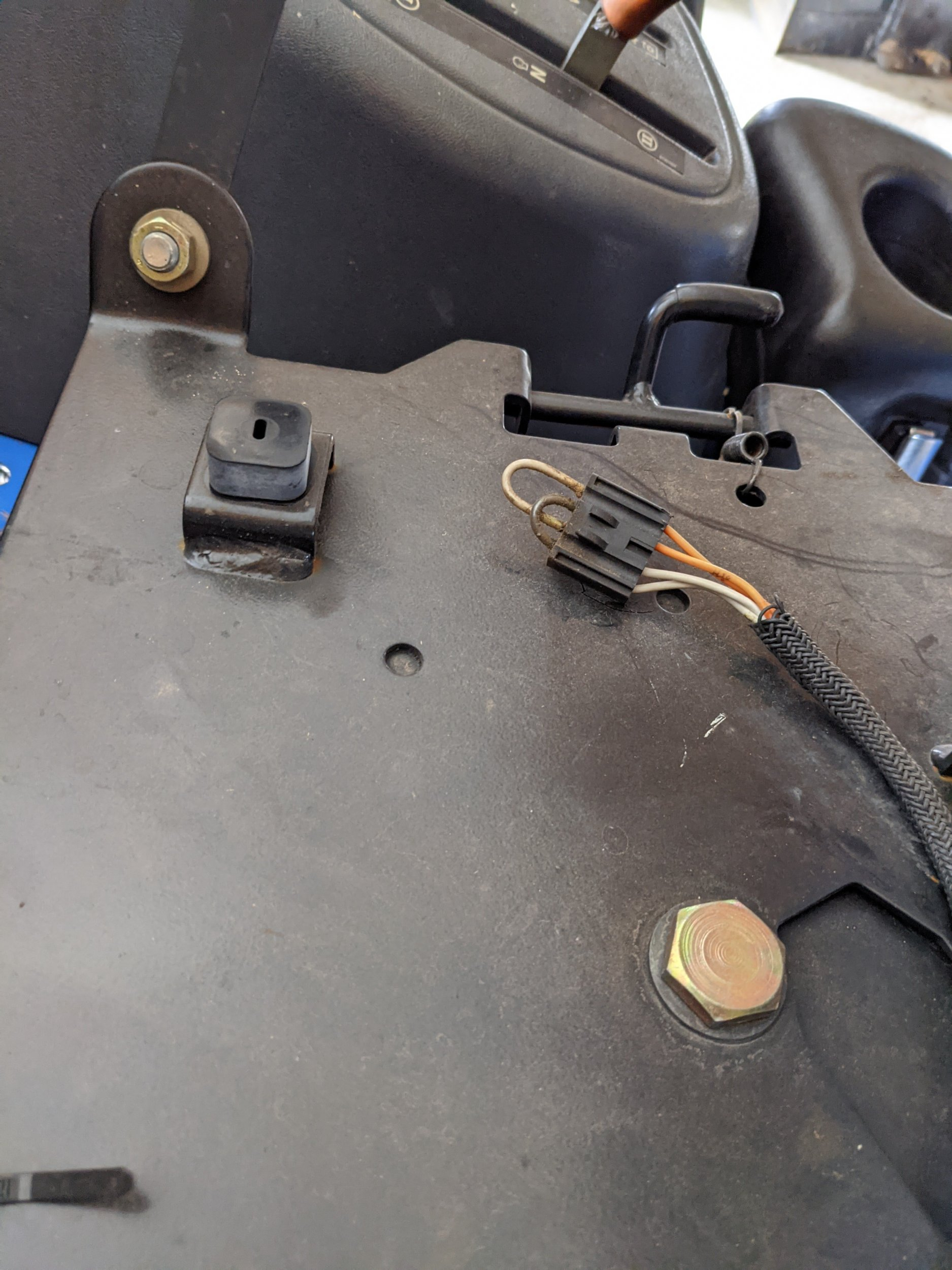

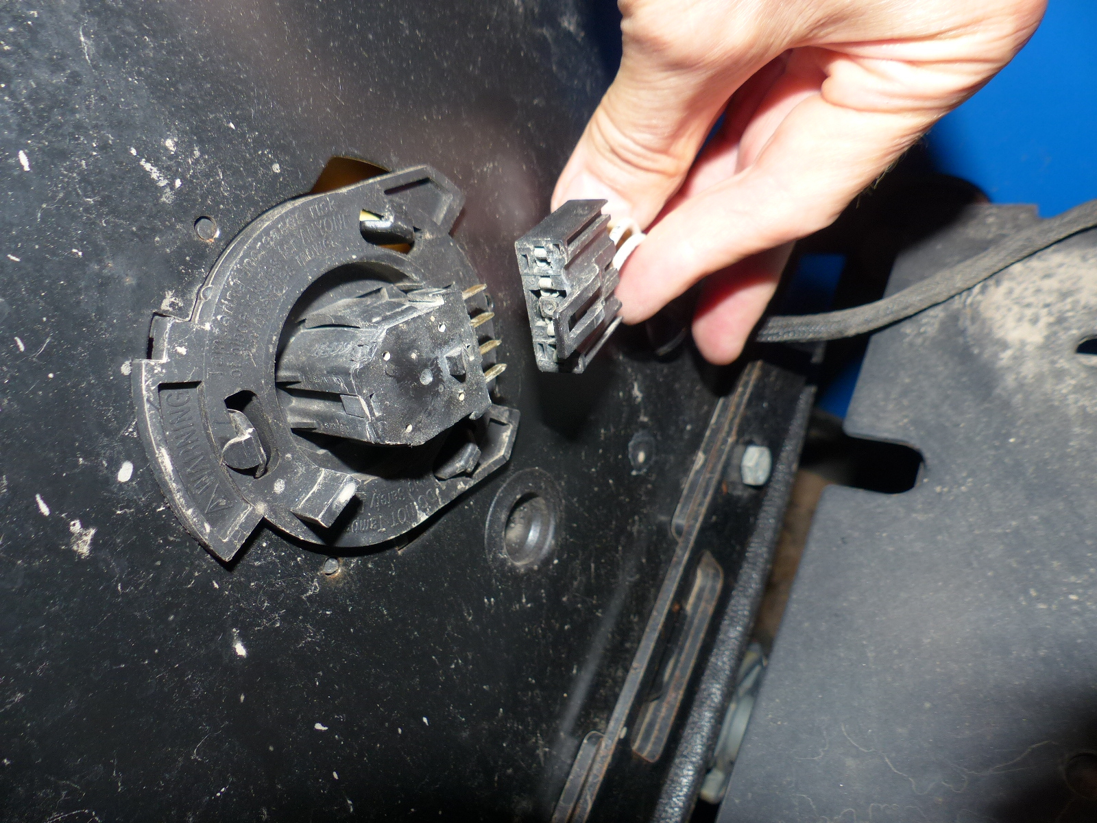

There are occasions when I need to stand up on my tractor without the engine stopping. Does anyone know how to defeat the seat switch. As you can see there are four pins. My assumption is to put jumper wires in the slots. The question is which ones to jump.

Check your owners manual again. Most all tractors have a prescribed method of doing what you want. Without jumpers.
   / How to Bypass the Seat Switch TC34
Thanks, I will recheck that. My recollection is the manual states if you put the tractor in neutral and set the parking brake, the seat switch is defeated, and indeed that works. I would like to stand up while the tractor is in gear, being cognizant of the safety issues there. The other problem with the seat switch is if I shift my weight even the slightest amount, the engine cuts out. It is a poorly engineered feature. I confess to being new to all of this however. I just got the tractor.

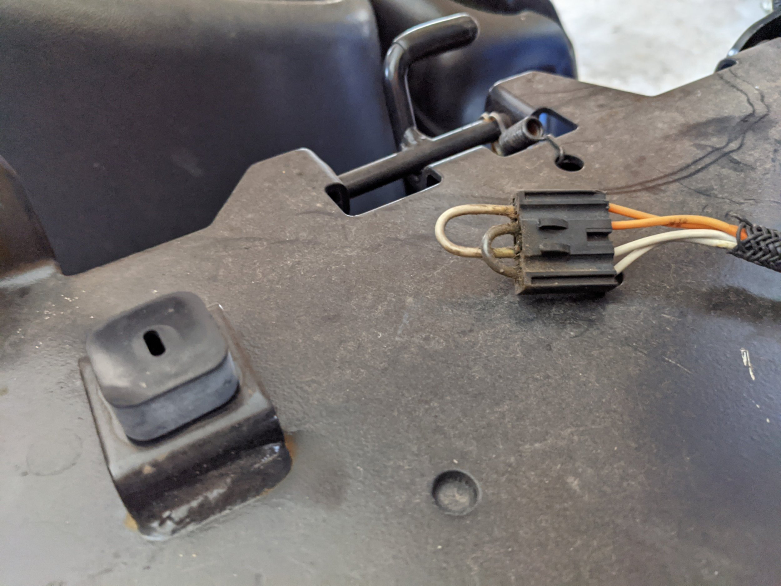

I've got a NH 3040, a newer version of the TC40, and these pictures show what I did about 10 years ago. I have had no problems with this setup.
