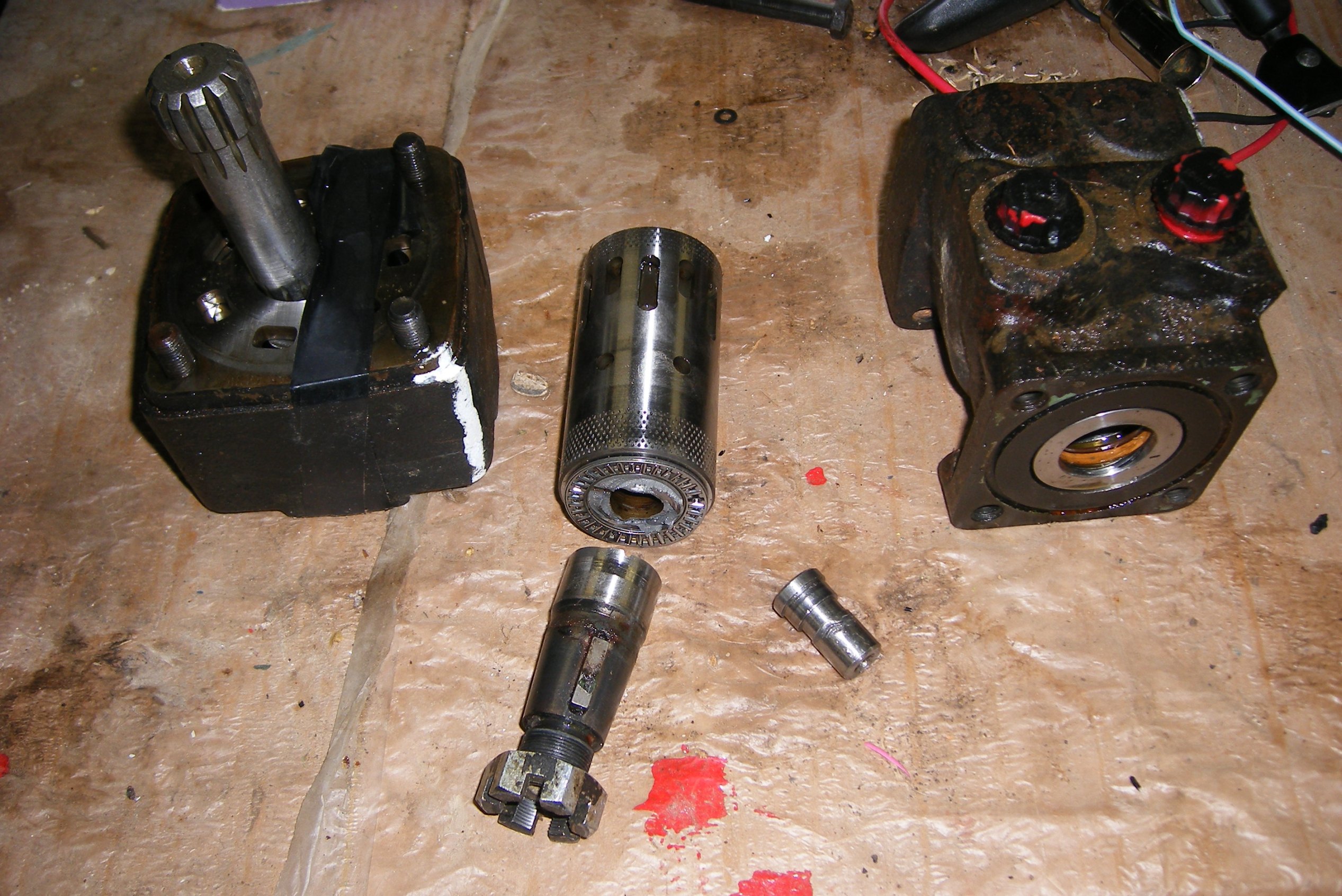

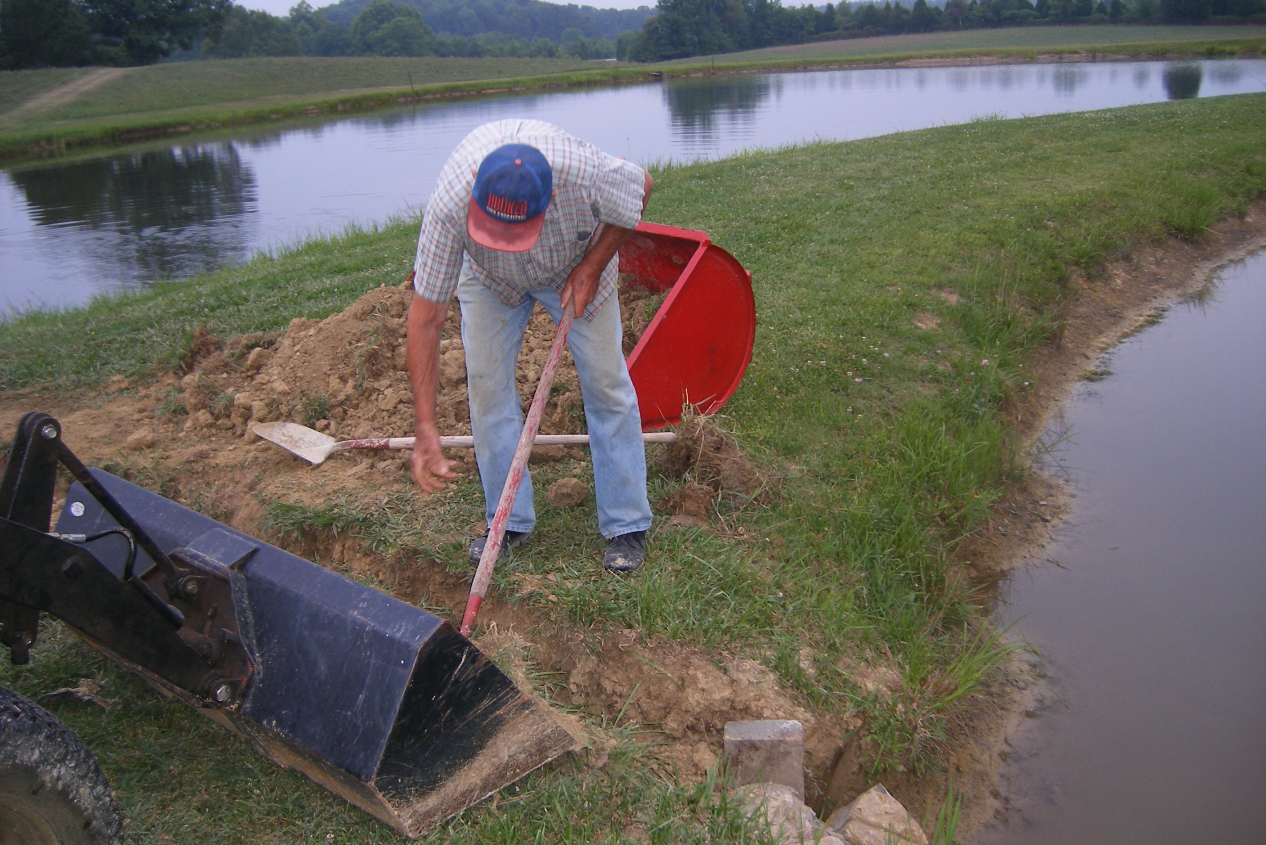

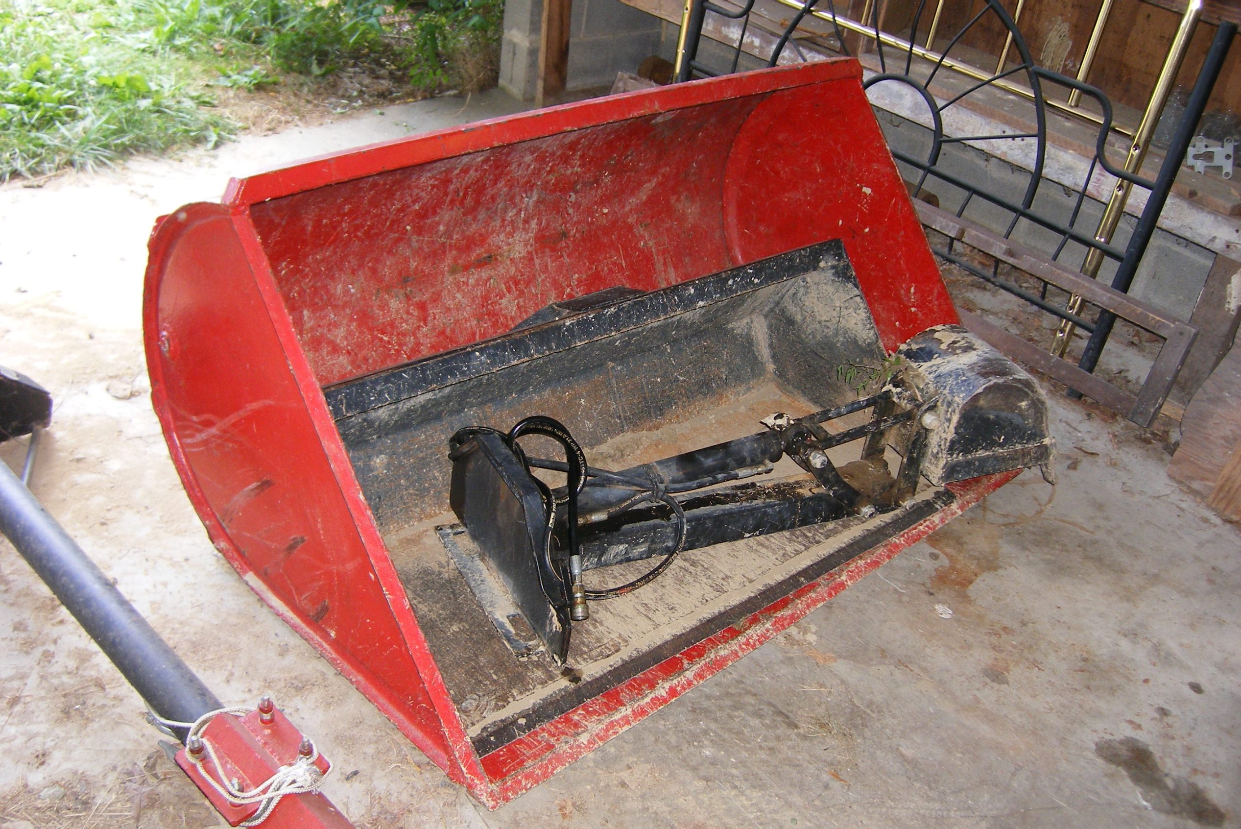

1. Build one large red bucket.
2. Pick out a worthy Job to be done.
3, Get you Dad or someone to do the hard work so you can drive the PT.
4. Now Fill that red bucket with all of the rocks the PT can ever hope to carry
5, Oh Yes! Be Sure to Have your wheels swapped to the wide position to add as much pressure on the motor as possible.
6. Now lift the load and try your dead level best to turn the PT around.
This should do it. If not use more weight so the bucket will only drag, then try to lift while turning. Good Luck
After this I will be Keeping my front wheels (at least while lifting and pushing) in the IN or PT recommended position.
Accept maybe when using the side mower.

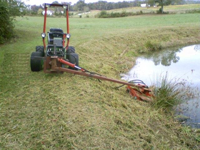

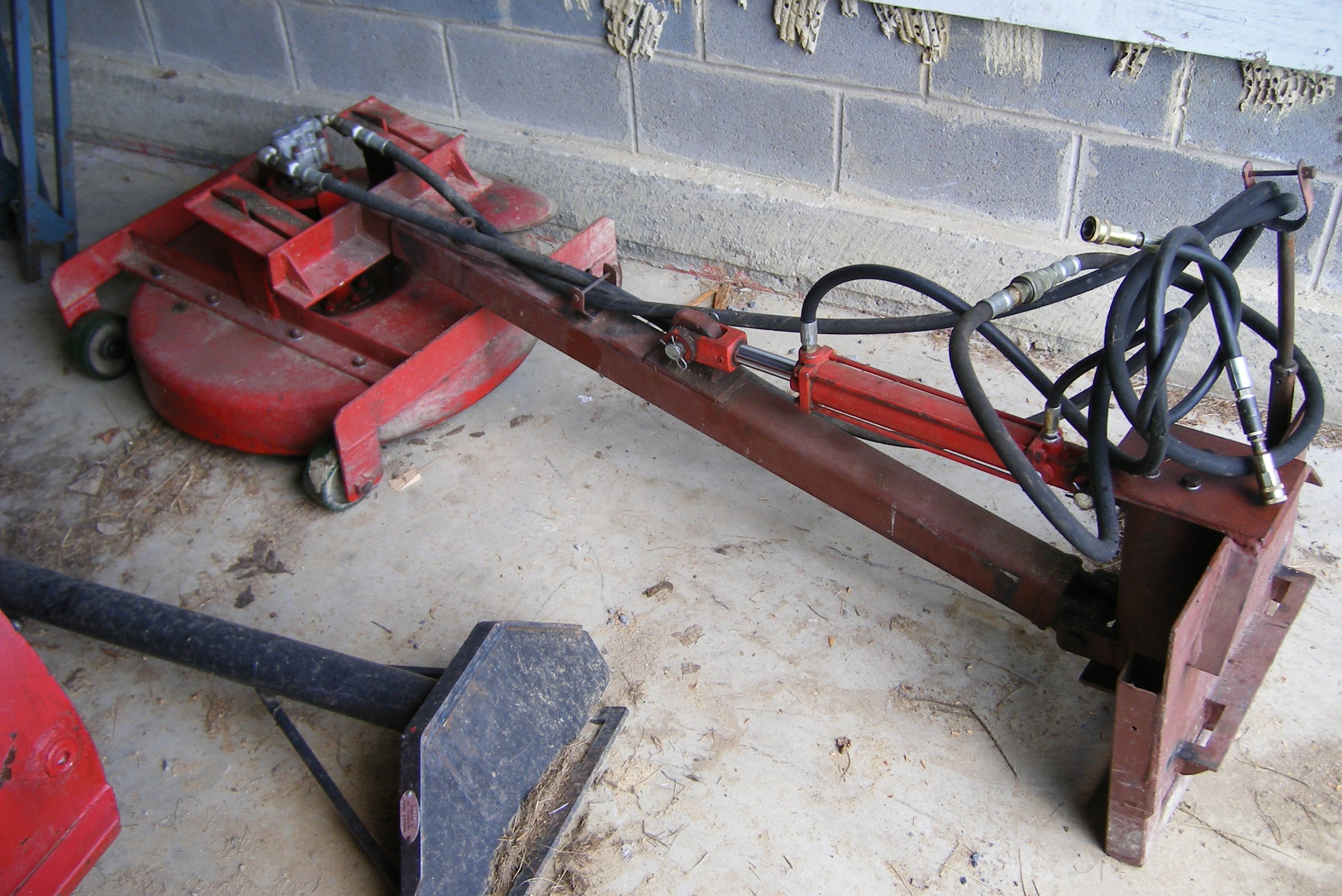

Sorry about the motor... Surprised it failed due to stress...
Tell me more about that side mower. You build it or did you find it somewhere?

Ouch! Broke certainly means broken in that case... :( How much weight do you think you had in that big red bucket when it broke?
What really surprises me is that the shaft was hollow instead of solid. :eek: It certainly shows how the thin thrust bearing carries the full load also, instead of having tapered roller bearings like the larger wheel motors. :p
If those are the Whte RS 12.5ci motors, I should have some used ones in the next few days that I could give you, just a few miles down the road. My remaining newChar-Lynn's should be shipping any day. If nothing else, having one as a spare could be helpful. You've not gotten me thinking about the need to have a spare of these expensive special-order Char-Lynns...
Out of curiouslity, what's the smaller cylindrical piece shown at the bottom center of this picture than has a dimple in the end? :confused: It looks like it has been subjected to pretty extensive wear.

Farmall: Yes, the bucket was made of an oil tank. Some have thought it to be a BBQ grill. LOL Here is the link to the Bucket. Large Bucket Container. - TractorByNet.com
Kent: I probably had over 1200 lbs in the bucket. After I installed the new wheel motor I loaded half of the rocks out of the red bucket into the OEM PT bucket and that was still a good load.
If we can ever get together we will haft to do some trading. A good used wheel motor should be worth a Quick Plate? I'm anxious to here how your new wheel motors perform. What cubit inch are they?
I'm not sure what the small piece is but it slid into the hollow shaft and it looks as if oil pressure flows around it into a small hole that runs form the inside to the outside of the shaft, providing oil pressure to a sliding surface.

1200 pounds, eh? That makes me feel better about lifting 500-600 lbs with my wheels reversed...
I'm putting 23.7 ci wheel motors on it -- still trying to get that doubled power/half speed solution of the possible mod we discussed. I figured that if I'm going to spend this much $$ to go for the biggest ones in the series -- if I need to, I can always put 26x12x12 tires on it and "gear it back up" a little bit...
A used wheel motor for a Stray-made QA plate sounds like a good trade to me. I'm trying to figure out how I can put some of them to use -- I finally found a source for tapered 1" hubs that you can choose the size of pulley to bolt onto them. With that, you can change the effective speed of whatever you're driving by using the different pulley sizes. So, I'm thinking of possibly converting my 46" belt-drive Simplicity tiller to a hydraulic drive for the PT. Still looking for an affordable way to make a post-hole digger using one of them, also, in addition to other things. Maybe even a knuckle-boom mower like yours...

That is too funny! When my pops was alive I recall several situtations where we could have taken that same photo. :D
As for your wheel motor, I had my money on you and that big red bucket all the time. Most of the folks had their money on FOURTEEN, but not me! ;)
Just kidding... sorry to hear about it. I was really hoping that it wouldn't happen to anyone. But, you really use the heck out of that thing and are one of the PT test pilots, for sure. Glad you got it going again. :)
