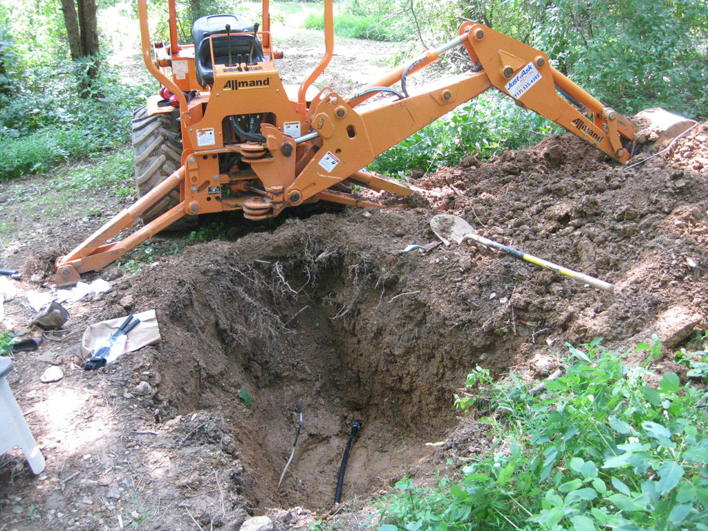

dfkrug, I'd like to say thank you to you again for posting this. I used an integrated TLB/backhoe for the first time yesterday and that machine was getting tossed around like a hot potato in my hard, rocky soil. And I was being gentle on it since it isn't mine and I didn't buy the insurance! Even just reaching the end of hydraulic travel on a cylinder made the machine jerk around. I can't imagine how you can use a 3pt mount or the rockshaft-assist mounting plates with an aluminum housing. Just can't see it. But now I can (and will) buy any properly-sized backhoe and use your design to attach it right. So... Thanks!

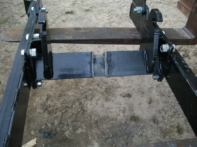

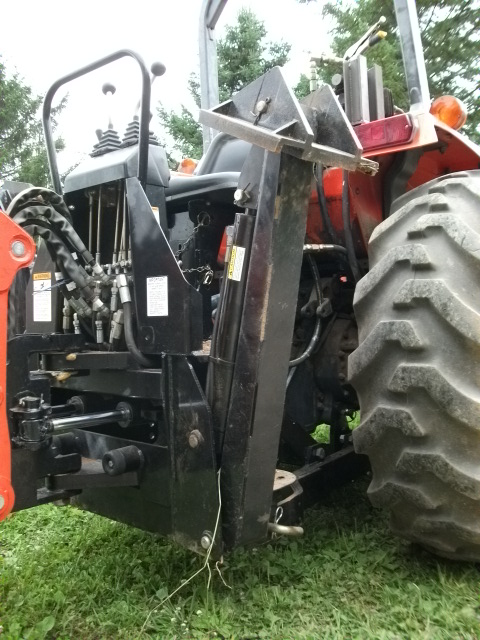

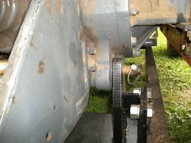

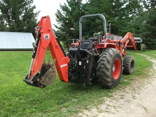

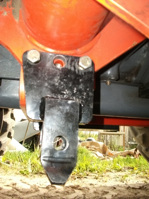

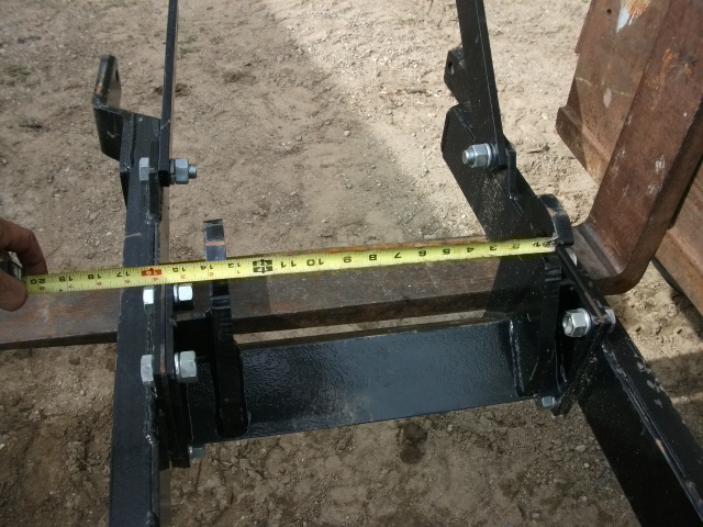

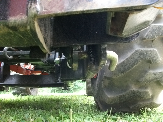

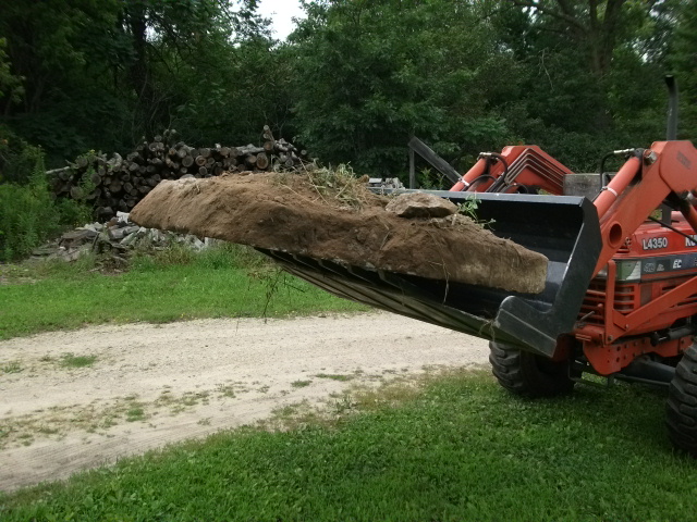

Recently completed my retrofit of a frame kit that was not made for my tractor.
Pictures not in sequence but in a nutshell had to widen the frame to fit two contrasting areas. Ended up chamfering the hooks that go on the 3PT pins so they would fit snug and allow the forward hole alignment to be correct. Everything fits REALLY snug as I had not much room for error. I like the Bush Hog Hoe. Only have to run at 1200-1400 rpm's to get satisfactory power. It is a heavy unit, much more so than the Prairie Dog Digger I had before. I plumbed it in sequence with my loader valve-rear joystick-backhoe-3rd remote. Have not had it off yet so don't know how easy/hard that will be. I took the 3PT arms off but see I may be able to leave them on as there is room. I also have some hose issues to clean up and some stabilizer pads to make among other things. Another Day.......................
