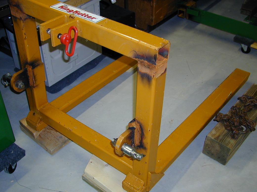

Here are two more attachments I plan to use. First is A King Kutter Pellet Mower I had to special order from TSC - Around $200. - Had the welder modify it to fit the JD Imatch - He cut off the top Square (top link) and lowered it - Lower pins had to be moved out an inch on either side. If you have a Quick Hitch on the front and the back ------- Wow think of possibilities - Every 3 point attachment you have can be mounted on the front or the back (Use some common sense) - I picked up a Carryall (Wallace brand) at TSC for - $17.50

cwave - Thanks! I'll probably get the Quick Hitch at TSC. They usually have a 10% off sale in the spring, so I should be able to get one for $180x.9=$162. I'm still working on tracking down a Bobcat dealer. If I can get a Skid Steer plate for $75, I'll only have a total of $237 into the complete adapter, since I can do the welding myself. It won't be as heavy duty as yours or Spencer's, but should be fine for me.

</font><font color="blue" class="small">( A King Kutter Pellet Mower )</font>
I definitely had to look at the picture trying to figure out what a "Pellet Mower" was. /forums/images/graemlins/laugh.gif

On this attchment I decided to skip the 3 point hitch and go with the Skid Steer plate - 1 less piece between the loader and the attachment. This piece could probably be made to be work with either a skid steer plate or 3 point hitch. (able to hook on to back end 3 point hitch).

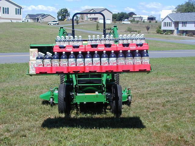

I call it Forks on the Cheap - I don't plan to lift anything heavy. I plan to use it to move my 2 liter Cokes - I buy them 100-200 bottles at a time.

Bird - It's a good thing good typing skills aren't a requirement for owning a tractor!

cwave - I have that same pallet mover. I got mine pretty cheap because someone special ordered it and then didn't pick it up, and they needed to get rid of it. I won't tell you what I paid, since it might make you feel bad /forums/images/graemlins/tongue.gif. I'm not crazy about the idea of modifying it that much to make the quick hitch work! But, I guess I'll see how the TSC one lines up. Maybe I'll just bolt a Skid Steer plate right onto it instead.
