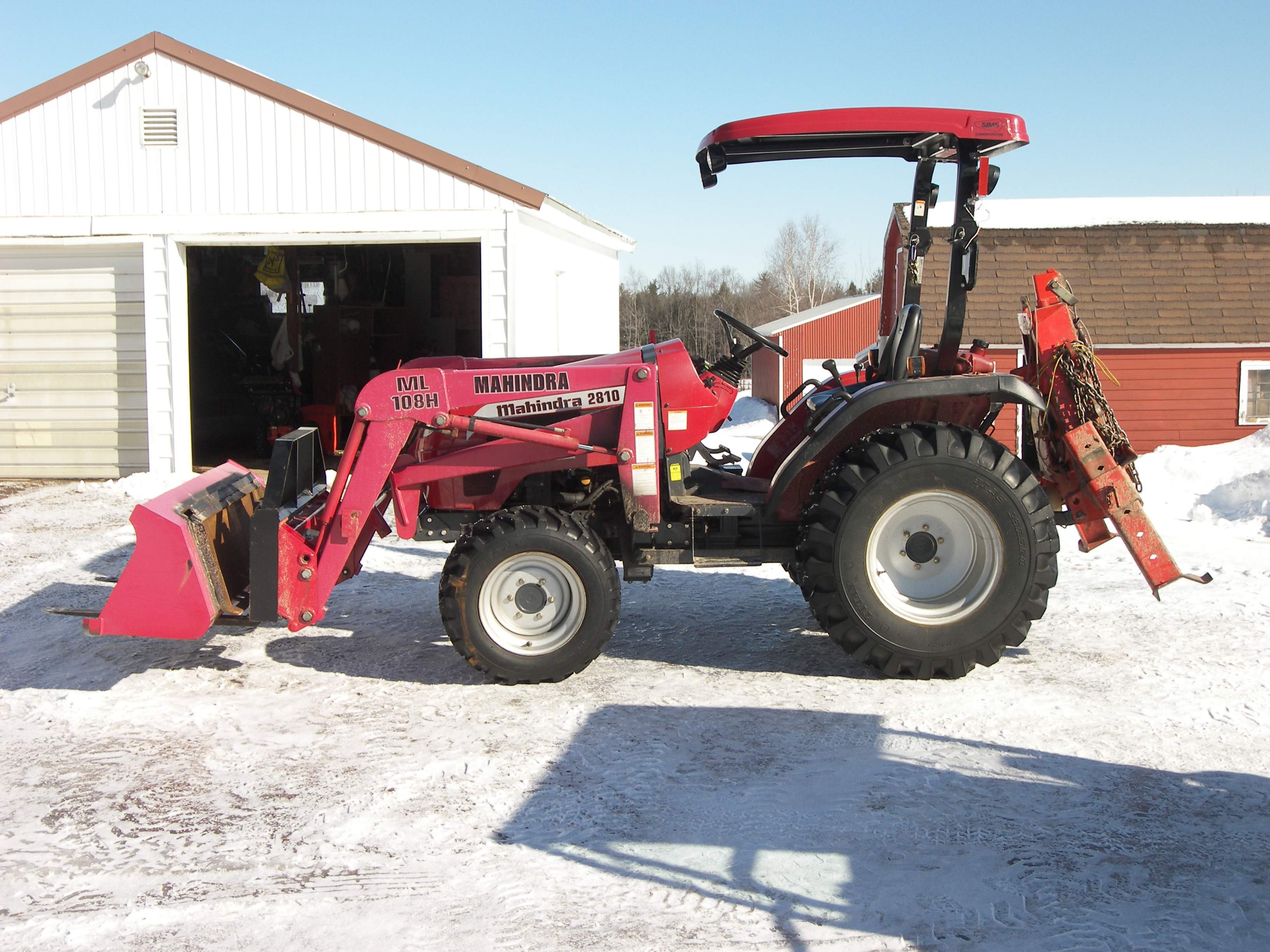

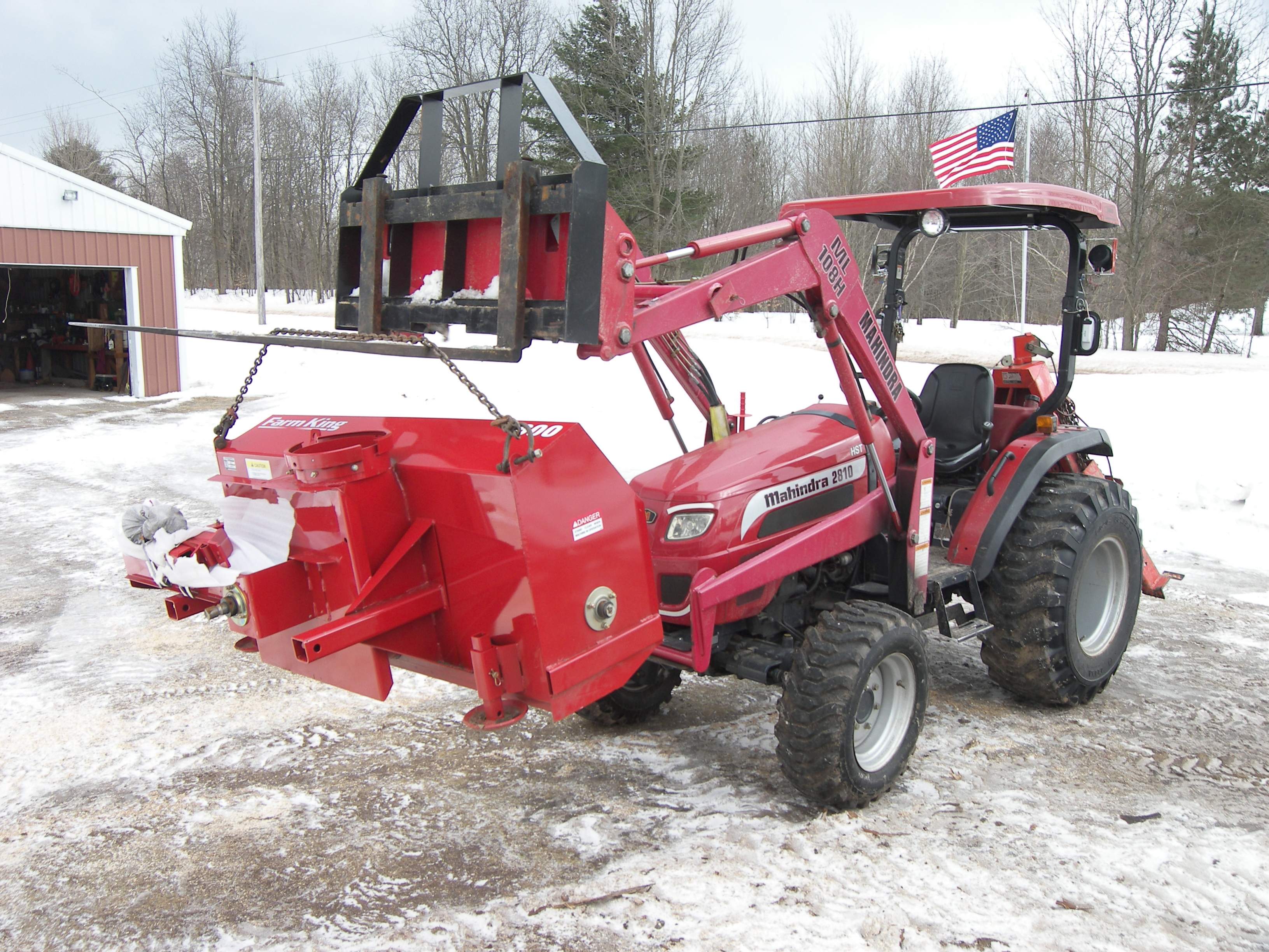

/ how to bleed fuel lines #14
Ya know this is all new to me. I have a 2810, and have run it dry several times the first week i took delivery. The only thing i did was put fuel in the filter , tighten it up, get on and turn the key. A couple of seconds later it started and i was in business again. This is the easiest tractor i have ever started in this situation. Love my Mahindra! . . .John
