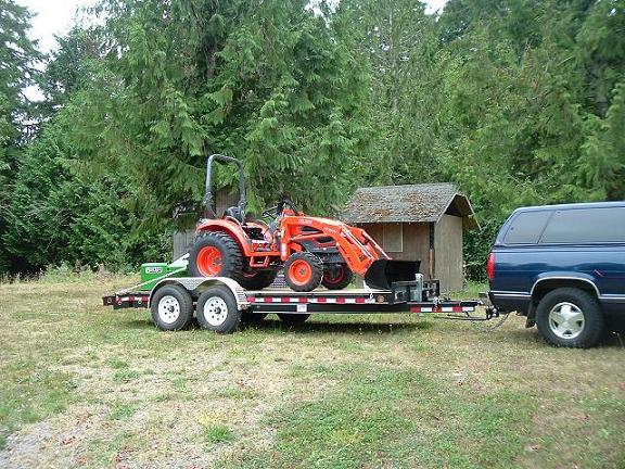

The tandem axle trailer is not two separate independent axles. They share a goofy center suspension support to allow the axles to evenly carry the load between them even if the tongue is high or low. It is amazing to go over speed bumps since the trailer stays level and the axles articulate over the hump. Regardless, both brakes having axles is superior.
My trailer, a 10,000 lb rated car hauler type bumper pull trailer had directions for loading. The axles are set at a particular location such that an even application of cargo across the trailer deck would give the ideal 10-15% tongue weight. Empty, the trailer weighs 2500 lbs with 250 of that as tongue weight. Pretty good. Too bad I don't know the center of gravity of the tractor or I would center that over the centerline of the deck, instead I try and center the load on the trailer to start and be sure that there is a good settlement of the ball.
To fine tune I go to a closed weigh station on the highway. These are most often closed but they leave the scales on and visible for people like me. Loaded with my 4500 lb tractor I have a 7000 lb trailer so shoot for just over 700 lbs on the tongue. Then take a marker and mark the trailer deck with the location of the bucket lip or something else that will make it easy next time.
I also adjust my hitch head to be sure that the trailer rides level just so that the ball is in the center of its operating range, butt is not dragging, and to keep everything looking right.
I am a big believer in the weight distributing hitch and the hitch has a setup procedure too that involves the weigh station so I spend a good bit of time there adjusting things. Once everything is set right, just use it.

Your rig looks to be the same approx size as mine. The rear tires are centered directly between the trailer axles. Does that match up with everyone else who has replied and helped me? JD 790 which is the same physical size as almost everyone elses 28-32HP on a 16' trailer. The back 3' of the tractor has all the weight of the tires, rims, fluid, fenders, seat and the rear end gears. I assume all that weighs 1500# in just the last 3'. If so, then almost half the entire load is located between the axles which are about 3' apart also. I like your heavy use of the new DOT colored tape.

The tractor and trailer were new in that photo. The manufacturer, PJ Trailers, installed the DOT tape all over. I rather like it. It also runs across the entire tail. The trailer has been a source of great pride. It is a work of art.
It is real weird, I go over speed bumps on my commute and the front of the truck goes up and over then the rear end and then the trailer just floats over it.
That's an 18' trailer including the 2' dove.
