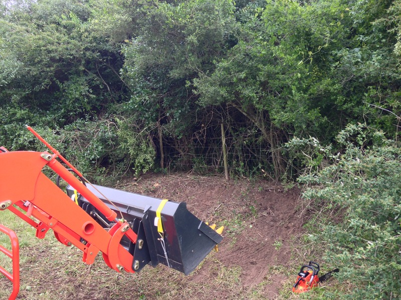

Went and picked up a rachet rake from TS and tried it out on a random spot. I have to admit I'm impressed with it so far and I'll only get better at using it.
Before shot and after shot. Definetly going to need a pole saw to reach in and cut limbs that are overhanging the fence.
