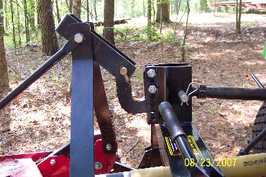

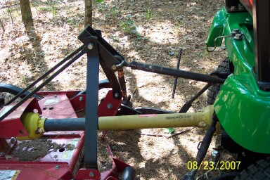

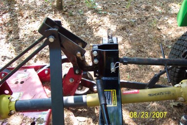

I got this thing from Harbor Freight for my 2210:
Top photo shows my mower attached without the Quick Attach thing. Bottom photos show the iHitch type attachment. In the bottom photos, everything is connected except the top arm.
How do I attach it? I went by local JD dealer today, and mine looks the same as the JD one. Guy there was no help...
In the last two photos, you can see my problem: How do I get the top pin to stay in the hook on the Quick Attachment? As you see it in the photos, everything is attached except the top arm.

Mac, I think you will have to modify your mower and any other implements you want to use it with.
I know when I bought my Imatch only jd,woods and Frontier implements would work with it. looks like you need to find a good welder! but when you have them modified you will love it! MH

If all your other implements have the same height top link attachment, you'd be better off moving the hook on the iMatch up so it fits, instead of modifying every implement.

3RR, I have it all the way up now. Maybe I have to do some adjustment on the mower's top arm?

Yours is better than mine,lol. It looks like you need to ditch the hook and just pin the bracket through your top link but then you will have to get off and pin the top link everytime. Where did you get the top bracket?? Cuz I need one.

It looks to me that the mower could be put together differently, possibly making it work. When I look at the pics, I see the flat iron that forms the upper support of the mower's 3-point frame, and the lower end of these are mounted to a bolt. There's a bolt about 4 inches lower too. Could the flat iron brackets on the mower be moved down to the other bolt I see in the pic?
Another idea: When I bought my Speeco QH, it came with this extra part that works with implements that dont quite meet standards. Here's a link:
http://www.speeco.com/asp/display.asp?view=top&category=Category+1+Quick+Hitch+Adapter

Yep, that is what came on my mower. It won't stay in the hook...

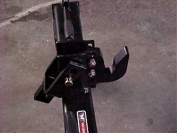

I found what I need to make this thing work! On, ahem, another tractor forum... where I posted the same question... Anyway, here it is - the Y shaped thing attached at the hook.

When I installed my HF quick hitch I had a similar problem with the top link on my Kubota finish mower. One very quick solution is to not connect the top link and just let the mower ride on the rear wheel(s). before I bought the quick hitch I used to disconnect the top link to mow anyway. What I've since done is remove all of the black flat iron (in your picture) that holds the top link pin, and replaced it with a chain and hook. Now if i pick the mower up all the way it will lift the mower tail wheels about 1' but when mowing the chain has enough slack to float over all my lumps and bumps. This worked great on the mower, but will not work for most other attachments.

See that bracket extender thingy on the top link connector on the mower? The one that's angling down? What if you remounted that so it's pointing straight down? Then, on the tractor, adjust the top link turnbuckle a little longer. Seems like the top link point on the mower should be further forward anyway.

MacLawn
The link on your mower is the toggle so when you go in a valley the mower and tractor will flex.
If you go in valley when rear tractor tires are in center they would be in air (I'm exaggerating some) and all the load would be on mower rear wheel and front of tractor
Please excuse the crude drawing I ain't no artist
tom

Your RC has the same basic arrangement as my Woods BrushBull. The only thing you will need to make that cutter QH compatible is a 3/4 x 1 1/4 by whatever length fits in the link, bushing for the U shaped bracket. Rhis bushing will adapt the size if the top link on the cutter to the top hook on the RC..

That thing is available from HF for about $10 and is mentioned on the HF Q/H threads in this forum. About a yr ago.

You can order the Harbor Freight Quick Hitch Adapter by calling 1-800-444-3353. Ask for Item #29309, Description "93691 Hitch Adapter". It is not in their catalog or web page. When I called it was $8.79 plus 6.99 for shipping.
