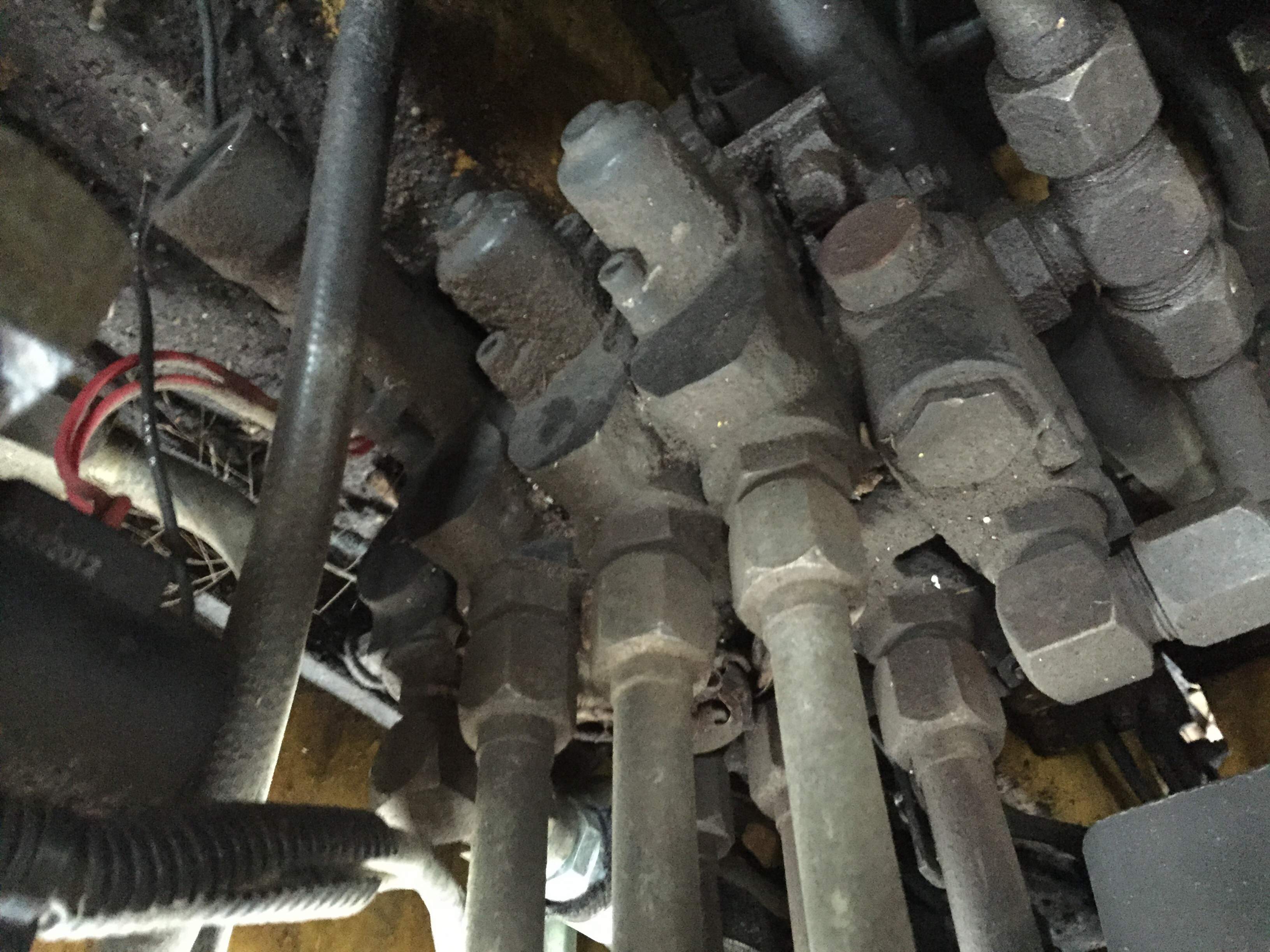

I put a gauge on my skid steer and confirmed that my relief valve is opening a couple of hundred psi too low. I know the relief is part of the valve assembly, but I don't know what it looks like or how to adjust it. Any suggestions?

Well, this is the best pic I can get without tipping the cab. Hopefully it helps.

Where is it in the photo?
/ How to adjust a relief valve? #10
The Acorn nut assembly on the left of the valve.
Your relief valve is usually close to the IN port.

That's what I thought. I took mine off and found a screw under the cap. Turning it in didn't change the pressure. Honestly didn't know what the screw was supposed to do. There is another section to the left and this one looks simular. When I take the cap off I don't have a screw under it.
/ How to adjust a relief valve? #12
Cord you have posted a picture of the control valve. That is not the relief valve.
Did you take a spool cap off? Not sure what you are referring to when you say you removed a cap.
If you are afraid to lift the cab you had best take it to a shop.
From the looks of your picture I would suggest you lift the cab and give it a bath.

Per the manual, the relief is part of the control valve. When I was talking to my dealer, they said to adjust the relief on the far left section, but I don't see a set screw there. There is a relief at the second section, but per the dealer this just adjusts the lift circuit relief. I was testing the relief using the curl feature and adjusting this set screw did not change the pressure setting. Yes, there is a gauge on the machine. Currently the relief is opening at 2500 psi. Per the manual, this is supposed to be 3,000 psi.

That is where the relief valve should be.
Is this the first valve off of the pump?
You could also have a no relief plug in place of a normal relief valve.
If there is one relief valve in the circuit on the first valve in the series flow, every valve does not have to have a relief valve. The one relief valve will protect the pump.

The picture he posted is really not that clear. It kinda looks like the type that you release a lock nut than turn the body and than tighten the lock nut. Or as you say split the body and add a shim.I have worked on that style with some old RexRoth systems. It is hard to tell with the picture,any Ideas?

The drawing is correct. Supply is on the far left with three spools. Per the dealer the lift has a circuit relief. The main relief should be to the left, but when I took the end cap off there wasn't a set screw under it.

That is the IN port you have label lift with float, and the relief valve has the acorn cap on it.
J_J
The valve section labeled in Cord's photo labeled "lift with float" has 2 steel lines attached to that one section so I think it's not the "in Port".
/ How to adjust a relief valve? #20
Well, it is not a spool valve and it is close to the IN port, and I don't see any other something that looks like a relief valve.
Cord, can you get a name or model number from that valve.
