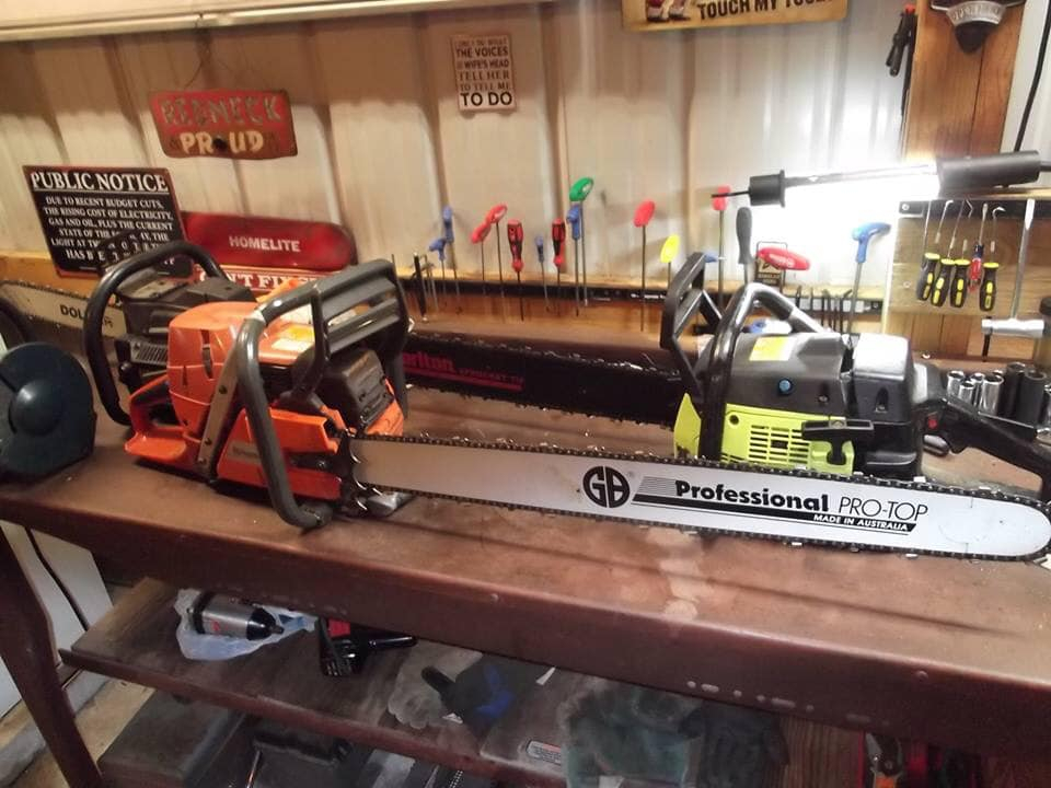

Something else to keep in mind, mainly just for safety reasons. The longer thin safety chain consumer bars are subject to flexing from side loads. Meaning when most people are felling they tend to pull up or push down on the rear handle. That pressure can flex some of the bars enough to throw the chain off. Ran into a saw a few years ago that the customer was complaining of the saw cutting moon shaped. found that you could pull up on the rear handle in an attempt to rotate the bar through the log that it wouldn't stall the chain but would cause the bar to twist and cause crooked cutting.

Probably running 1/2 pitch chain and those things would toss some chips. I ran across a 50 cc saw a few years back that came from the factory with a 22 inch bar that was one of those narrow safety bars that was probably 2 inches tall. If you set the nose of the bar on a stick of wood and held the back of the rear handle, the weight of the saw would cause the bar to deflect over an inch.
Had a neighbor with a Stihl 880 that if he put his 59 inch bar on it and turned it sideways to use it for felling the bar droop would throw the chain off of the bar. Had to have the suicide handle on the end to start the cut to hold the bar straight,
