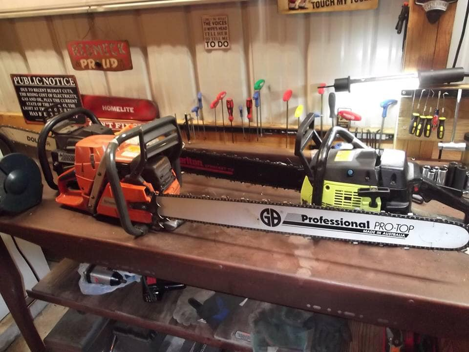

I want my chain to be just loose enough that No matter what, it will never get tight.
A loose chain can tilt in the cut a bit more easily, and a loose chain can be a problem in the drive sprocket when cutting "UP".. But loose.. is relative. I usually need to adjust tension every third fuel load. or so..
Now hanging below the bar! Just running smoothly.
