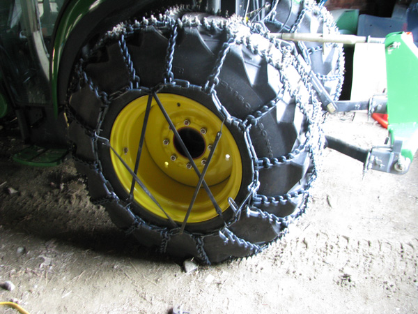

No one has mentioned the danger of a chain coming off the tire. If a chain should break or be a poor fit and come off, you want the chain to come off to the outside. A chain coming off to the inside whilst your operating the tractor is not a good scenario. This is the best reason I know for having some tension device on the outside. Either the fancy spring tensioners as some have or a good rubber bungee.
As for loose or tight, I like just right. I think the most important thing is to fit your chains to your tire. This might mean you need to cut off and remove excess links or ladders or even reposition ladders to achieve a just right fit.
When I ordered the chains for my tractor, specific for my tire size, they came with an extra ladder installed. Why I have no idea. It was a PITA to open the links with hammer and chisel to remove the extra ladder. I also found there were excess connector links when snug so I cut those off as well. No need for excess links to be flopping around. In the end I got a just right fit and I add a good rubber bungee on the outside to tension.

Here is a pic of my new chains...
[/IMG]
/ How tight are your chains? #49
Good looking set of chains. Looks like you got them fitted up nicely. Once you do snow with tire chains you will wonder how you ever lived without them. For me it reduced my snow removal time by at least 50%. And it was a lot less wear and tear on me and the tractor.

I've got spring tensioners on my chains. I get the chains as tight as possible and then put the spring tensioners on. I also safety wire any thing that could possibly work loose. Takes a while to do this stuff each fall (I did this today) but it's worth it for me. Kind of "Set it and forget it" is the way I look at it.

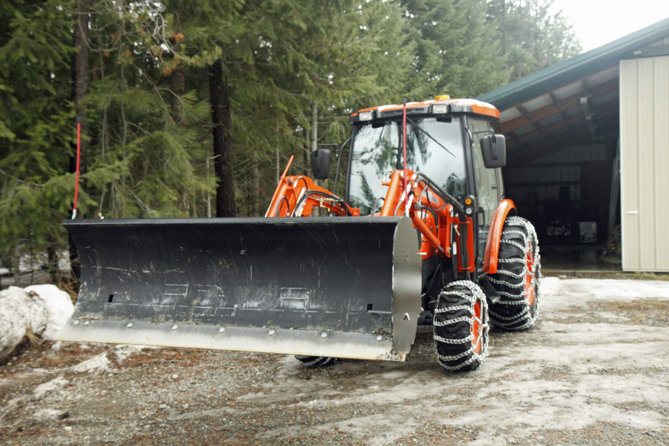

here are my chains now that the snow has melted off of them. There 2 link ladder chains. all 3/8" chain . man their heavy
Yeah they look good! Not sure about adding chains to my front tires? I don't know of anyone who has done this on a 2520??
I tried plowing without the front chains on and if i tilted my blade to the side, the front of the tractor moved in the other direction. With the chains it tracks straight.
Yeah I can see hat happening very easy, now I just need someone to chime I with a 2520 that has added them on the front, clearance, etc.
