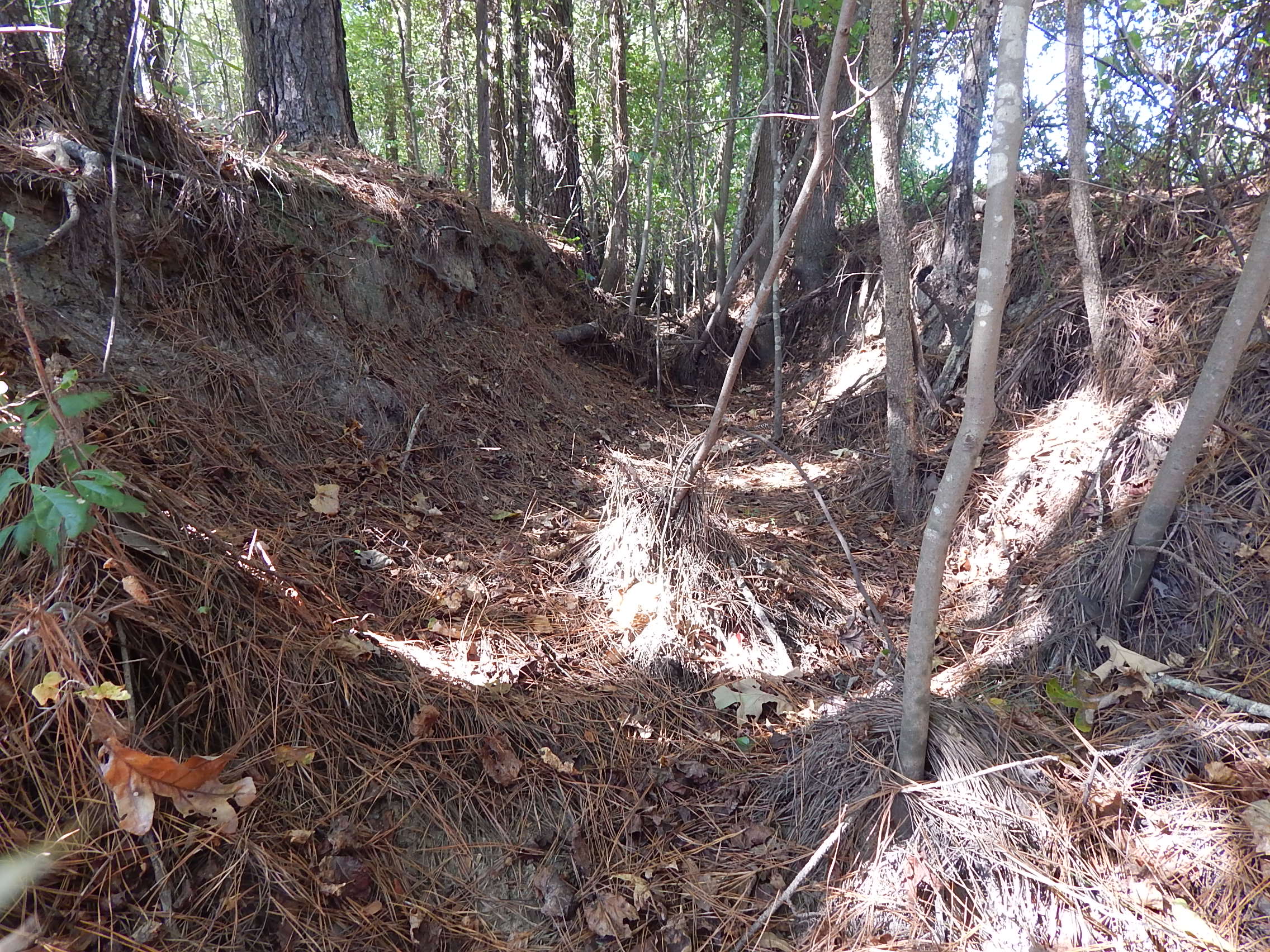

I think the culvert pipe makes the most sense. I don't have a backhoe; though boy what an excuse to go rent one of those little mini excavators. When we get one of our common three inch rains here, that ditch for sure runs water, but it has been dry here for over a week other than showers. The ditch bottom felt firm under my feet. The farmer's field ditch coming into it is much bigger, and has been dug deeper for sure, so there is a potentially large amount of water that could flow through here. The bridge would be a choke point so whatever I do it has to be a big pipe. And I know absolutely zero about culvert pipe, but I sure am going to learn.
It would be nice to have this be attractive as well as functional. For now I want to get to the other side and this winter go logging in the woods back there, clearing a path to that pond that is totally hidden in the middle of twelve acres.
If it does turn out nice back there, so folks might want to walk back there and sit by the pond, well, yeah, then I might like to have a pretty bridge to go over.

Is the ditch wet? From the pic it looks dry. I would dig the edges back some and put a road right thru the ditch. Next choice would be a culvert.
That's what I was thinking too. Dump some rock along the route for improved traction and to keep from sinking in when it's wet.

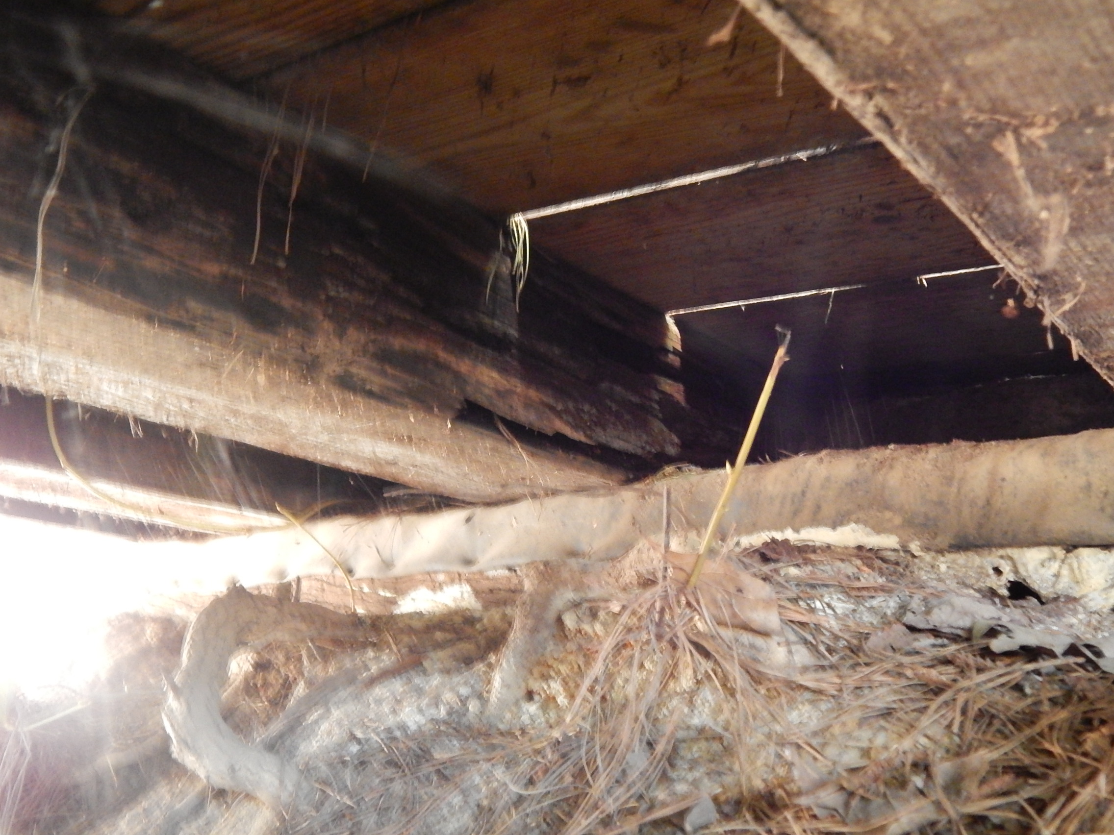

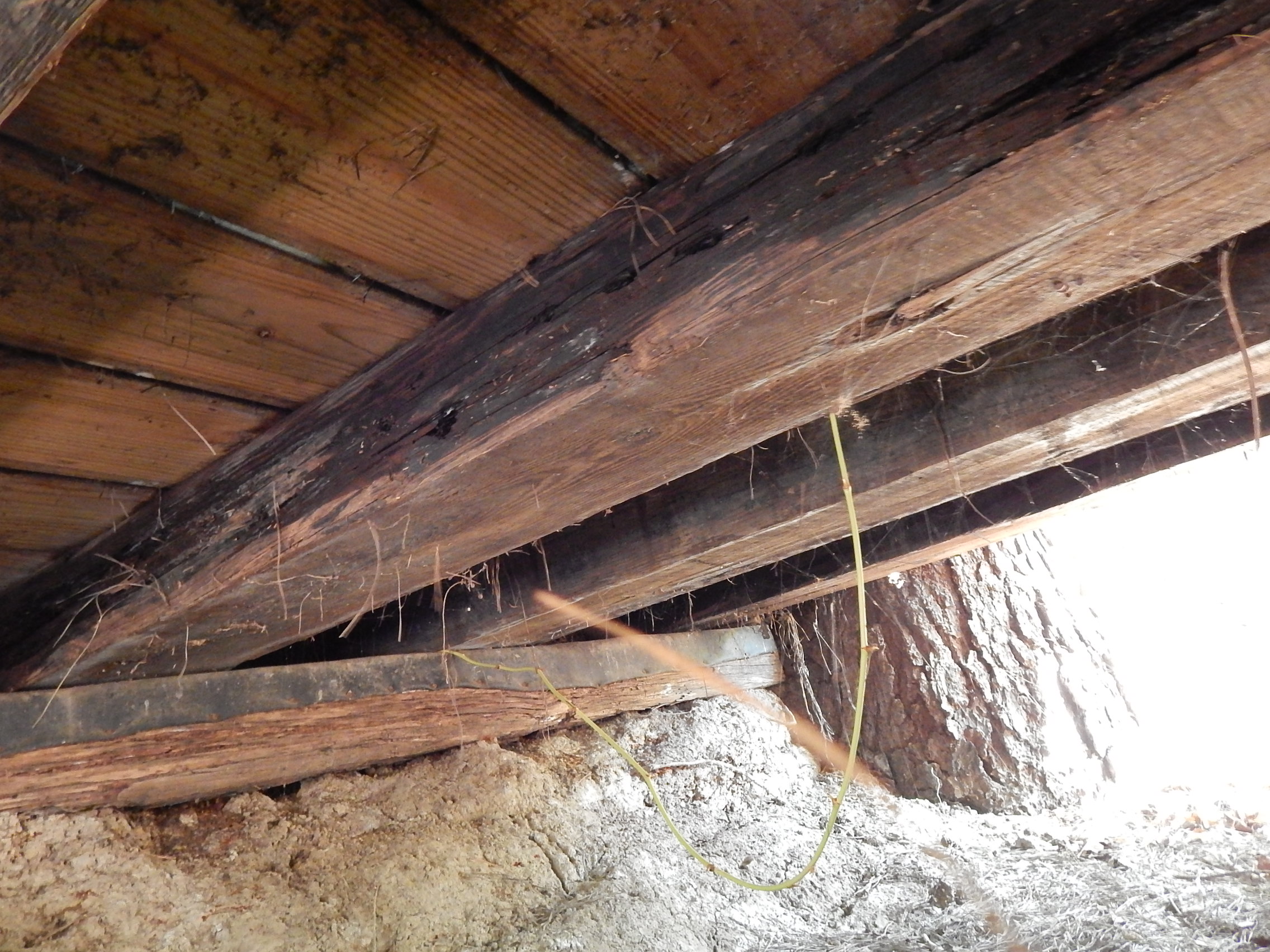

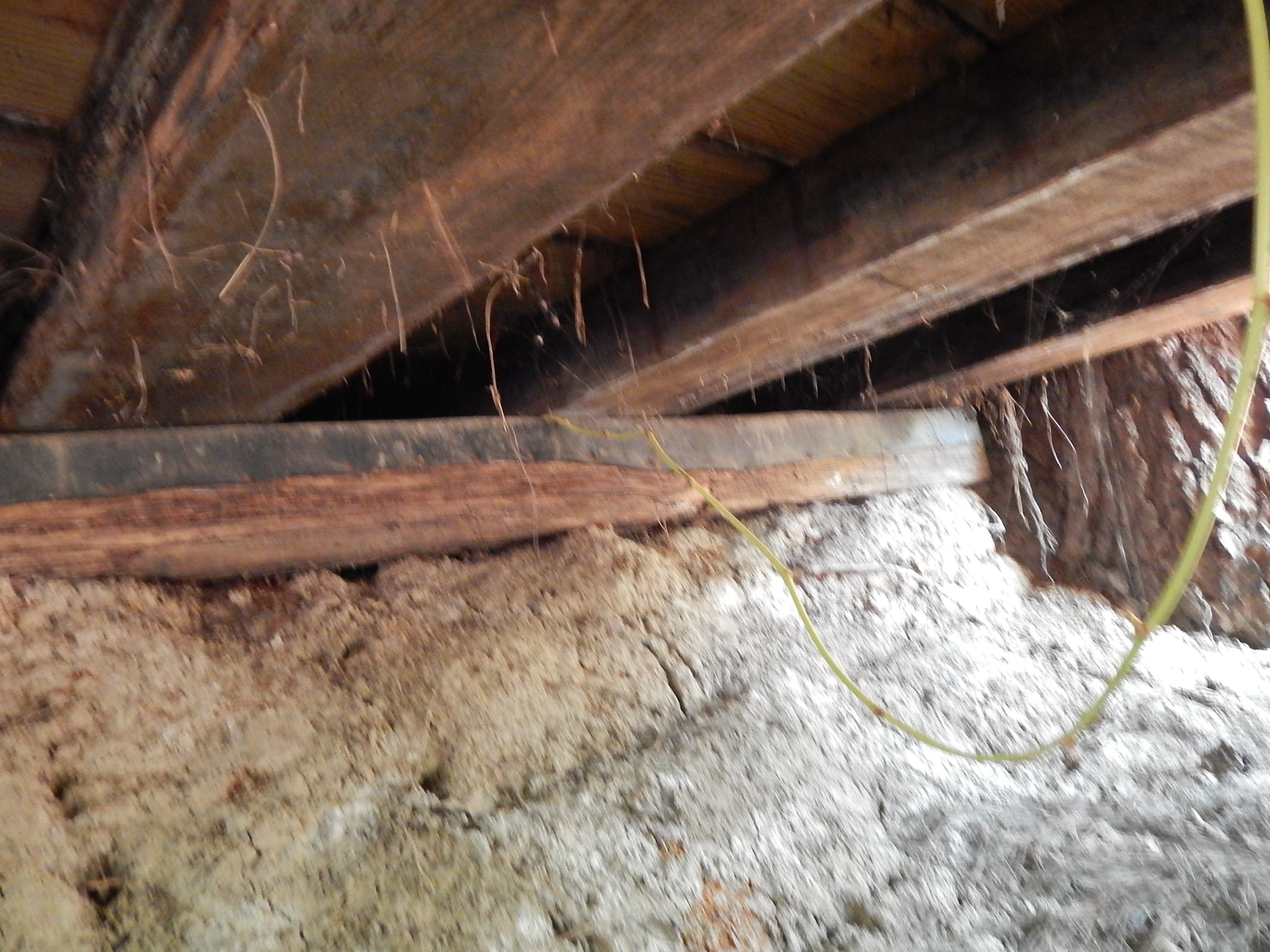

well I got motivated and just went out and this time crawled totally under the bridge.
Glad I did.
Good news and bad news.
Bad news is outside of several beams and cross footers definitely rotten, termites, who knows.
Good news is the beams under there are serious, almost a foot wide and at least six to eight inches thick. Big structural stuff, not anything at Lowes for sure. Screwdriver went in on the outside, but not on the inside.
But no question, lot of rot, but Mac, it might do it...
but that creek bed now looks a bit deeper.
So, this bridge was built for more than horses. But maybe not 57 of them...:rolleyes:

Those beams look like 12x12s to me. If they were intact, they'd handle the tractor just fine, provided the wheels were positioned over them. If the wheels are running on the boards but not over the beams, you might break through. And if the beams are Swiss cheese, then they could break just walking over them. 1 or 2 foot drop shouldn't be a problem if the bridge just breaks in two, just drive over it. However, if it powders or splinters under you that might be a problem if the drop is too great or the sides of the stream are too steep.

note in the second picture the right bank/side of the bridge had been repaired, probably when they put the new decking on, and they put lumber in there, almost looks wrapped in material like firehose. and look how badly rotted that big beam is there too...the part over the bank.
not 12x12 but I'm guessing 8x12. I would think four of them, in good condition, with proper planking, would carry quite a bit of weight.
next time I crawl under there I'll take a tape and do the measurements; i.e. how far apart the inner two beams are and if they might, by luck, line up. No matter what, with all that rot, unless I took core drillings of the things, would be hard for me to trust them.
I want to add to the "poking" info. On the sides of the beams, in some spots, went in an inch or two. In the center of the beam from the bottom, rock hard.

ok, back to reality. A twin tube culvert makes good sense, plug one, another at a lower level continues to flow.
No reason I could not dig this myself this winter, but I'd leave this little bridge alone then and just use it for the UTV and golf cart. Would probably do it on the right side of this bridge and actually, what really needs to be done is having some slavee hand dig the silt and muck out under this existing bridge, because it looks like the water would pool on the left side, water always going left to right.
   / How strong is my wooden bridge? #39
The twin culvers would be side by side. You want that water out of there ASAP. Two pipes side by side will drain way faster than one over the other. You don't want anything impeding the flow of the water.
