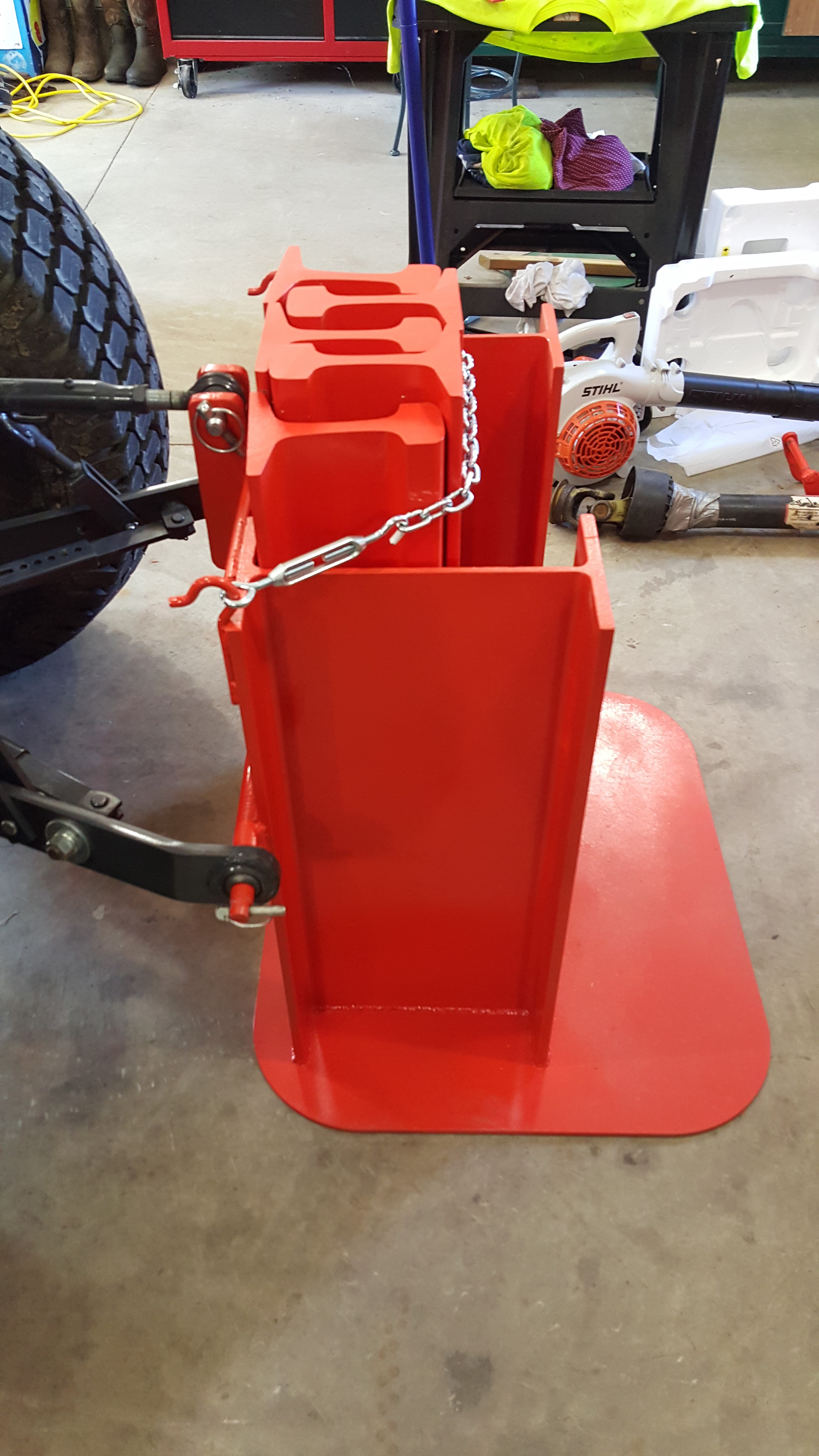

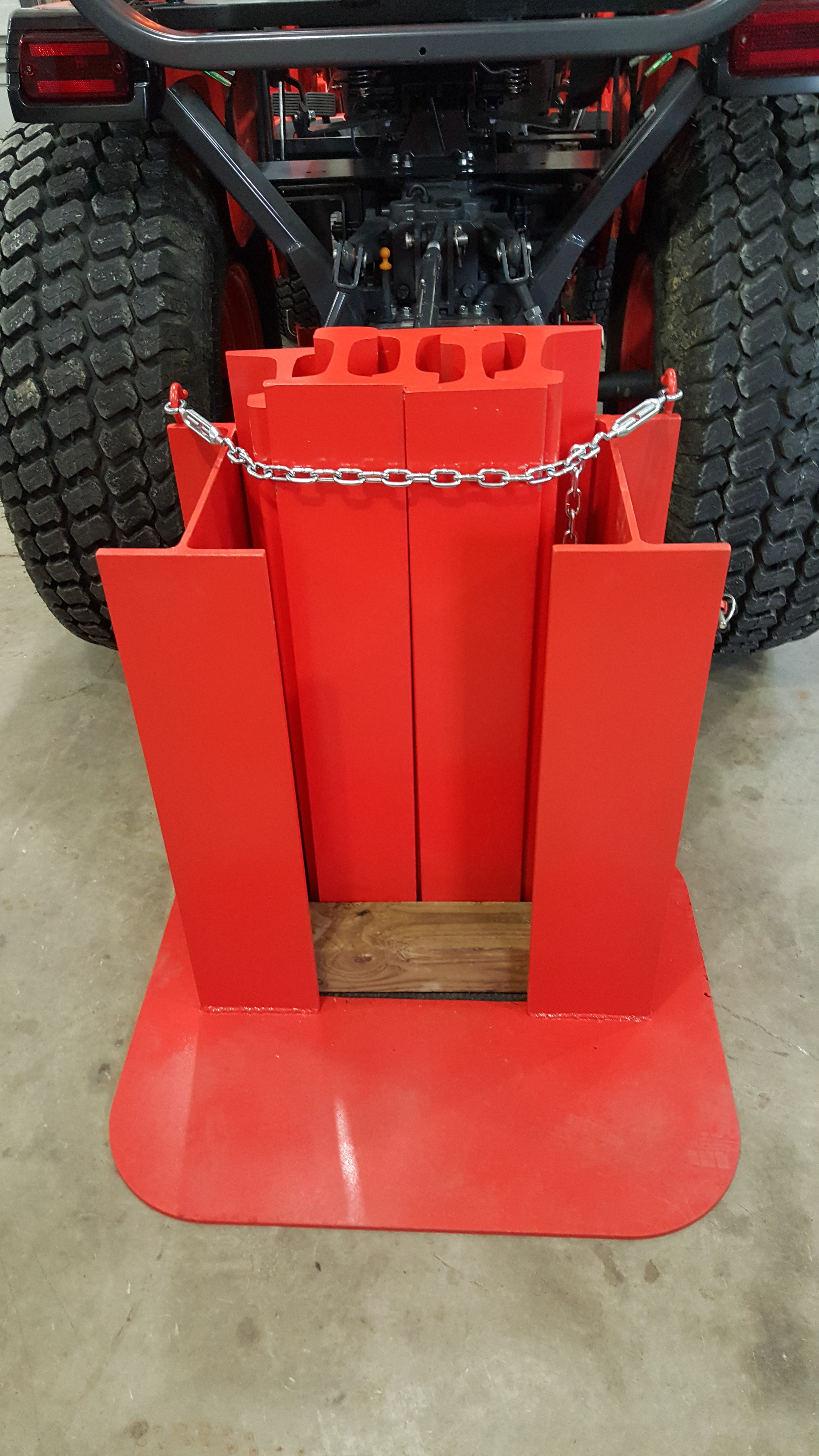

   / HOW MUCH WEIGHT #4
I did extensive research on this when I built my ballast box. I kept adding weight till the machine stayed planted doing max loader work. I ended up with 750 lbs to keep it planted well even on uneven ground. Not saying you cant get away with a little less for lighter work. But that is what it takes to keep it planted nicely and be safe doing whatever.
   / HOW MUCH WEIGHT #5
I have a Titan ballast box filled with surplus gym weights, fire bricks and sand. It hangs about 3" further back off the tractor as I have a Pat's on the arms. I'm not sure how much it weighs, probably 400# to 500#. It's not enough for serious loader work. Rkidd's 750# sounds about right w/ weighted tires.

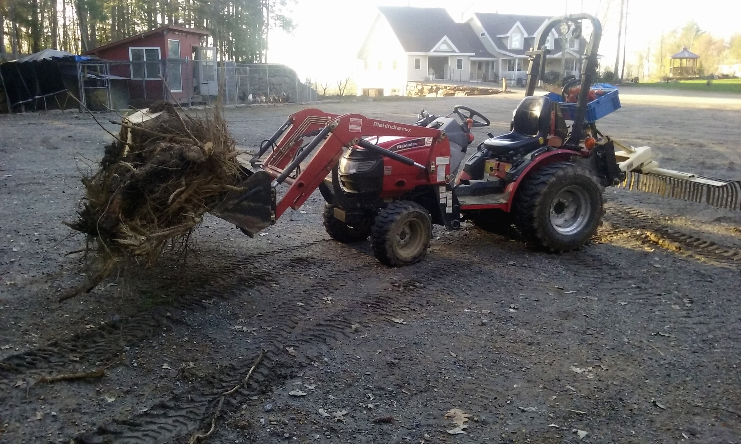

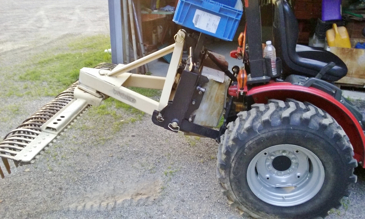

   / HOW MUCH WEIGHT #9
I have about #750 of permanent counter weight, not counting any attachments.
Note in the photo it would have been too dangerous to carry the stump any distance so I transferred it to a larger tractor.

   / HOW MUCH WEIGHT #10
