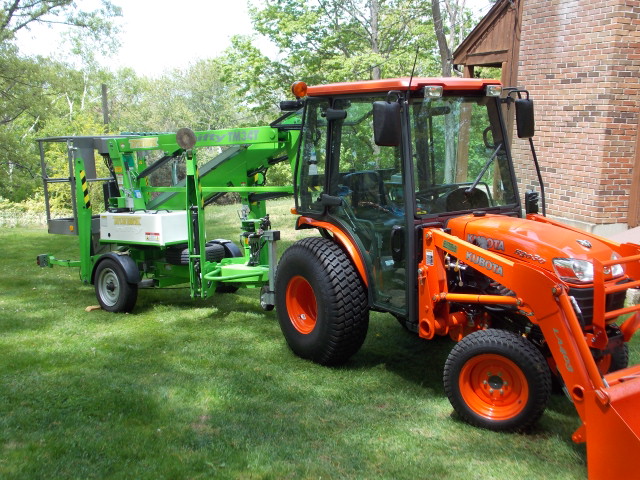

In my opinion, if you're towing on the level, you can pull a ton or a click over with no problem. I believe the manual recommends 1,500 lbs. Here is a shot of my B3030 towing a lift around the property that weighs in close to a ton.

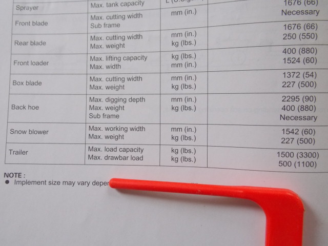

My B3200, which is the same tractor with a few less features, is rated to tow 3300lbs (1495kg) and handle 800lbs (362kg) of tongue weight. I'm sure yours is similar. That said, if it is tough going, i.e. steep, soft, slick, etc sometimes it may only tow half that much.

   / How much weight on B3030 tow bar? #6
I should of took this shot earlier. When all else fails, go to your bible--the owner's manual.

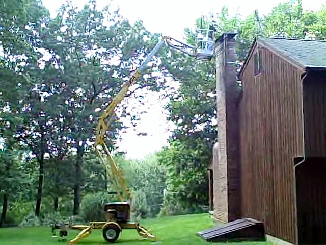

I don't know of any chat rooms for these lifts. The lift in the pic was rented by me to clean my chimney. I have a very difficult chimney and prefer to clean my flue pipe from the top down, keeping the wood insert door locked and all the cresote inside. Here's a shot of me on another lift, cleaning the chimney.
