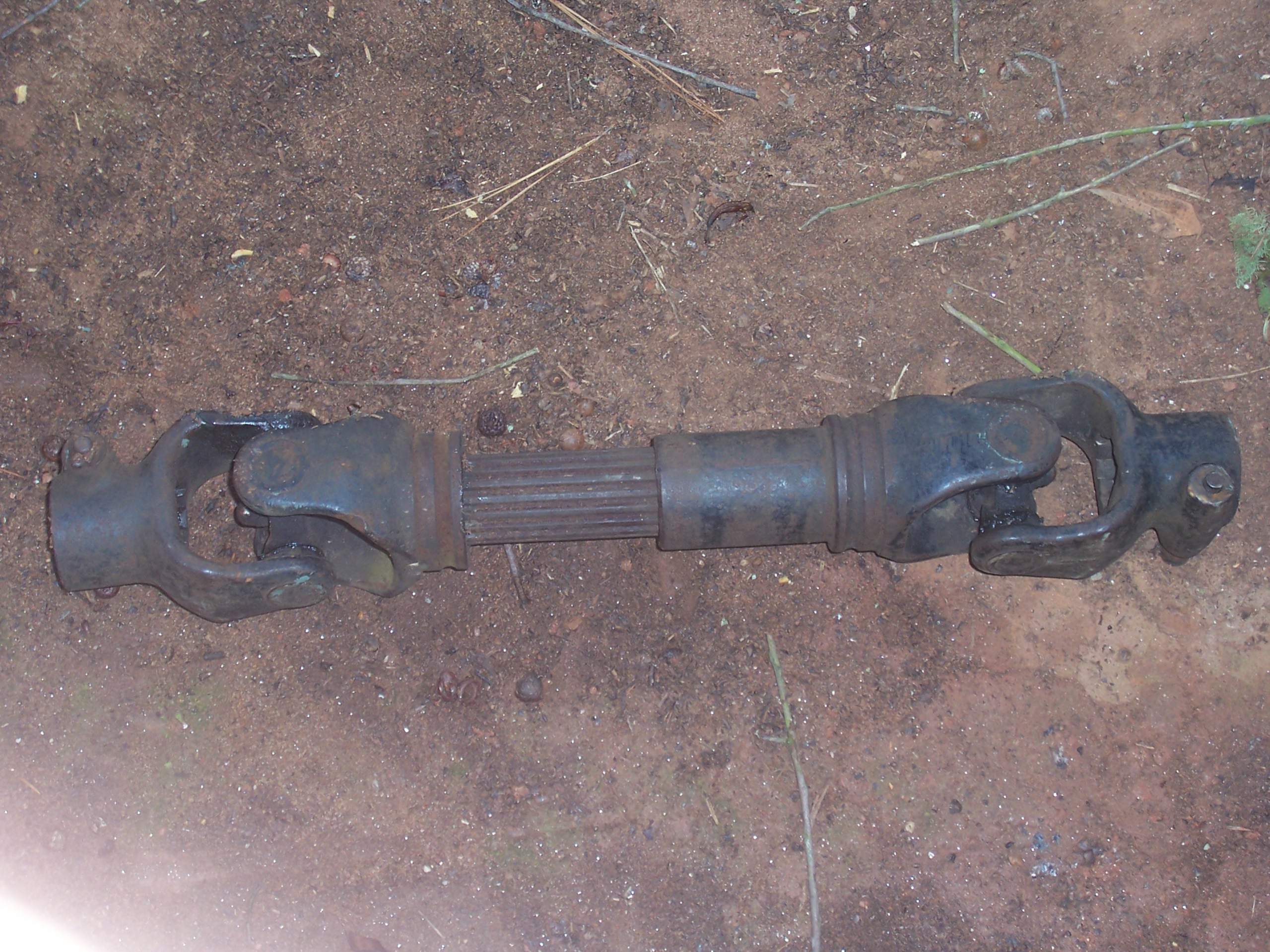

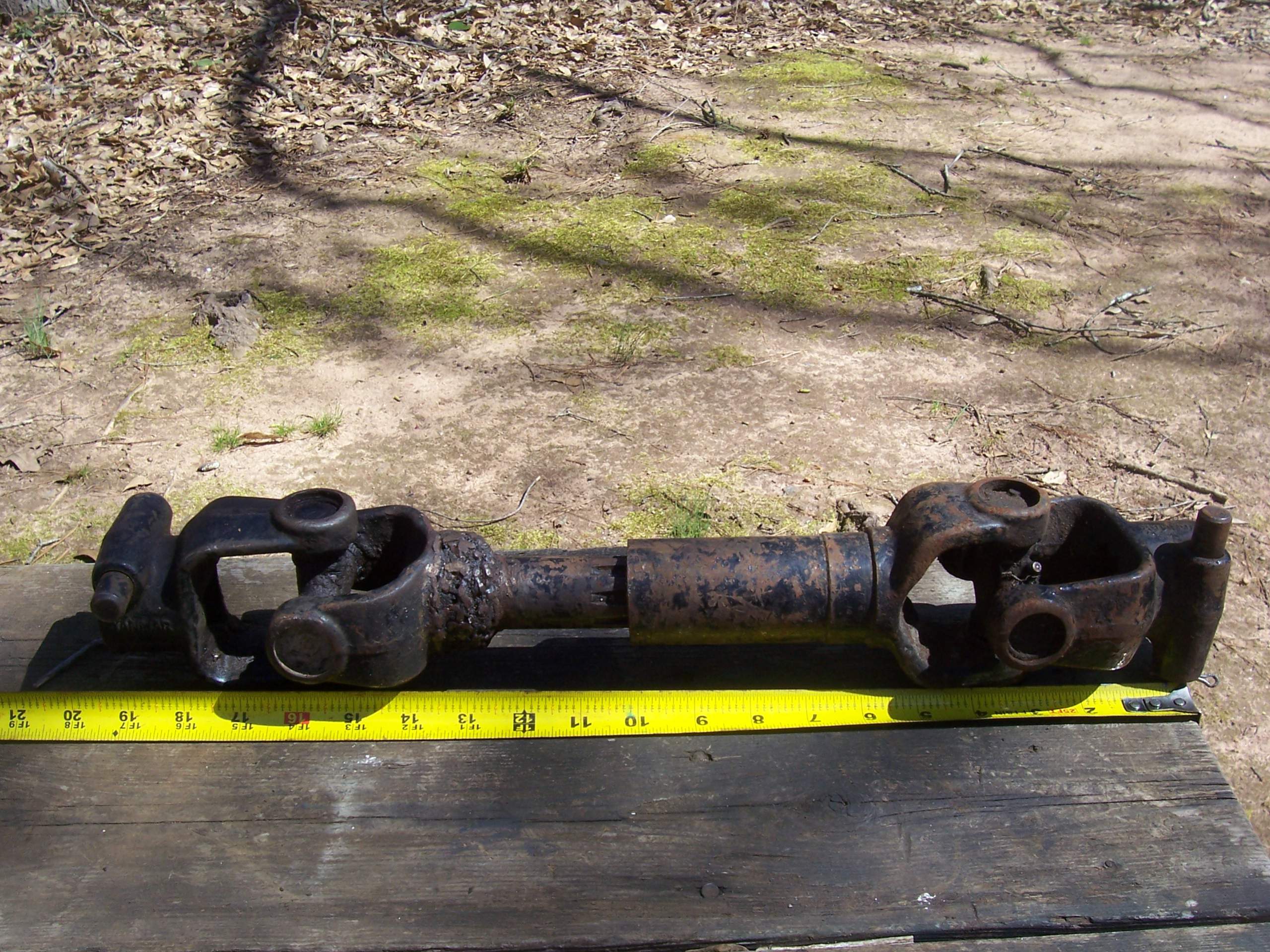

RS-1400 5'. Here's the top link which there's not much to it. Used with a YM2000. I gave this pic. to another member Yrs. ago and never heard anything since. Not much to it. You can ghetto rig it but this is how Yanmar set it up. The Tiller will move out away from the wheels when lifting it and then forwards keeping it close to the Wheels when in use. I do have A PTO. Dr. shaft I had to shorten until Fredricks sent the correct one. Works fine just needs new bearings Which NAPA auto should have them I'm sure. I don't have anything in the shaft and still in my parts box. Welcome to it. Last Tiller they had so Spalding recomended I needed to go get it. A few other things so it was well worth the Drive. Easy to get to from my place in Ga..

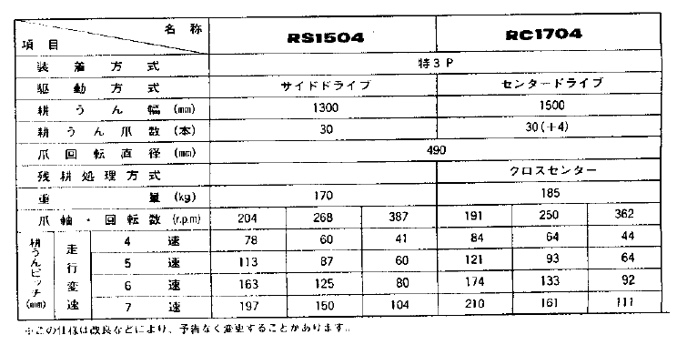

Again, your YM2310 allows these 2 tillers as 100% compatible for the tractor hook ups.
Right from the YM2310 manual on page-5.
1st line, models that fit to the YM2310
2nd line, 3PT hookup to the machine
4th line,
1300mm = (1300/25.4)/12 = 4.25FT wide tiller
1500mm = (1500/25.4)/12 = 5FT wide tiller
The 9th line and down are the tiller PTO speeds. Notice nothing is at 540rpms. Yet, people getting them over here run them like that ! :unsure:
So, each crop use, the tine arrangement and the soil are charted for the proper PTO speed. I've translated a few of these into Polish and Russian because 90% of these tiller end up over there. We've had some great discussions just about that section alone. A tiller that would seem simple is really sophisticated.
Starting on page-90 is the entire manual for the RC1704 tiller. So, if you downloaded the YM2310 manual, you got these 2 tillers to compare to your actual one. ;)
