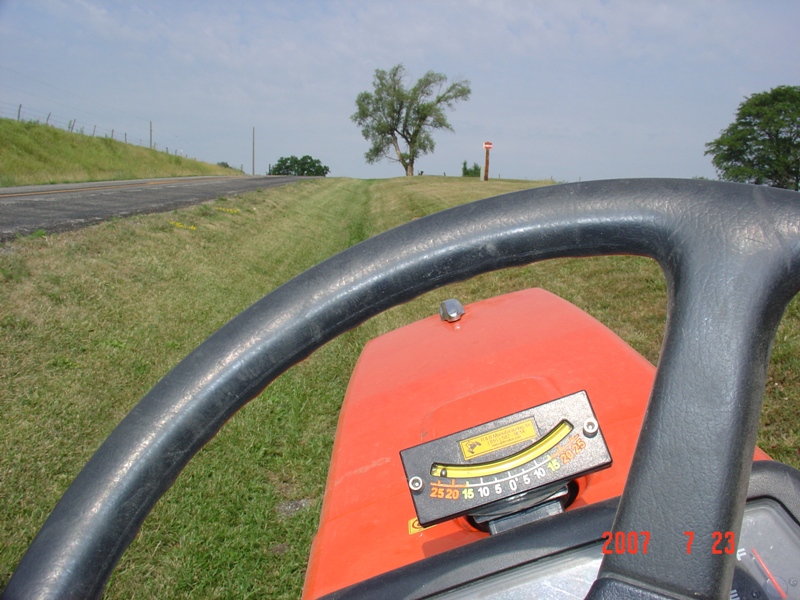

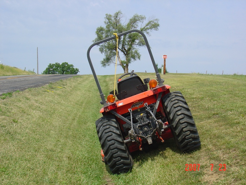

I was Deployed late 2005 thru late 2006. My wife was left with the task of mowing. She was very concerned about tipping the tractor. I bought a cheap tilt meter and installed it on our Kubota B2910. Told her to use the gauge to get accustomed to the tractor and it's abilities. Told her to never exceed 15 degree side slope. The tractor was amazingly stable at that angle so figured I gave her enough cushion that she wouldn't have problems and she didn't.
Here are some pics I took of that tractor using a rope hanging off the ROPS to show actual tilt of the tractor as well as the gauge. I posted these pics on TBN nine years ago as an example in a thread similar to this. I think any tractor will function at 15 degrees. Obviously I'm wayyyy past that in these pics. :)
Maybe purchase a tilt meter and do some experimenting on your own to find your "safe" place.
Old post I know, but WOW!!! I have a B2650 cab model, loaded tires and 1 5/8" (~56.9" total width) wheel spacers. When I'm at 15-16 degrees I get nervous. I did get out at that angle once just to see if there was a chance for me to rock the tractor to lift the wheels off the ground, but not a chance. But my pucker factor says to stop at that angle and drive slow even though I know the terrain. I'm not sure how much the cab (500 pounds) would raise my center of gravity, but if your inclinometer is correct, I think I would have gone past "pucker factor" to "implode factor". :laughing::p
