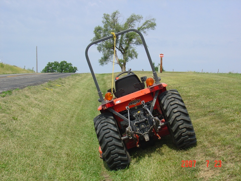

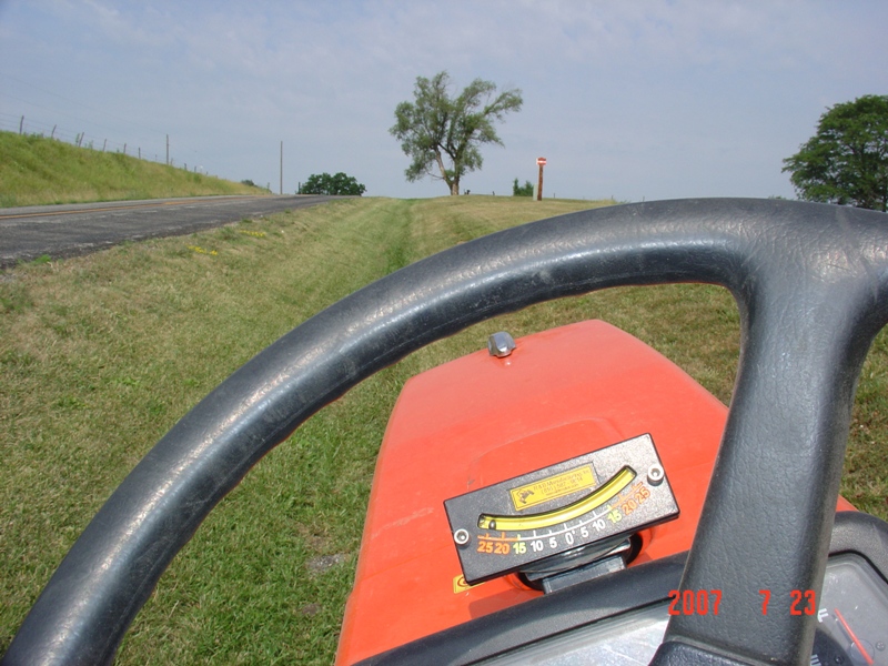

I was Deployed late 2005 thru late 2006. My wife was left with the task of mowing. She was very concerned about tipping the tractor. I bought a cheap tilt meter and installed it on our Kubota B2910. Told her to use the gauge to get accustomed to the tractor and it's abilities. Told her to never exceed 15 degree side slope. The tractor was amazingly stable at that angle so figured I gave her enough cushion that she wouldn't have problems and she didn't.
Here are some pics I took of that tractor using a rope hanging off the ROPS to show actual tilt of the tractor as well as the gauge. I posted these pics on TBN nine years ago as an example in a thread similar to this. I think any tractor will function at 15 degrees. Obviously I'm wayyyy past that in these pics. :)
Maybe purchase a tilt meter and do some experimenting on your own to find your "safe" place.

Yep. A friend of mine who is much smarter mathematically than I used that picture to draw in what you are saying. He assured me the tractor was not close to tipping. It didn't feel tippy at all. I've mowed that bank hundreds of times with various tractors. The B2910 had loaded rears.
My comment concerning wide front axle versus tricycle. The wide front axle only helps prevent tipping when the tractor has oscillated on the front axle pivot to the point that it hits the bump stop. By then you will have already messed yourself.
I've had my Kubota in that situation several times using the FEL with Grapple. One rear tire is a LONG WAYS off the ground by the time the oscillator hits it's stop point. Far enough that if you are headed downhill at the same time the rear tractor weight starts leveraging you over just as you explained about the COG in your comments above...... :eek:
