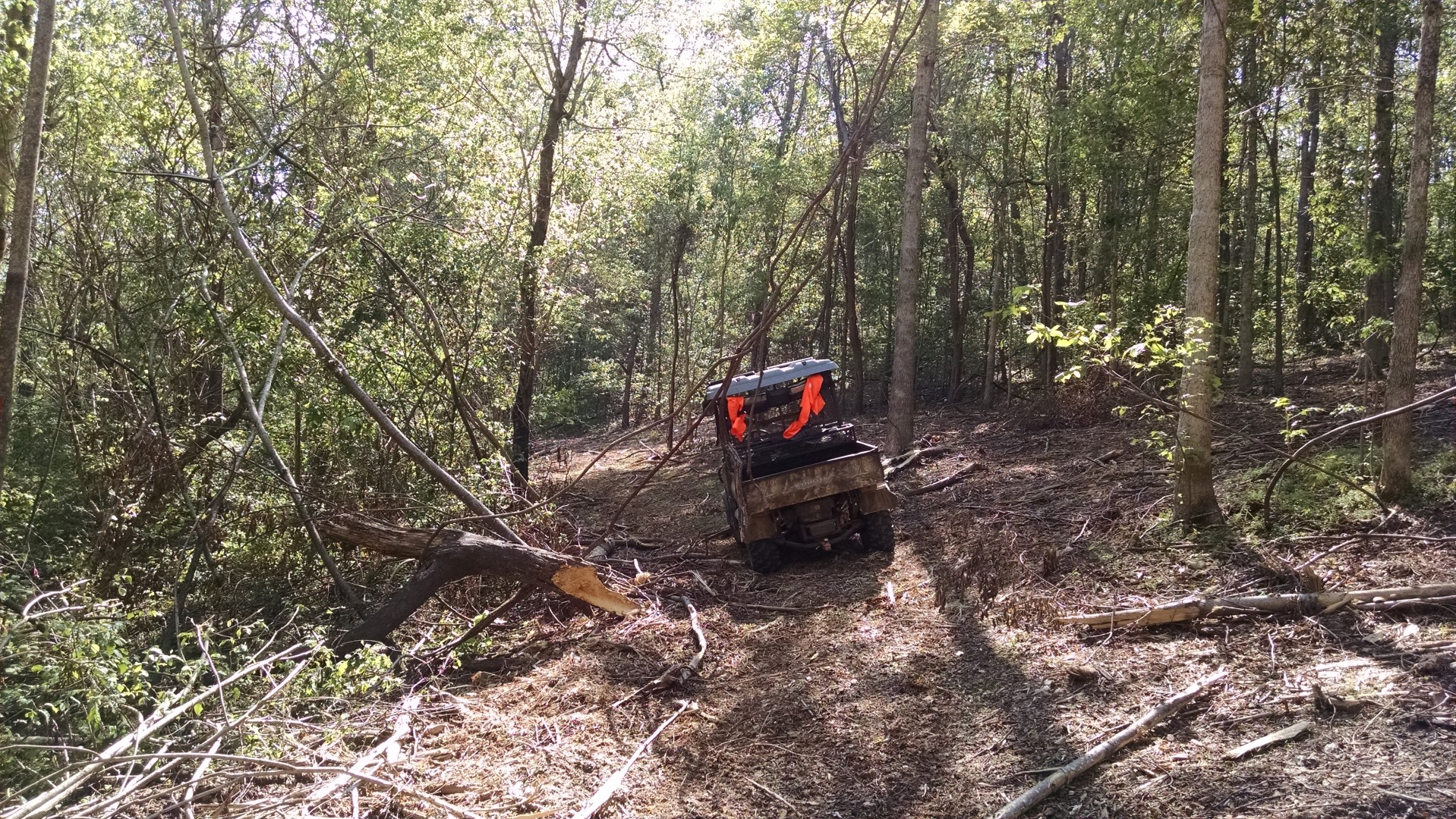

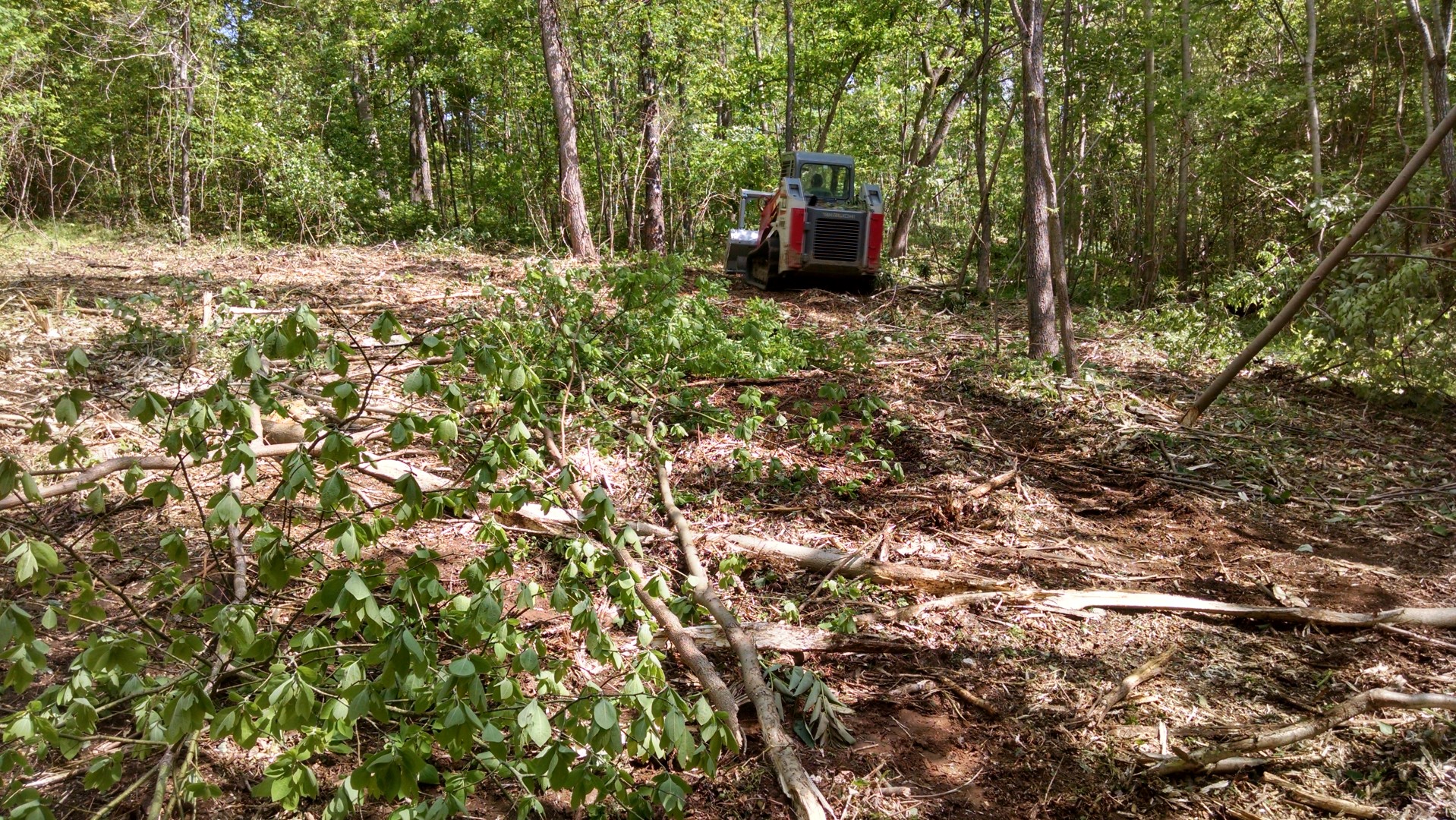

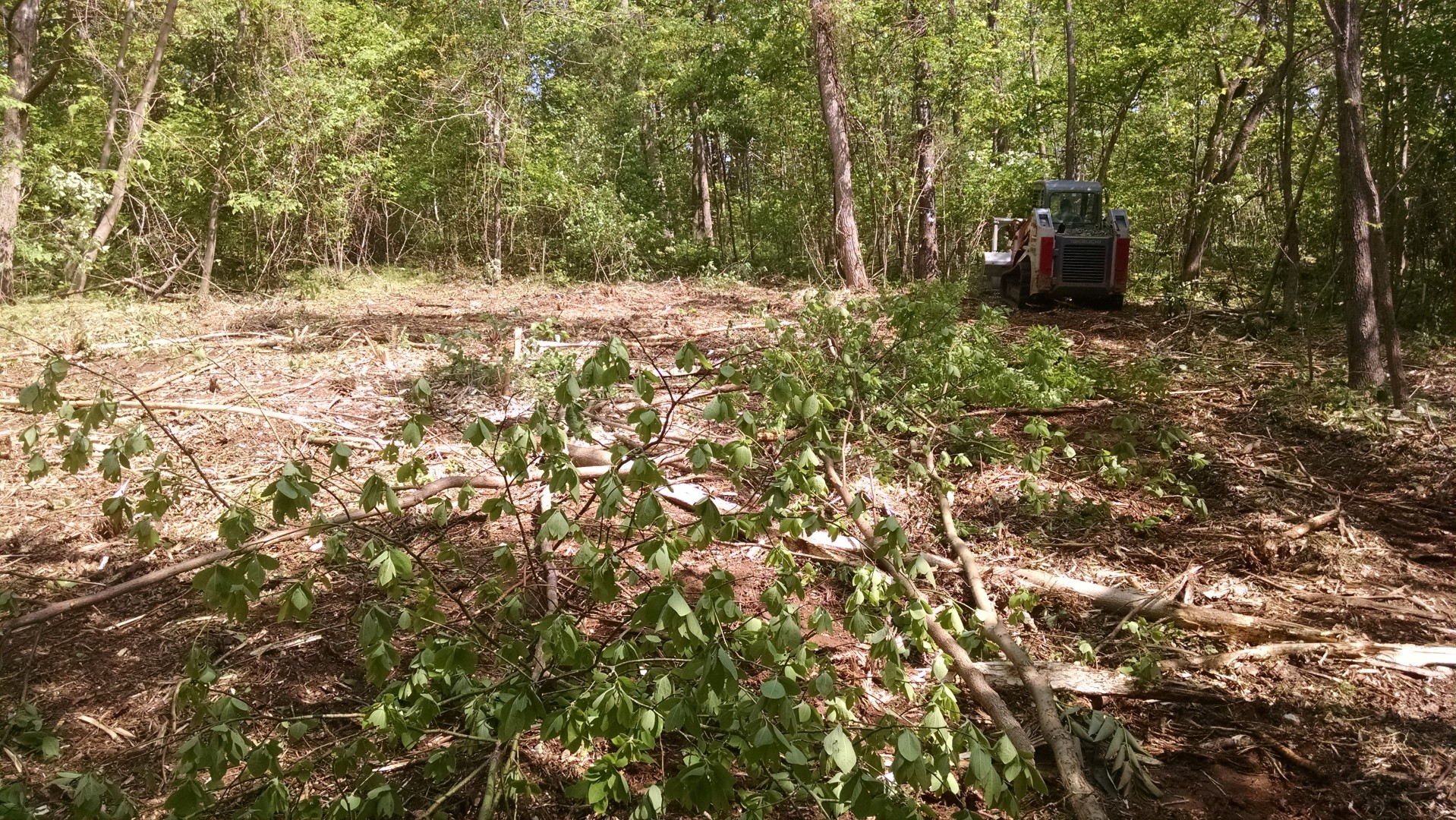

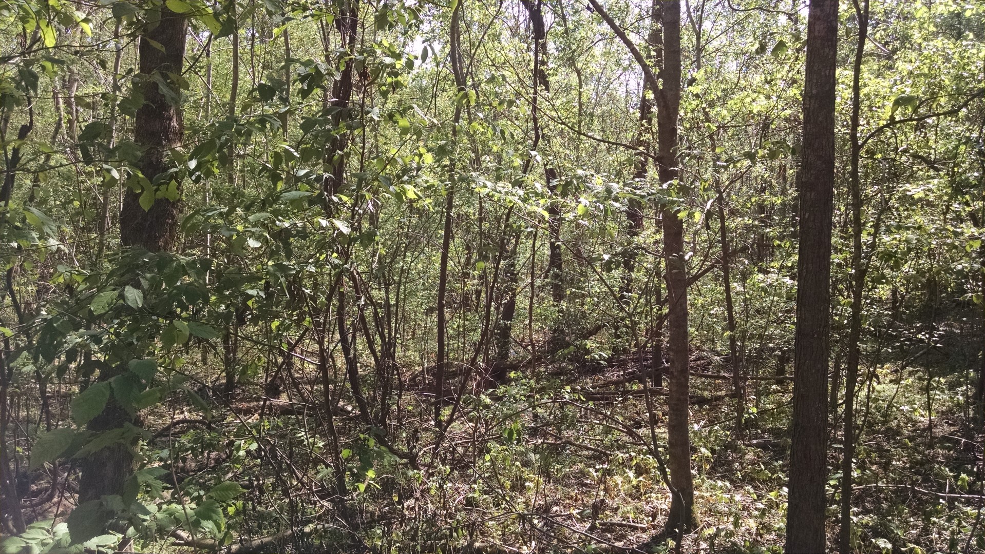

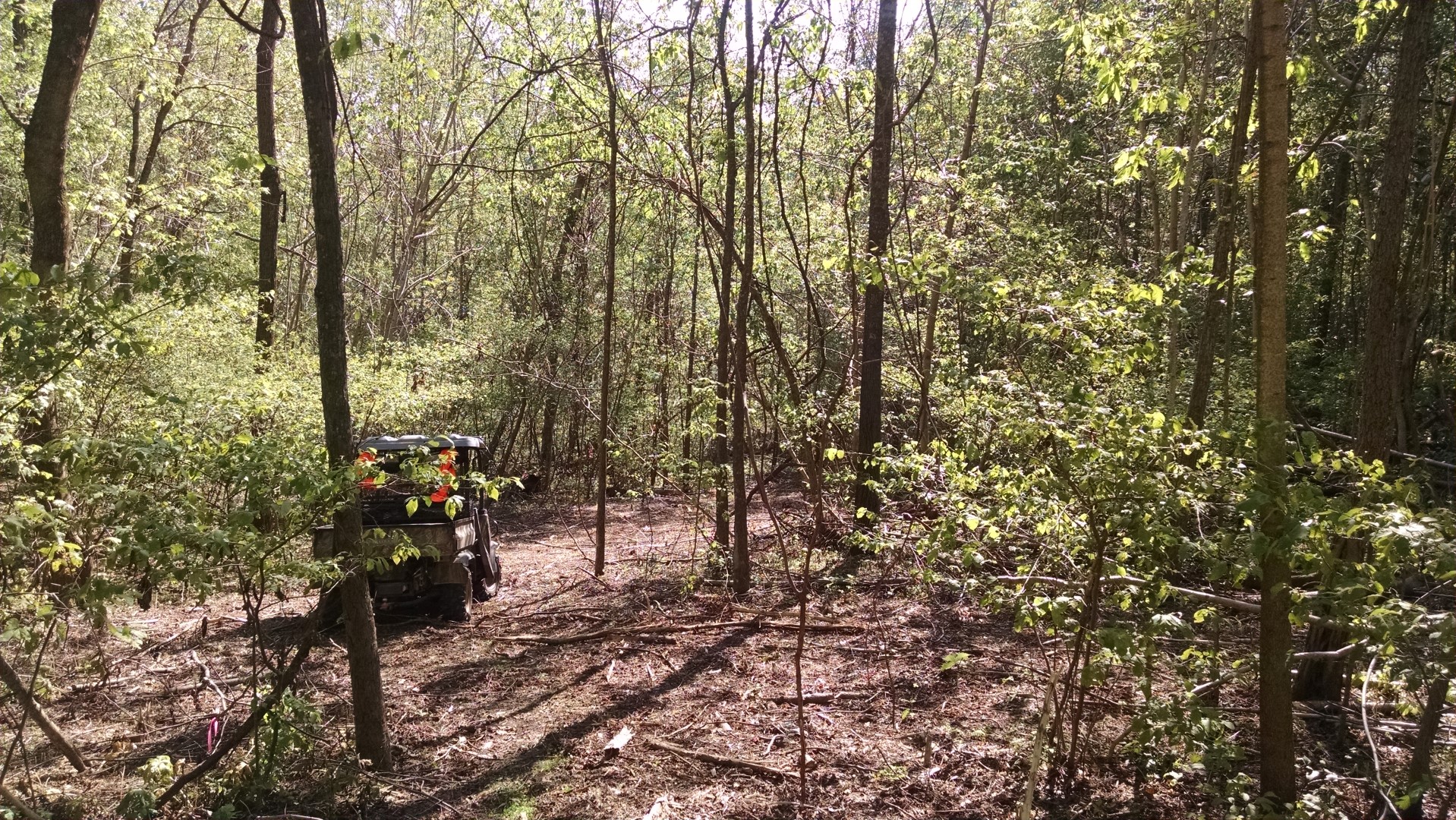

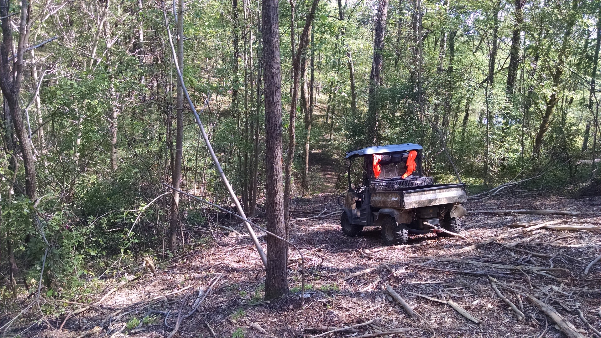

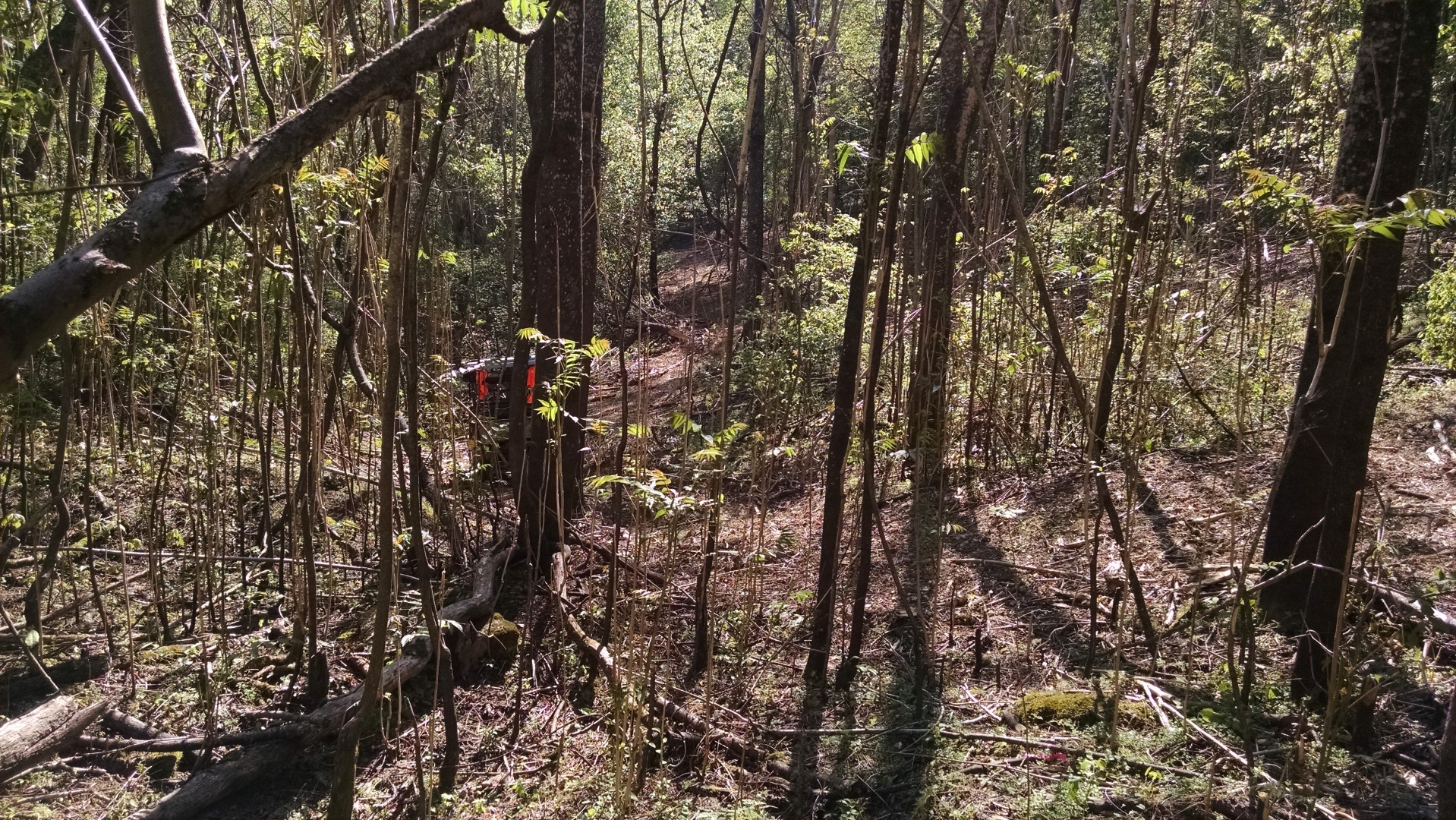

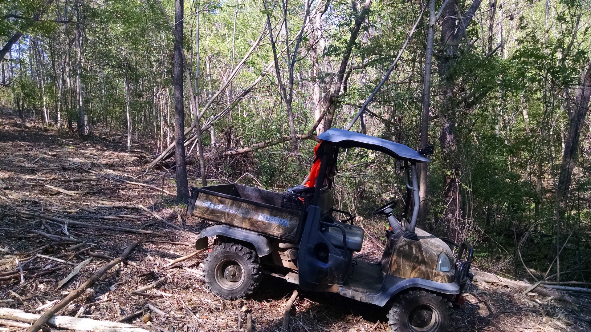

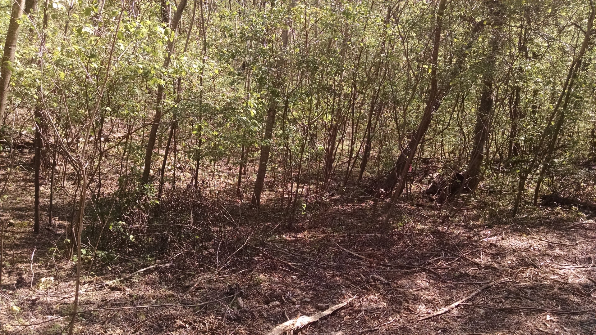

Anyone wanna see pics? We like pics right?? Right?
Here you go, but there's gonna be a pop quiz at the end, so pay attention!!!!
IMG_20170421_101548363_HDR (Large).jpg IMG_20170421_101552207 (Large).jpg IMG_20170509_160506354 (Large).jpg IMG_20170509_160559636 (Large).jpg
IMG_20170509_160707015 (Large).jpg IMG_20170509_160906604 (Large).jpg IMG_20170509_161112370 (Large).jpg IMG_20170509_161331433 (Large).jpg
Alright Hotshot, Pop Quiz:
How many trees in those pics were NOT Tree of Heaven?
Any guesses?

I have 10-15 acres of overgrown timber/woodland on my property that is pretty useless due to all the brush and especially the invasive Tree of Heaven. I'd like to have the underbrush cleared and I'm thinking of having it down with one of those brush grinder machine services, see picture below.
The questions I have are:
- About how much does one these cost on per day basis; this is a service, not a rental.
- About much land would one of these machine process in one days work?
Obviously, until I can get the guy out here for an informed quote I won't get an exact answer. Right now, I'm just looking for the "best guess" type answers.

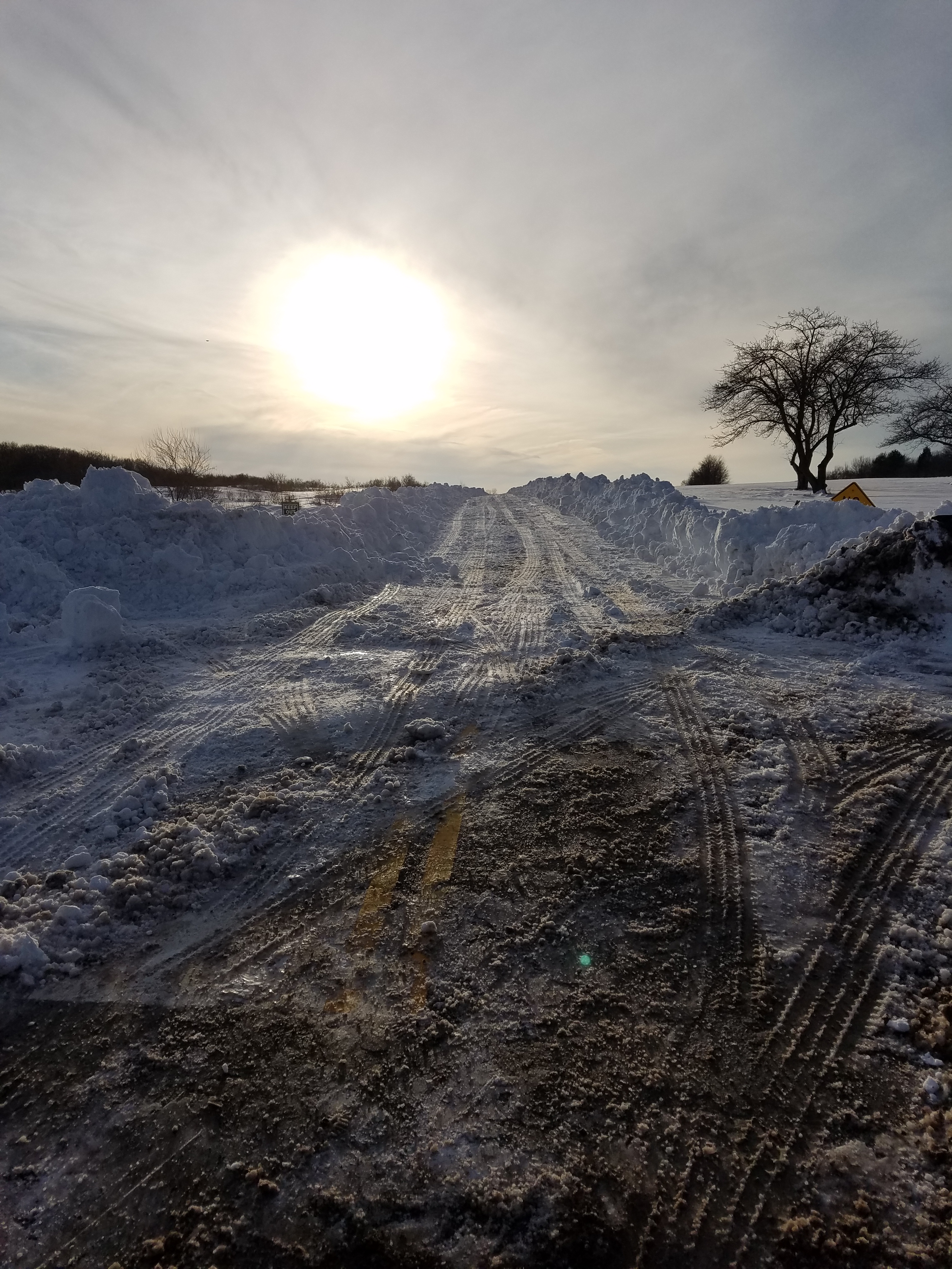

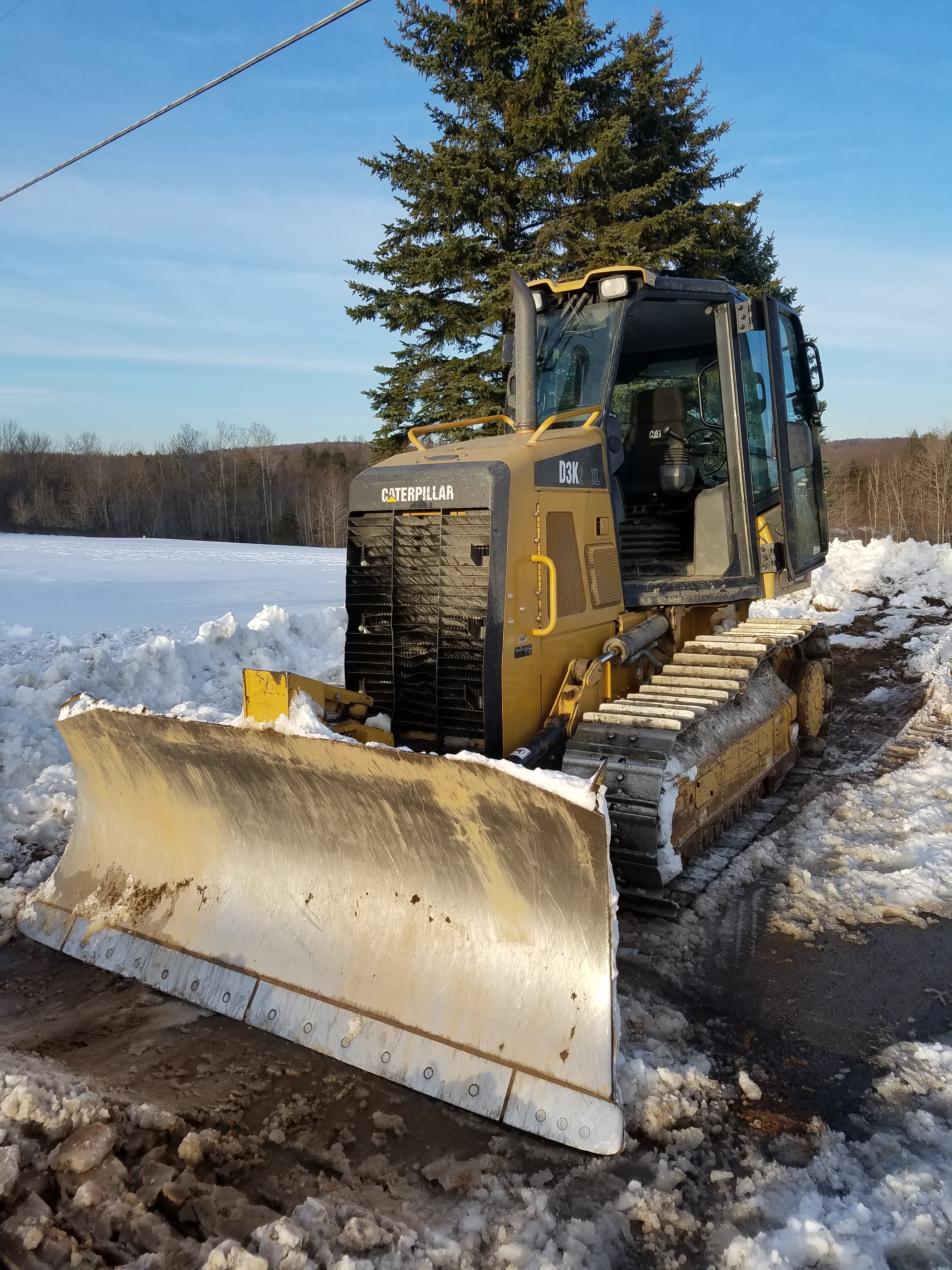

i rented a d3 dozer for snow removal on a farm this winter (drifts were 6 feet high), it was 84 horse and used 18.2 gallons of diesel in 7.8 hours. i had never driven one before, other then tearing up some lawns it went fine.
on a side note i was told the machine was covered for damage, i specifically asked maybe it depends on who you rent it from. 375 a day no fuel, 120 each way to pick it up
i also asked what happens if i get stuck, they said keep the blade on the ground and it won't. they said i could hire a tow truck (semi sized) or they would come with another dozer and pull it out with that one at the cost of a full day 375 +240. to be honest for renting my first piece of large equipment it went unbelievably smooth. we were getting quotes of 350 hour to clear the road. and it took me and a 2500 dodge plow truck 7.8, we saved a ton of money and i had a grin on my face the entire day.
