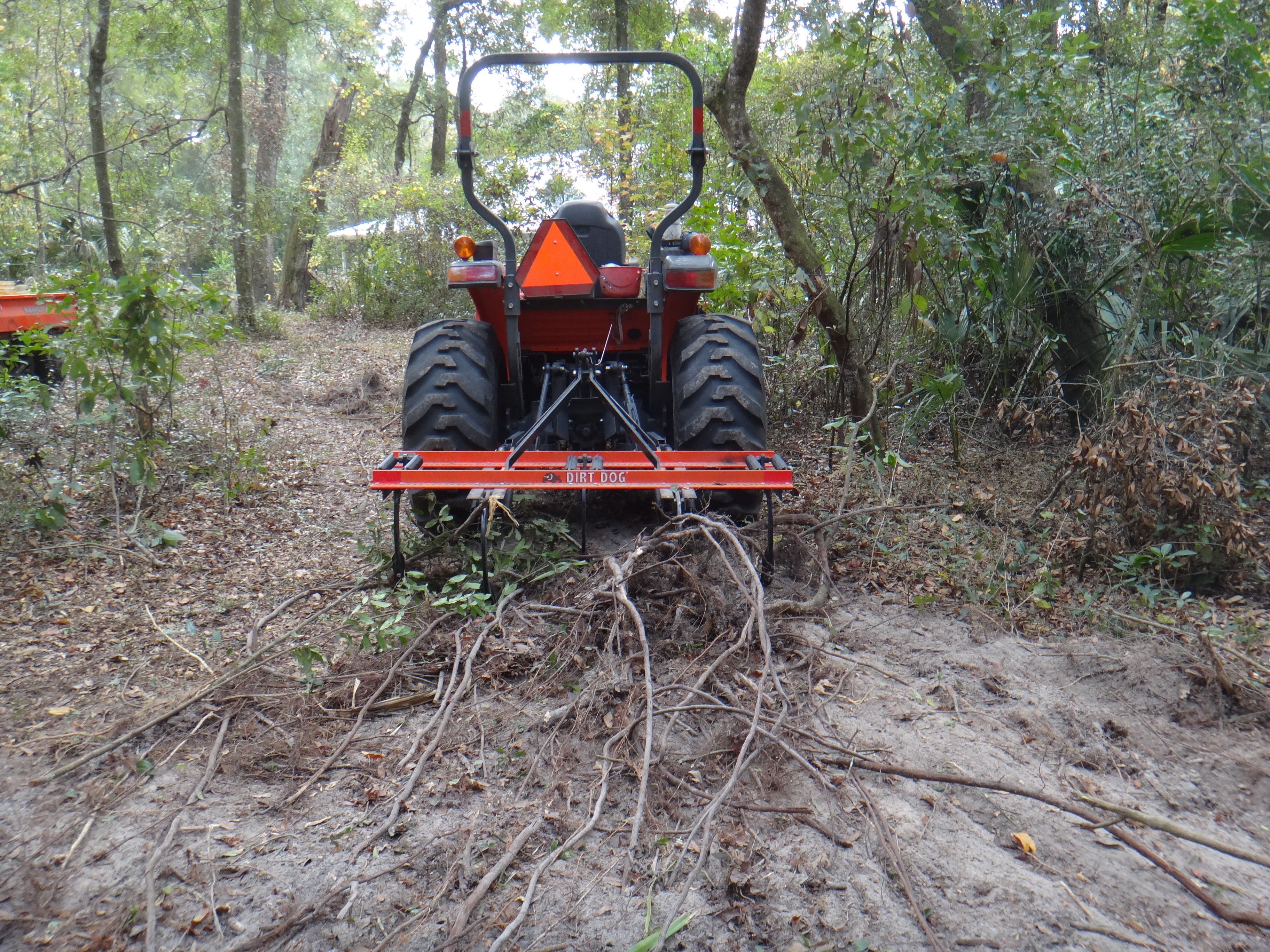

If you are going to peck at it with the L4330 get a Ratchet Rake for your FEL bucket and a Field Cultivator for your Three Point Hitch. More than half the de-brushing struggle is transporting detritus to a safe area for burning. Field Cultivator works very well dragging vines and brush while leaving dirt behind.
ratchet rake brush clearing - YouTube
http://www.tractorbynet.com/forums/...ement-vine-root-removal-woods.html?highlight=
Your photo depicts "before" land very similar to mine in Florida ~~~~but I do not have Tree of Heaven, I have wild grape vines, wild climbing rose and Yaupon Holly.

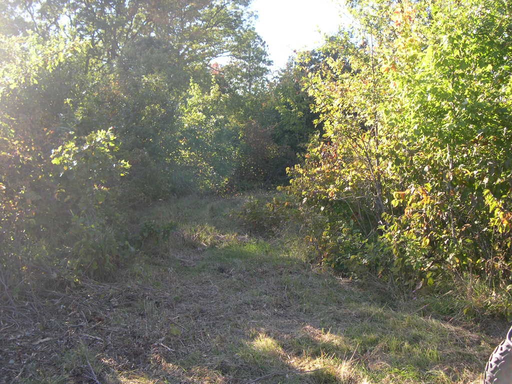

The power companies around here use ASV skidsteers with a similar cutter. They do a great job - it looks like a golg course when they're done.
If the cost is too great, you can do some damage with your own tractor and a rotary cutter. I cut trails through 8' tall hazelnut brush with a 15hp Shibaura and a 4' Kingkutter rotary cutter. Just walk the area first to look for surprises, and use a chainsaw for stems over 1 1/2".
