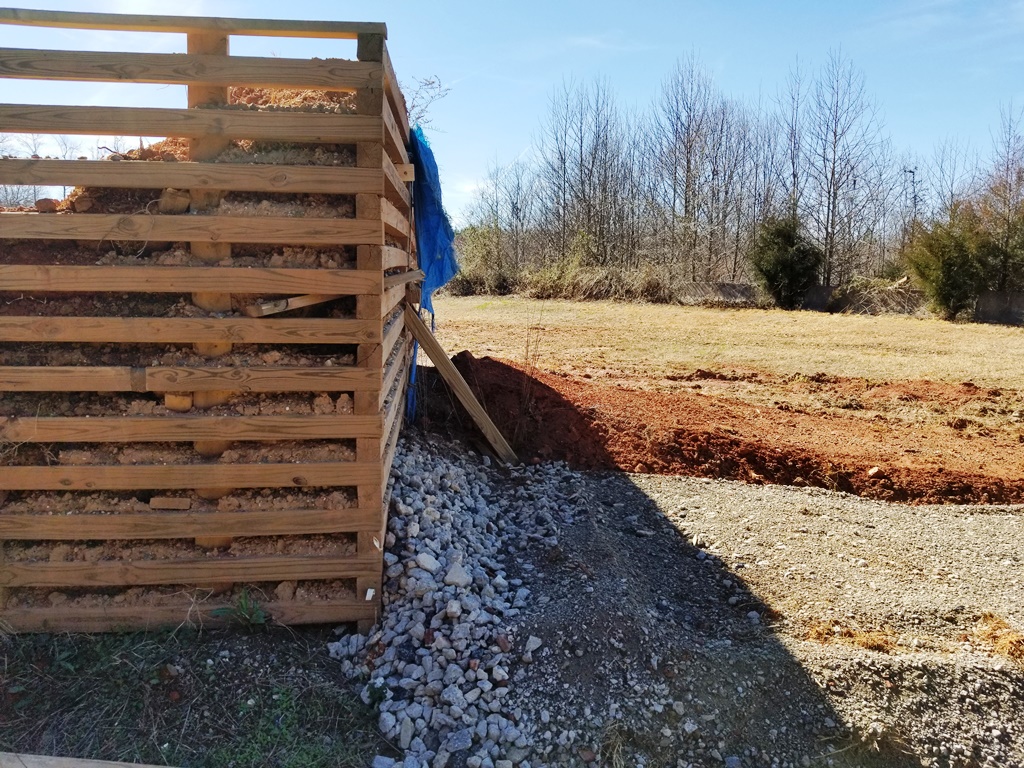

This is the back corner of my berm and shows how I constructed it. About 7.5'. That's my pistol one and that [ shaped construction let me pile the dirt pretty high without needing excessive amount to reach that height and still be moderately thick at top.
I did my rifle one the same way, but went a little taller since it's @ 300 yds. I used PT 2x4 instead of 4x4 for it. Worked well, just took longer to put together and required a lot more vertical support pieces. The sides are a little wavy since the 2x4 aren't as strong and it is wider overall, but still let me pile up dirt pretty high w/o need for excessive amount of dirt.
I have to bring in fill dirt ($$$) for projects like this since I can't dig it from my land. So the extra cost of the wood support structure is offset by bringing in ~1/4 the truckloads of dirt.
