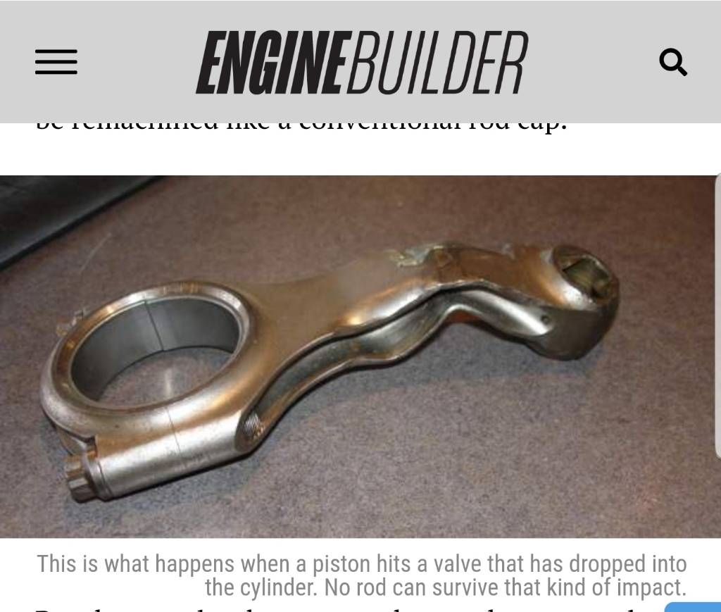

Nm does not pertain to thread objective

To talk about your original question..... Any rotating part in the engine could get unhappy. Not likely but, twist the Crank. Break a piston rod, any gear in the trani is stressed by the shock of sudden stop.
