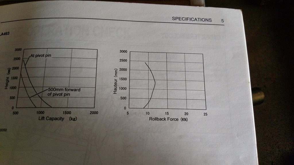

All this discussion makes me want to calculate all these forces for my tractor based on cylinder surface area, lever lengths, vector forces, and relief pressure... But that sounds like a lot of work.
If I remember when I am down at the shop today, I'll snap a picture of the curl power graph in my manual and post later today.

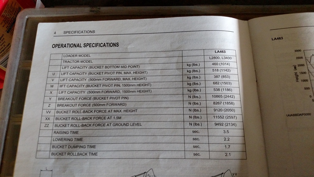

Here is the curl chart, and the specs.
1 KN is ~224lbs
bucket rollback force cannot be measured at the pins, thus I assume it is at the edge of the bucket. Max at almost 2600#, whereas my max lift (breakout) at the bucket edge (~500mm forward) is only 1858#
Another reason to think breakout is lift only....
Because if it was a combination of lift and curl, how/why would it be less than the rollback force? Max breakout if a combination of functions, would not be less than the curl force.
