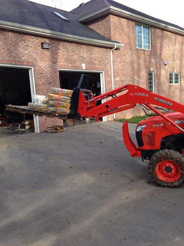

Here is 1,000 pounds of concrete plus the pallet on a la524 loader. That was as high as it could lift it. image-4209207717.jpg I also put the bucket from my LA724 loader on the LA 524 which is a good bit bigger than the LA524 bucket, and scooped a heaping load of wet dirt. It lifted it to about the same height.

If I had of curled it back I could have made a full height lift, but then the concrete would have fallen off.

And any grease that you had on the pins :laughing:
Don't forget the empty 3.5 gallon bucket and the super heavy duty 400 pound capacity ratchet strap.

Ever check your relief pressure. I could have thought you could have done better than that. I was able to lift 14 bags @ 75# each (1050#) to about that high to load in my truck bed with CLAMP ON forks with my LA463.
Just yesterday I unloaded beams off my trailer. W18x60# that were 25' long. So 1500# beam. Using clamp on forks, but getting it as close to the bucket edge as I could. I wasnt able to lift off the trailer deck. But was able to curl to clear. Once off the deck and on the ground, I could lift to within about 3" of my Deck-over GN.

We have never tested the relief pressure. It is my Grandpas tractor. I could have lifted more using the curl. I could have lifted more if I had curled it back farther, but this was a level lift. I did some dirt work using my LA724 bucket on the La524 loader. The factory LA724 bucket is a good bit bigger than the factory LA524 bucket. It could only lift a heaping scoop of wet dirt to about the same height as the concrete. The dirt was heavy enough to lift the back tire off the ground with loaded tires and a bush hog for ballast. My Grandpa is more than satisfied with the performance. He would be equally as pleased with a BX. The heaviest thing he needs to lift is a 55 gallon barrel of diesel. In fact he would be happier with a BX because he wouldn't have to ask someone to haul it for him.

Also 1,000 pounds wasn't the limit of the loader. 1,000 pounds was all the concrete I needed (actually 200 pounds too much). The loader could have lifted more just not as high.
