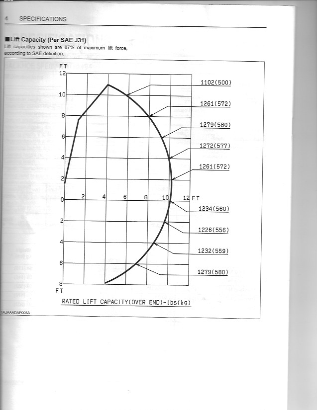

I ask bc it dawned on me and when i look up stats they seems to show digging force.
I’d like to know for my own knowledge to understand limitations.
but for a compact tractor, in this case it will be a Branson 3620h how much can a backhoe lift?
i wouldn’t want to be maxing it out ever, so it would be good to know roughly what a compact hoes lifting capacity actually is.

FWIW here is the chart for my BH, Model BT1000A. I presume the bold straight lines represent the boom and dipper stick at full extension so that the "lifting force" was measured at the bucket pins. I am sure there are other, arcane rules in SAE J31. Perhaps it specifies the BH is fixed so that weight in the FEL is not considered. I was somewhat surprised that the minimum was not at full horizontal reach. I have never moved test weights, but I have exceeded its capacity i.e. found immovable objects. (BTW a similar pictogram for the loader shows just over 1500kg (3307 lbs) at 500 mm forward of the pivot pin at 500 mm (18") high.)
