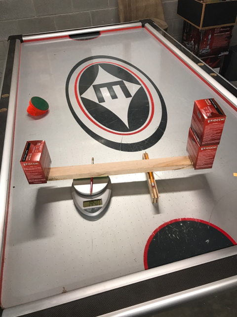

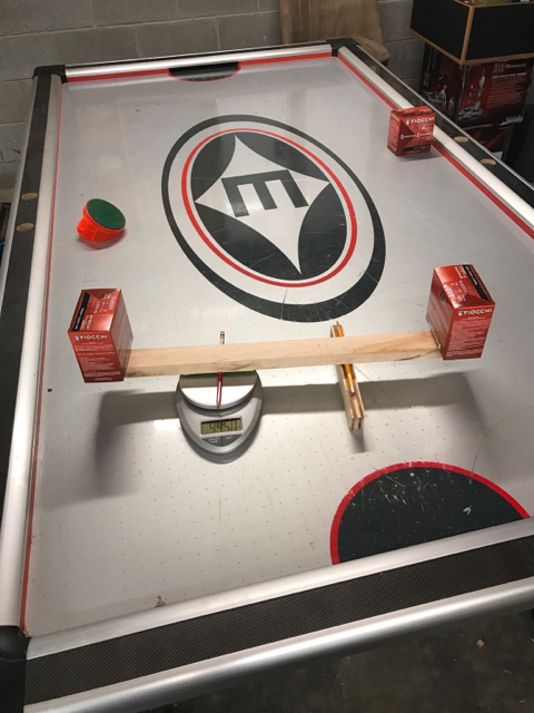

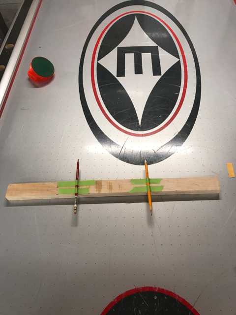

Here's another small scale experiment. I divided my 'tractor' into 3 equal parts. Although the proportions aren't representative of a real tractor it makes for easy physics. The wheel base is 8.3 inches and the end of both ends of the board is 8.3 inches from the closer axel. I weighed 3 boxes of shotgun shells and surprisingly they were exactly the same at 34.9 oz each. The weight of the front axel is 44.5 oz with a box on each end. The axel weight is 15.5 with 2 boxes on the back. IMG_9028.JPGIMG_9029.JPGIMG_9030.JPG
   / How much ballast is typically needed for a MX5800? #34
So adding a box at 35 oz on the back, unloaded the front by almost the same amount. Minus a little differences in measuring.
My point proven

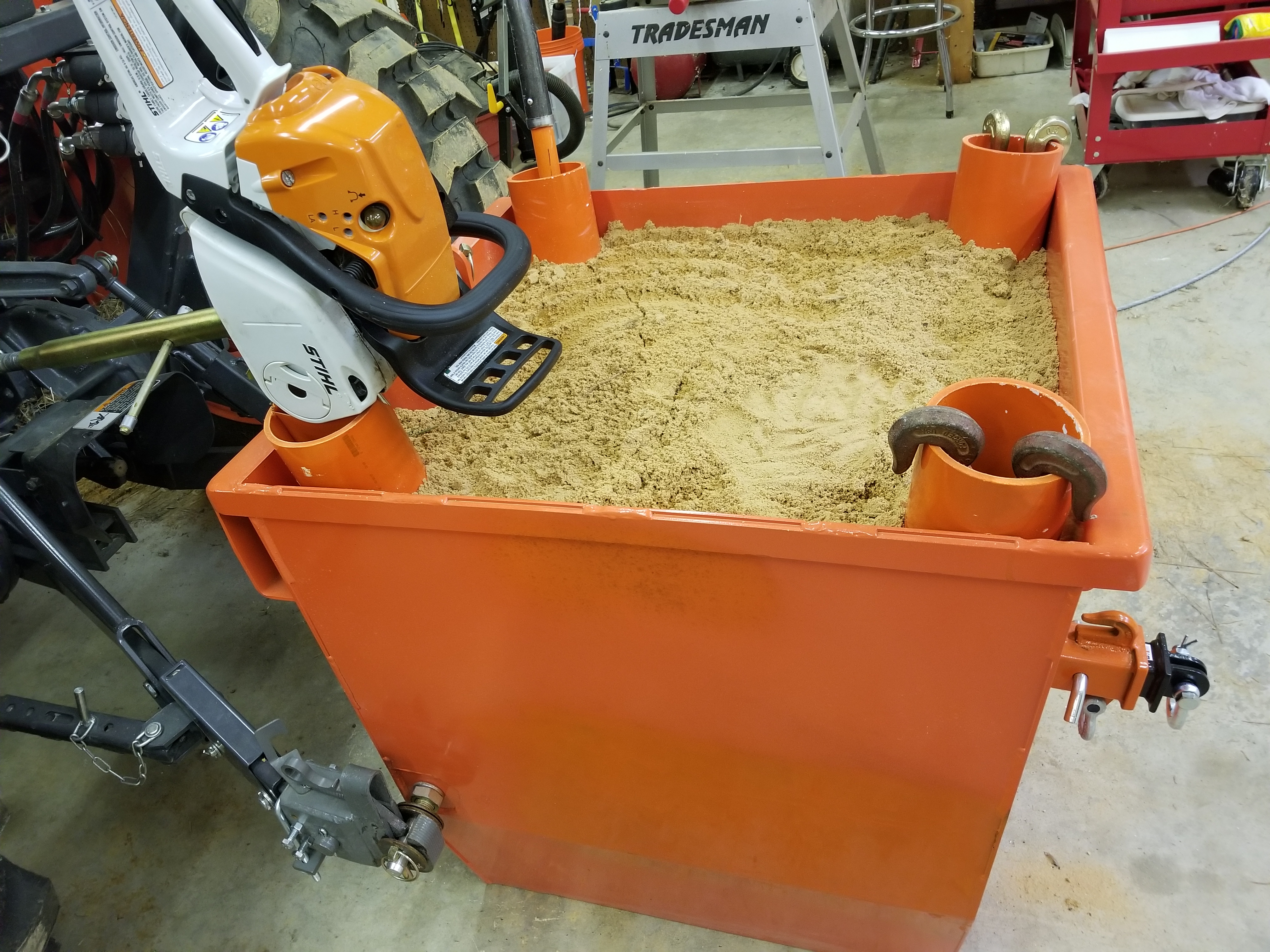

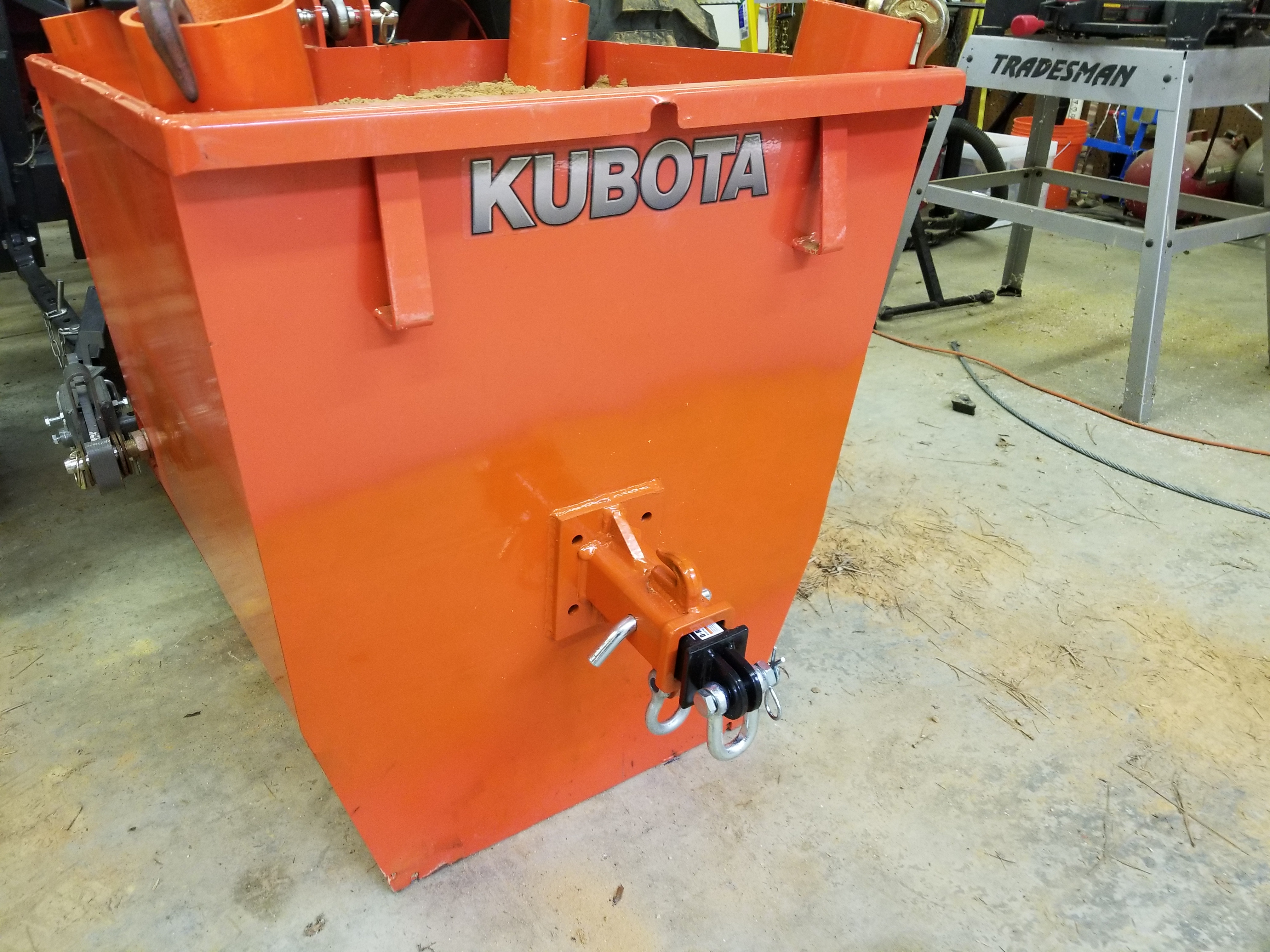

From the OP, thanks to all for your feedback. I have decided that I am going to get a ballast box that will give me the flexibility to add 1200-1800# on the back. The box itself will weigh 1500# when full of dry sand. I can vary that with less sand or almost full with sand and add iron weights I have, or fill the box partly with concrete, etc. Anyway, I appreciate all of the input. I will follow up with a report on how it goes.
#36
This is a follow-up report from the OP. I bought a OEM Kubota ballast box that weighs 220 # and holds something like 1,250 # of dry sand. I put something like 1,000 # of sand in the box, put four 4" PVS vertical pipes in the four corners of the box to hold chains, tools, my chain saw, etc. I bought a trailer-hitch receiver, had a chain hook and clevis welded onto it, and had the receiver welded onto the back of the box. I had the box strengthened by welding a 1/2" by 4" steel plate inside the box at the same level as the OEM steel plate that strengthens the area where the 3PH pins are. I didn't fill the box entirely with sand so I can add some weights on the top (I have 5 35 # suitcase weights that I could put on top of the sand if I wanted to). So, I ended up with a box that weighs a little over 1,200# and I can increase it to about 1,375 # if I want to. I just finished all of this but the box feels about right. Here are a couple of pics of the finished product:
