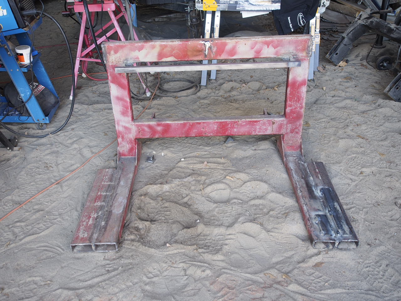

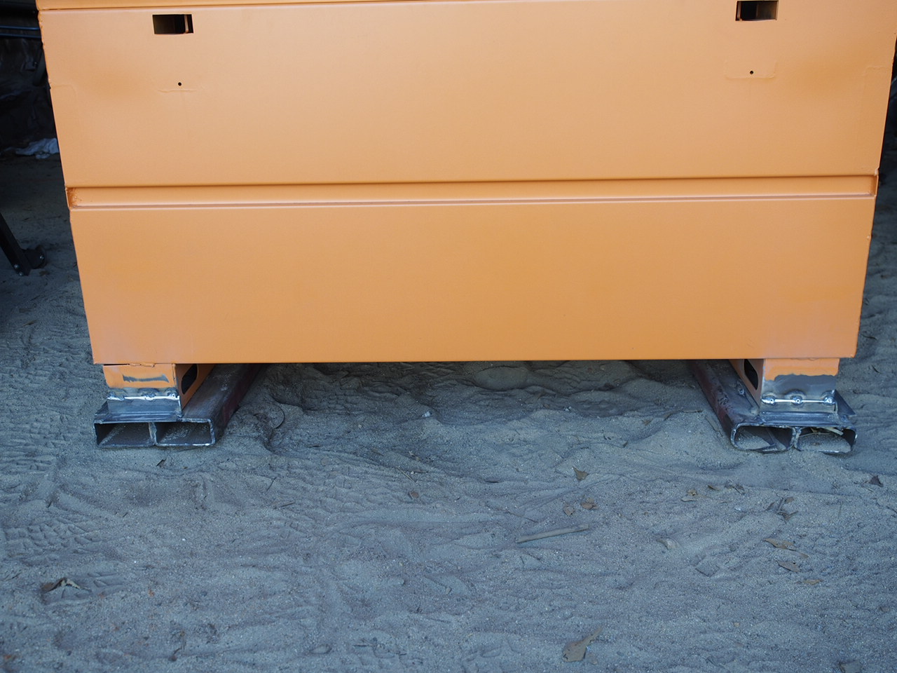

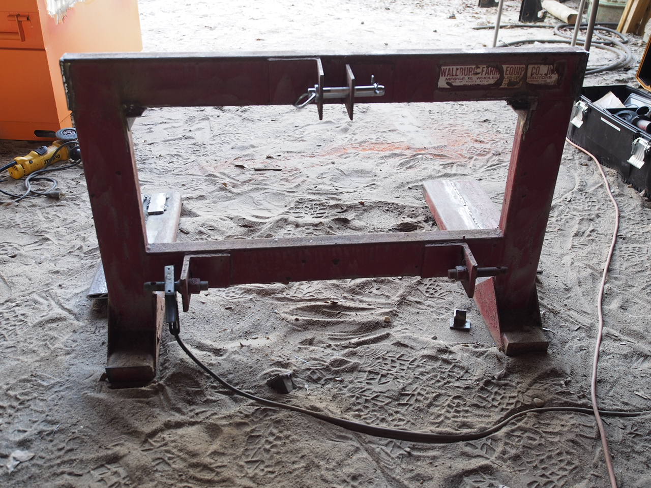

lots of 3PH weight ideas on TBN. My 710# ROBB is not enough weight on the back of my 7200# tractor with filled tires and I decided to build a weight box using a 15 cu.' job site tool storage box on a 3PH fork set a friend donated for the project. I am adding a 36" long 2" trailer receiver tube through the box which will tie to the fork lower cross bar. Will also add cross pieces to the 2" tube for added resistance once the concrete is actually poured. I am going to start with adding 750# of dry concrete bags which should provide ~ 1050# of weight. This will allow me to test usage with a heavy FEL and without before mixing the concrete. Will try and strike a balance where I can leave the weight box installed even with light FEL loads without taking too much weight off the front axle causing handling problems. I will still have plenty of room to add large rocks as needed for temporary max FEL capacity.
Starter welder? I am NOT a welder, but can do whatever I need for my usage. Had a 110v unit years ago and would recommend you stay away from that. I purchased a Miller 211 MVP and it makes me look like a better welder than I am when I take my time and do my part. Not inexpensive, but a fine piece of equipment. I use mine in automatic mode and let the machine chose the settings.
I cut the forks with a new Eastwood 60 amp plasma cutter. I almost got a Lincoln on sale for $1500 with rebate from Lincoln and am glad I went with the $650 on sale Eastwood. Not much experience with it but have cut 1" bale spear with it, but it was not pretty and took awhile to do so. On lighter material it does a fine job. But I am still learning how to run it and have more dross (slag) than I like. Will get more experience cutting the 2" receiver tube and support parts. If my uses were not just intermittent I would have purchased the Lincoln instead.
Work in progress and hope to test in a week:
