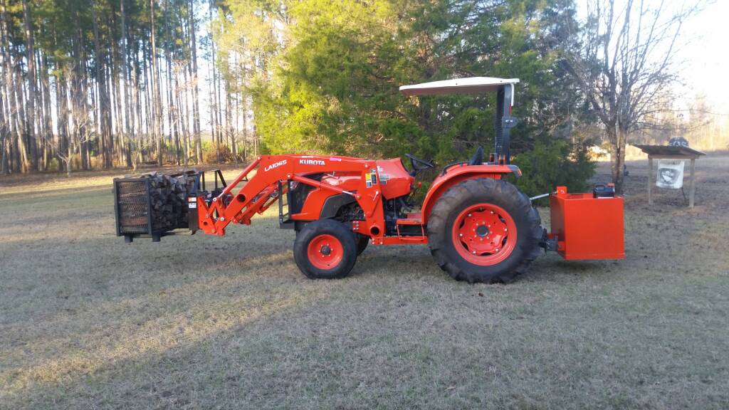

We have a L3800 with which we use a Titan ballast box. We have this ballast box up to about 750# including its weight, sand and 5 suitcase weights we put on top of the sand. We have a MX5800 on order. The MX will have a LA1065 FEL. The heaviest attachment we will have on the FEL is a 4n1 bucket at 640#. The rear tires will be loaded, which will add about 1050#. We can get the Titan box up to about 900# with some scrap iron and concrete. Or, we could consider something like the Kubota ballast box that when filled would weigh 1500#. I have read some posts that indicate that significant ballast is frequently needed for the MX tractors. I know that the ballast needed depends on what you are doing with the tractor, but do you MX owners have any advice about whether a 900# box would usually work well or if we would usually need more like the 1500# box? Thanks in advance for your advice.

The 900# box along with loaded tires should keep the rears on the ground...But you ain't doing your front axle any favors. Because you are relying on that tire ballast.
900# by itself on the 3ph is not enough. So therefore, the tire ballast allows you to load the from axle that much more.
I am considering your 900# ballast box, being in close, about as effective as my 700# rear blade which is a bit further back. I would not want to use that combo, for extended periods of hard and heavy FEL lifting. And moving bucket loads of dirt isn't what I'd consider heavy lifting either....Just to be clear.
Heavy lifting is maxing out...Or close to. Like digging at stumps, lifting heavy logs, moving heavy pallets with forks, etc.
I find the 1600# bushhog....Which has its weight center pretty far back....Is a great counterweight

900# with rears loaded with actually heavy fluid (not windshield wiper fluid) will cover you.
That's essentially what I have (same loader/capacity/frame/etc) and I frequently use the loader to max capacity.

With my 700# 7' rear blade and loaded R1 tires with WW fluid, I can lift the back tires if I am picking something that is too heavy....or trying to pry out a log/root/stump or other immovable object.
That means I am getting the full force of whatever force the loader can exert before the back tires come up + the full weight of the tractor + the full weight of the ballast in the tires + the 700# blade on the back......ALL on the front axle.
While Not having any weight box on the back actually loads the front axle LESS than having weight back there, but not having enough of it.
R1 vs R4 as well as liquid of choice make a different in weights. R4's hold more, Beet juice is heavier than WW fluid. I think I got something like 48 gallons of WW fluid in my R1's. So I've only got ~750-800# in the tires. But thats for traction when plowing, and stability. SHOULDNT be relied on for countering the front loader.
Again, I am talking about doing heavy work though. Hard digging, logging, prying on stumps, etc. If you are just moving loose dirt, a bucket load of that is ~50% of what the loader can actually lift. Or if you are lifting ~800# implements off a trailer, moving around a bucket load of firewood, pushing brush piles, etc......all I would consider lighter work that dont involve lifting near max capacity. In which case, 750# should be fine.

Thanks to everyone for the feedback. I think I will get my existing box up to 900# and see how it works.

I have about 1500lbs on the back of my MX4800 and I've not once wished for less thus far. I've hit the pressure relief several times and never seen the rear tires lift but I did have one instance where I had very little traction because of the lack of weight on the rear tires. This is with loaded rears as well, my advice is to go heavier than 900lbs that would be marginal.
