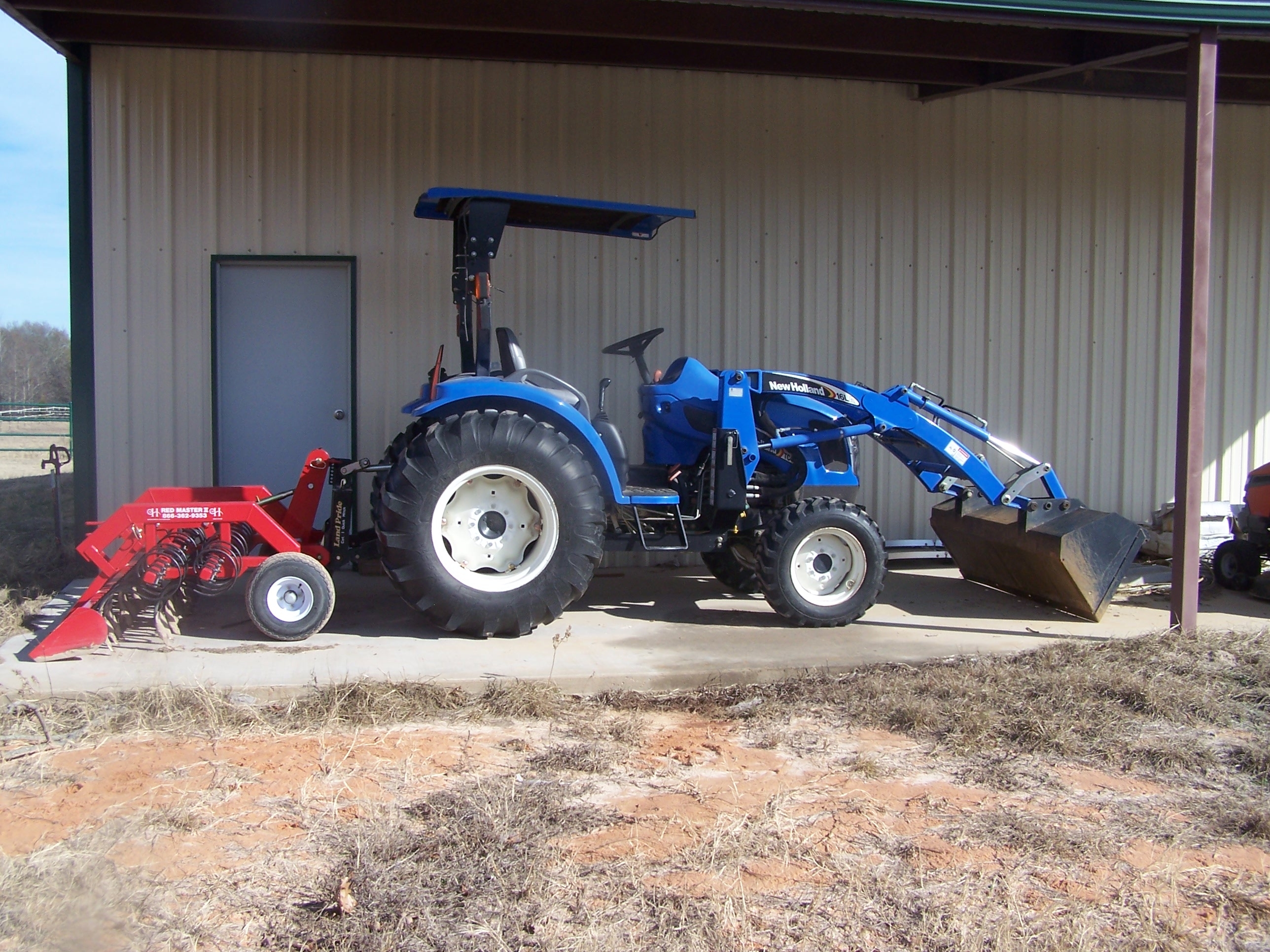

Our TC40DA has a Red Master II arena drag on it all the time. It weights 816# and sticks out a bit so leverage helps. The tires are not loaded. I have maxed out the loader lifting pallets and didn't have an issue with the rear wheels getting light. I do go slow with the weight low so as to not have issues.

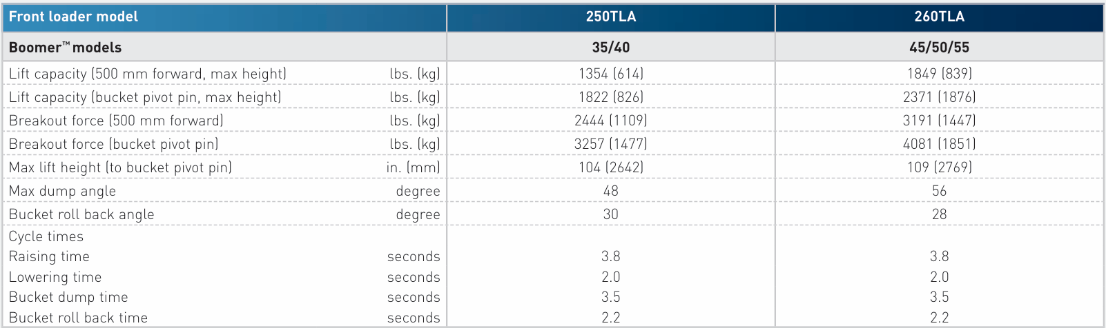

The Tractordata info is wrong, it will not lift that much. I struggle with my 16LA loader, the previous model to the 250TL, to get a pallet with 1500# off the trailer with my Land Pride PFL3048 SSQA forks which weigh 358#. If I can tilt the load back over the pins without dumping stuff off, it helps a lot. The NH website says the max lift for the model 250TLA is 1822# at the pin, 1354# at 24" (500mm). It would be even less with the pallet sticking out 36"-48" in front, plus add the weight of the pallet forks. That is to max height but it won't do much better at lower heights. That decreases the amount of ballast you need to be stable. Based on those numbers and since you have the cab weight, 600# of ballast should work but 1000# won't overload the machine.
