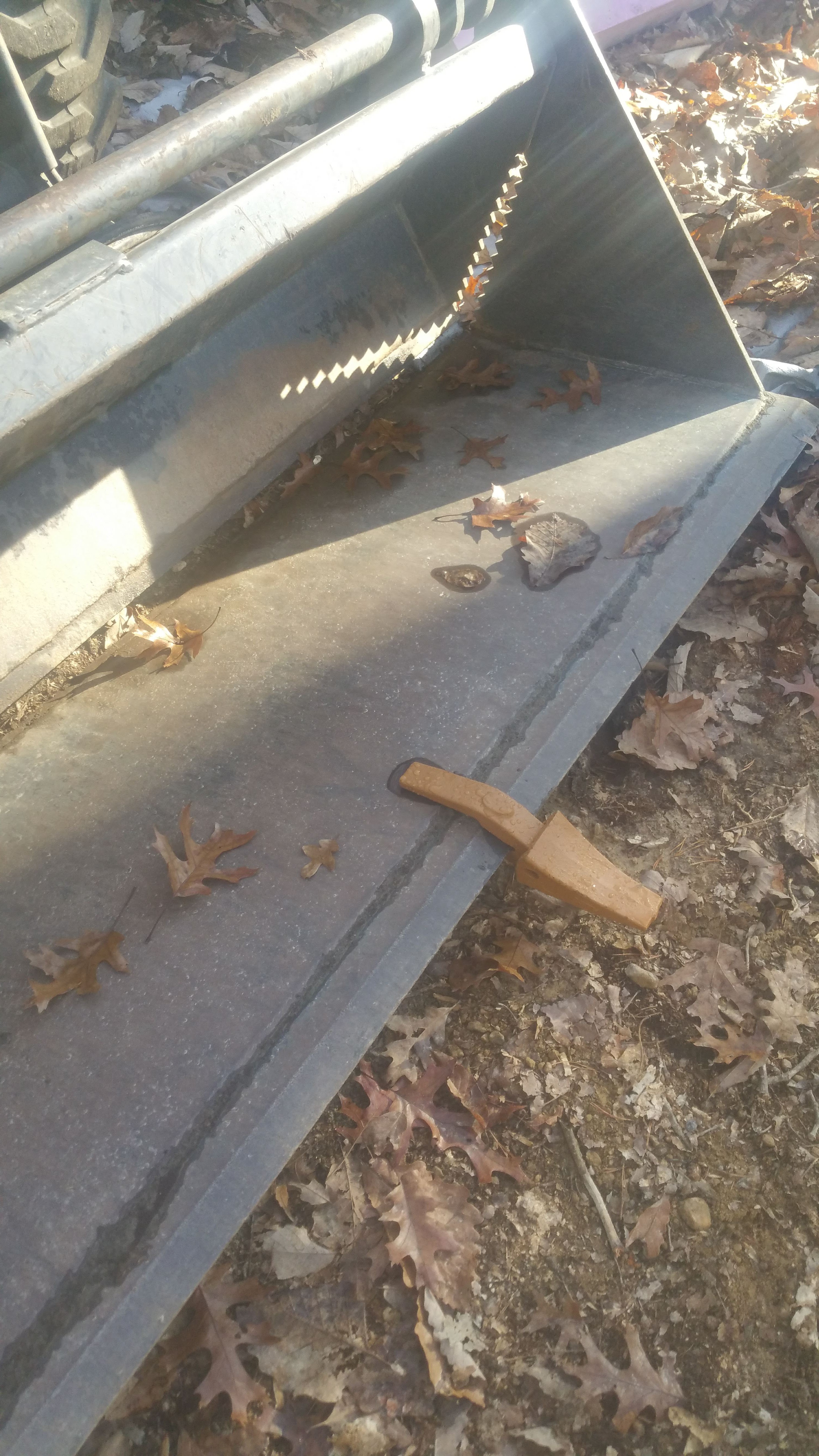

Need to be able to dig out some dirt. Soil is a little on the clay side. Definitely not soft, rich topsoil or sandy.
Would like to add some teeth to my 4 in 1 bucket cutting edge. I ordered a 23 tf tooth from Titan to check fit and it fits good.
The inside of the bucket is 71inches wide.
How many teeth do you all think would be good for loosening up my soil? Is there set number of teeth per inch that works good in clay soil?

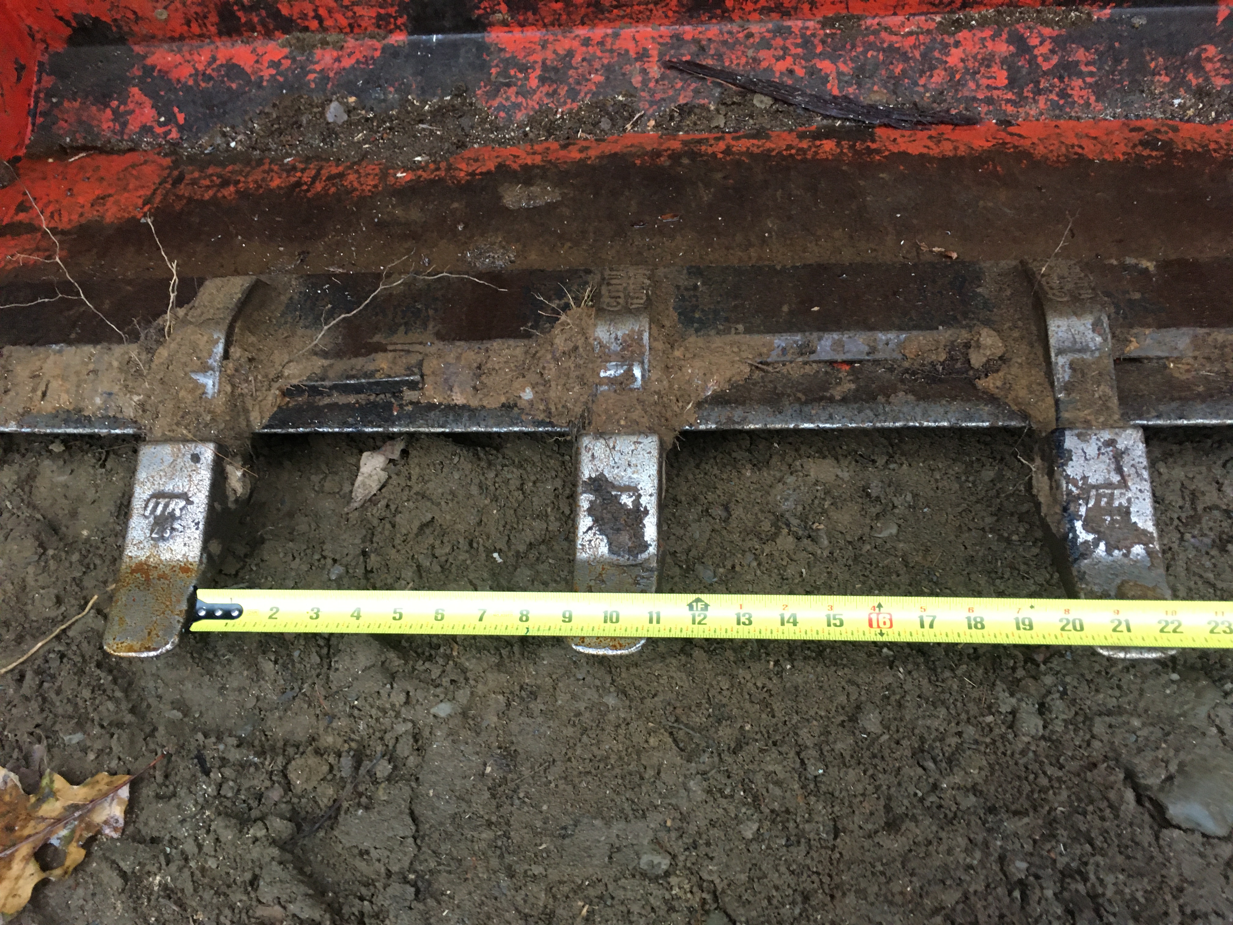

About 8" to 10" spacing is good, your choice. Just make them all evenly spaced.

I pick 9. I have 6 on my 5' bucket and wish I had 7....

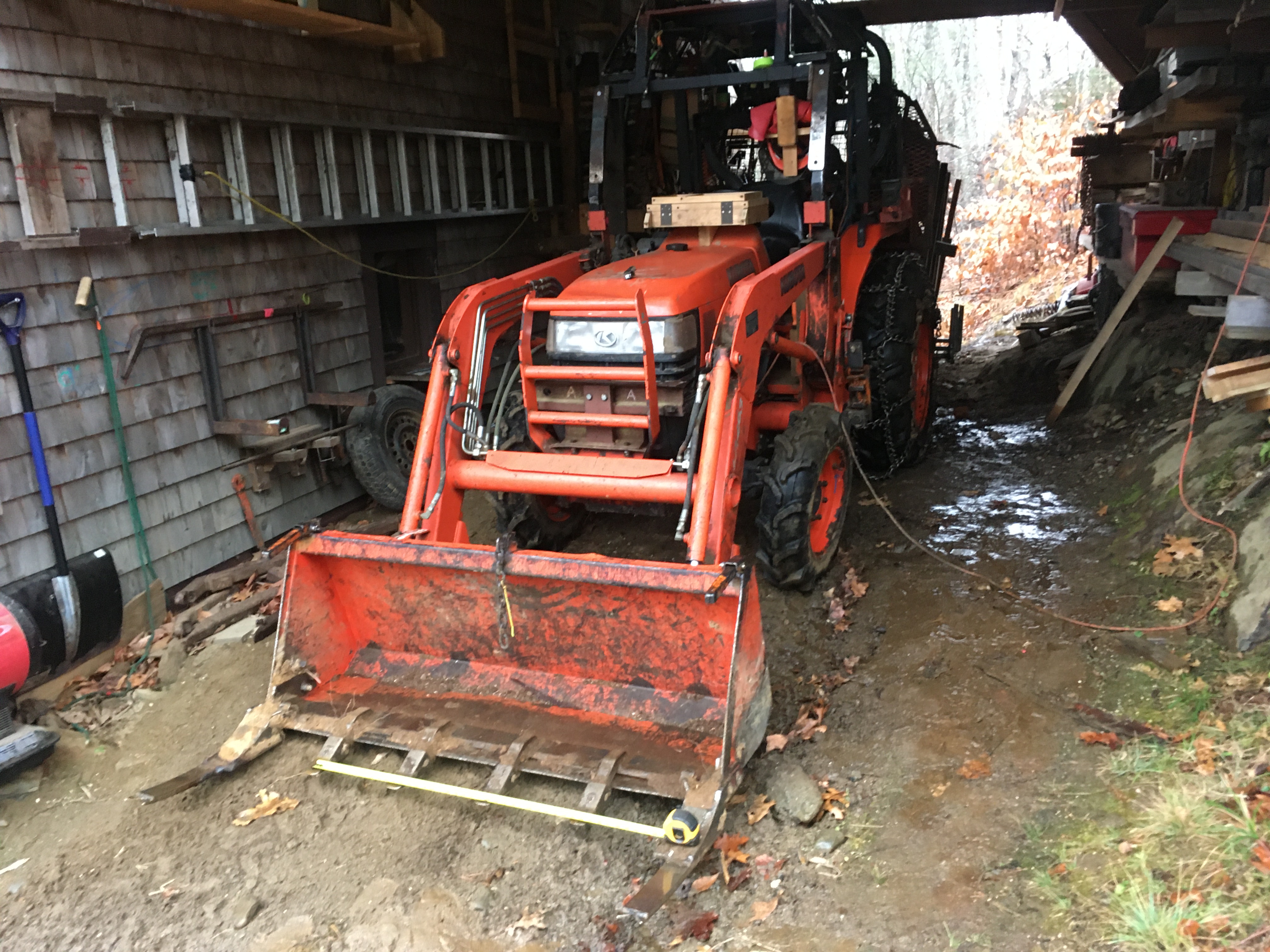

Oldpath05 has a nice bolt on edge. It is nice to take it off when not needed so you don't walk into them or have them in the way when loading firewood in bucket or clamp on forks or sticky soft material etc.
Power Trac has individual bolt on teeth. How are the Titans, weld or bolt on?
The theory of the teeth is to concentrate your traction pushing power on the tips instead of the long smooth edge. I think it really depends on your soil and by experience. The recommendations sound right, but if you put on too many it will probably work against you.

Plan on putting the teeth on the main front edge. Can still bulldoze and drag with the 4 in 1 open is the plan. I have the light material bucket also if I need it.
I originally wanted to do a bolt on tooth bar and so I only ordered 1 tooth to see how it would fit.
The P.T. bucket and exisiting front metal cutting edge are so thick that there is no room to put another metal edge under the back of the tooth for an additional flat bar to do a bolt on bar. The tooth fits perfectly with no slop tight to the existing bucket metal so I can't deny the ready to weld fitment.
Oldpath05-you don't play around. That is one tough looking Kubota!
Appreciate the sugesstions all. I will order more teeth and go for about 8 to 9 inch spacing.

Cat has a nice "corner shank" they use on their backhoe buckets and is close to the same size as what you have. I used them on a SS bucket I built, and having the end tooth directly on the corner is very helpful. (also makes our little machines look like the big boys :laughing:)
I'll look for a picture later.
