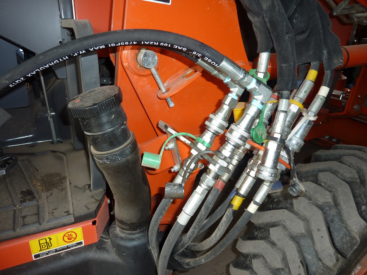

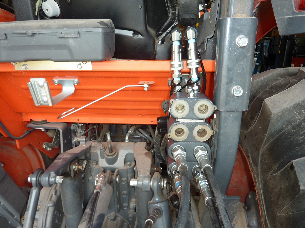

I had 3 on my old L3010 & L3430. I also have 3 on my current MX5800 and L6060. Most of the time, I find 3 to be enough. The L6060 however has a T&T kit which takes 2 leaving only one spare. I have a couple of implements with dual cylinders so I added a 4th set to the existing stack of 3. I plumbed it up to the FEL 3rd function valve using a couple of removable hoses.
Diverter valves are also an option but I find them difficult to use while maneuvering.
