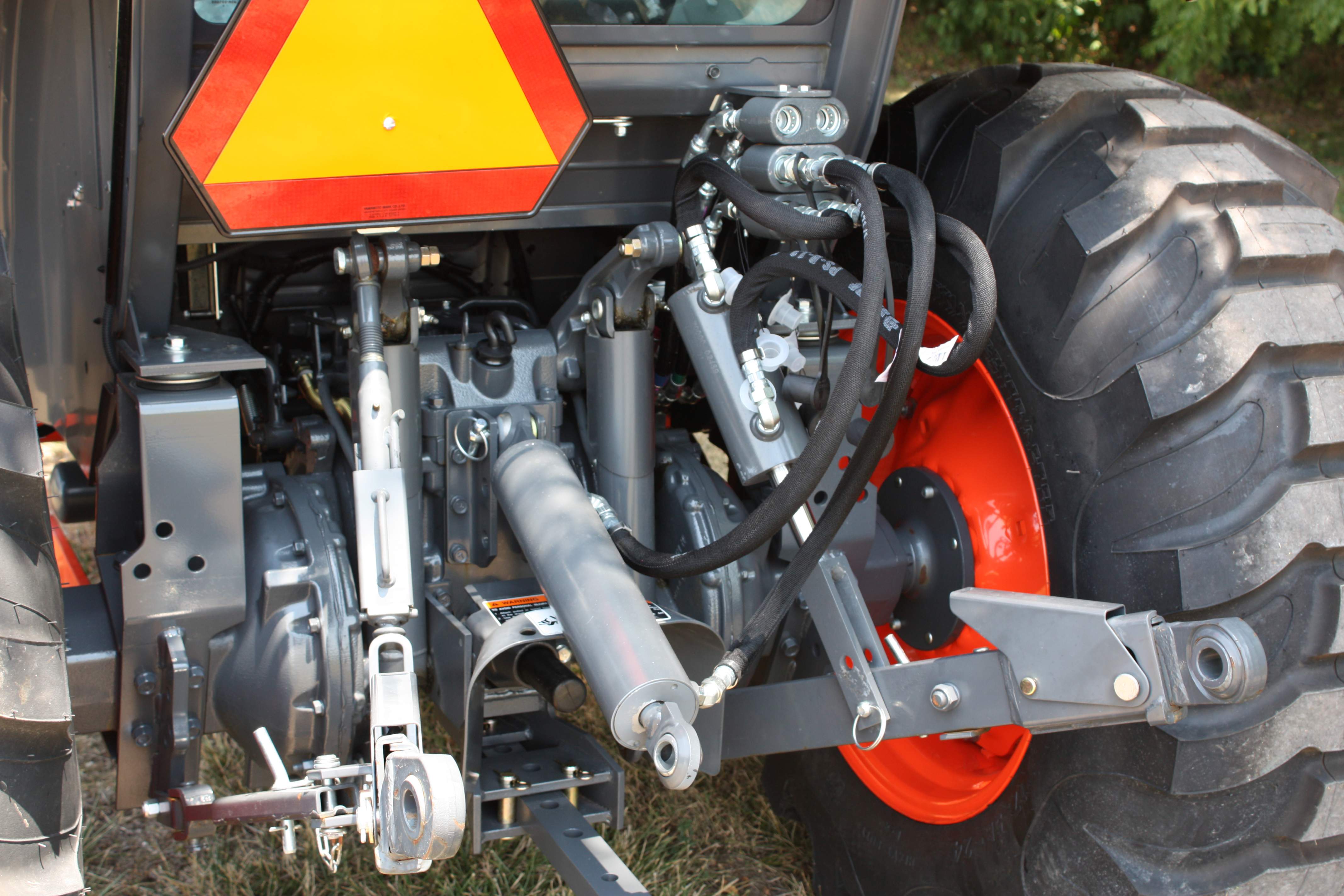

I have 5 on my 75hp tractor and 4 on my 32hp tractor.
Top & tilt takes 2, hydraulic actuated rear blades can require up to 4. Angle, offset, tilt, gauge wheels.
I had a customer that needed 6 sets of rear remote outlets on his Kubota M7040. So he had the 3 factory valves and then a 3 stack of diverters.
