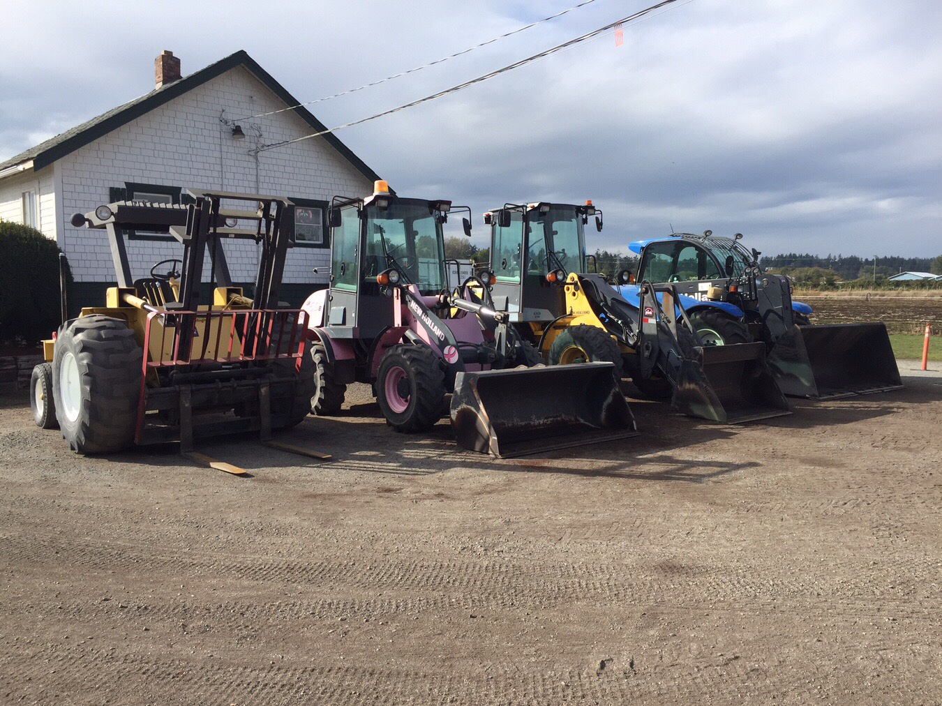

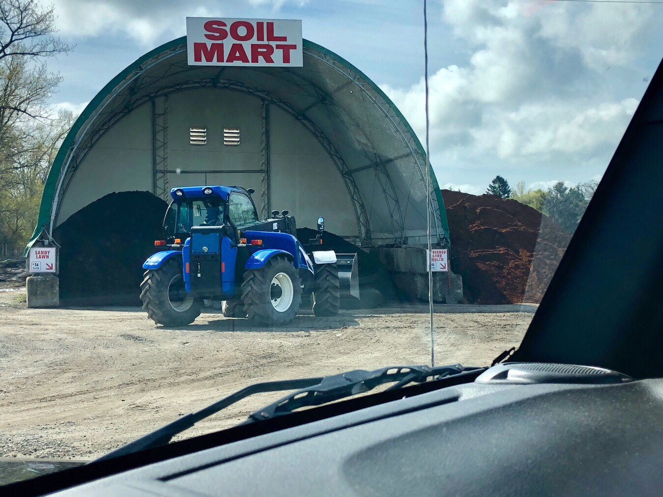

On our turf farm we operate a soil mart in conjunction with turf grass sales and as such a good portion of soil sales involve half and one cubic yard orders loaded onto pickups and trailers.
We have one yard and specially build NARROWER half yard buckets (for import size and short box pickup trucks). We ALWAYS HEAP the bucket when loading customers.
