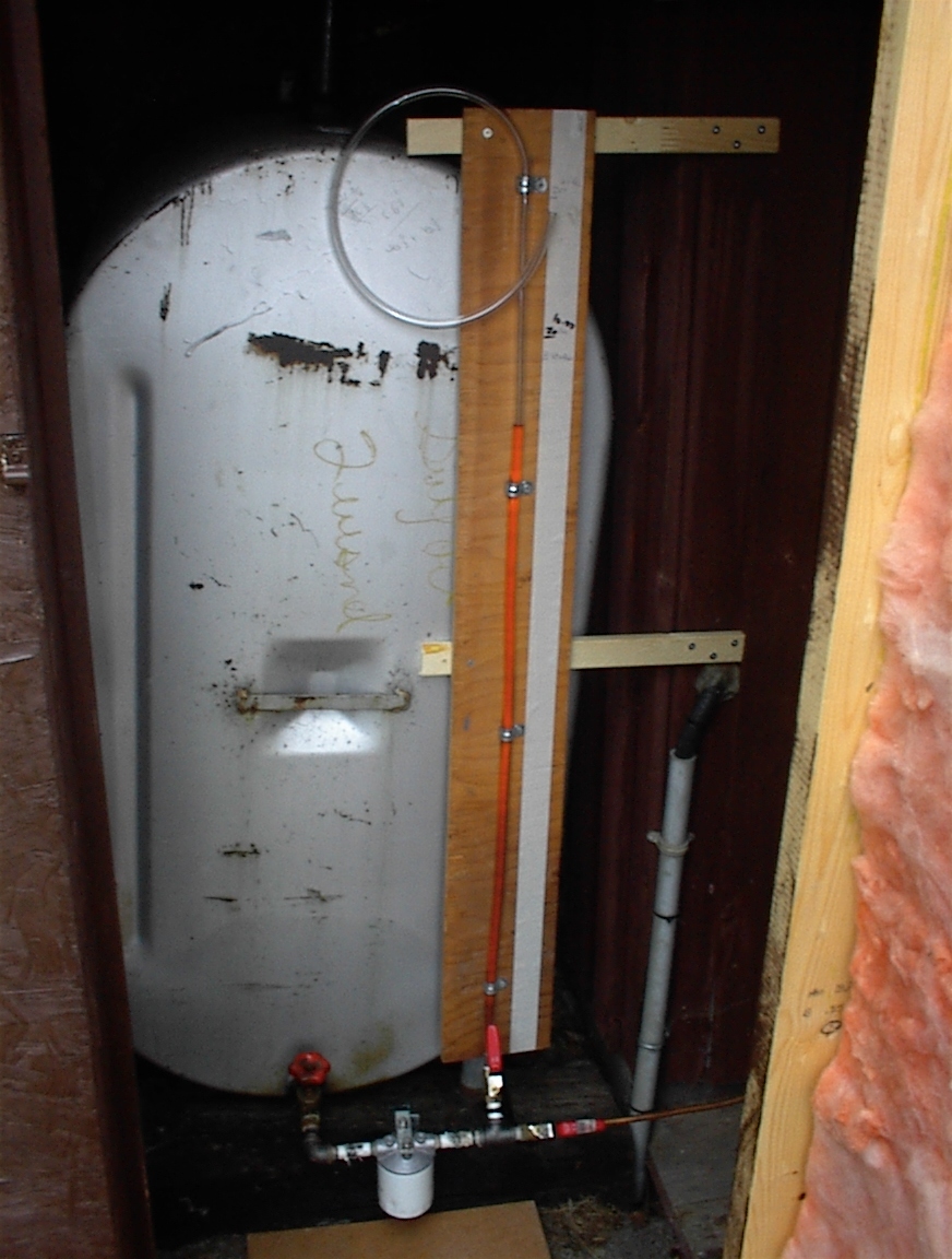

I have a tank full of dyed diesel that is maybe 16 years old. It is the fuel supply to my standby/backup generator and is stored in a 250 gallon home oil furnace tank. I have topped the fuel off now and again using artic diesel (for -40 weather) and have added some treatment but not much.
The generator runs fine and starts easily with a good battery and doesn't smoke under load.
As long as the fuel storage tank is out of the weather and kept full, you should be fine with long term storage. I guess a lot depends also, on the fuel source - not every vender is clean or cares as they should.
Attached foto of my storage.
