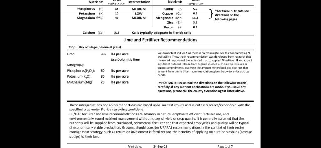

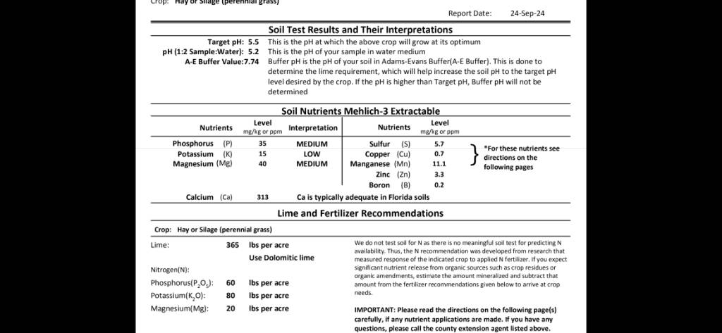

Well, my sample came back at 5.2 PH, but I was surprised that my Bahia grass yatget is 5.5 PH. Maybe I'm an idiot, but Nitrogen is left blank? Needs P (60#) and K (80#) for sure, as well as 400# lime. I also need 20# of Magnesium.
I've only briefly looked at it, been busy at work doing hurricane planning.
   / How long to let a very over grazed pasture sit?
#84
I did miss it, needs 160# of nitrogen

Holy that's poor, I thought my 27lb per acre was a lot (150lbs of 18/18/18) ... I would suggest you split your application in multiples pass so you don't burn your soil and also if it rains a lot you will have less waiste.

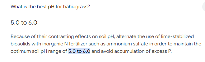

Interesting how different the recommended targets are. I guess we're growing different crops, but wow... never thought anyone would be recommending pH in the 5's!

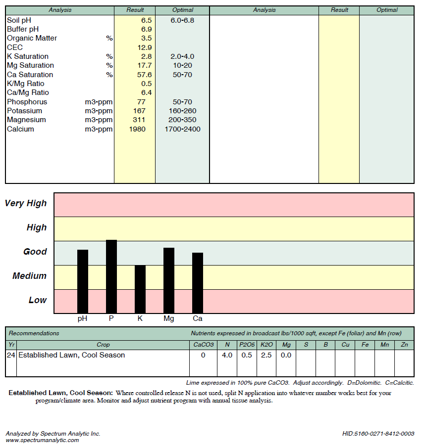

Here's mine from this spring:
So, you see the little table of recommendations at the bottom? Those are seasonal totals, and I break that into 5 applications. The break is not even, as different times of the year pull harder on one nutrient versus another, but the fertilizer manufacturers have that worked out pretty well by packaging the products you're using (pre-emergent, grub control, etc.) with the ratios that favor that time of the year. Usually you only have a choice of two different nutrient levels in each product type, making hitting those yearly totals like a 9 month long game of Tetris.
Your right it is surprising but after googling it that's what it needs. Most grasses are in the neutral ranges but there are odd balls.
Looking at your chart, it's calling for 174#/acre N, the numbers just look smaller cause they are basing it on per 1000 soft, vs #/acre
