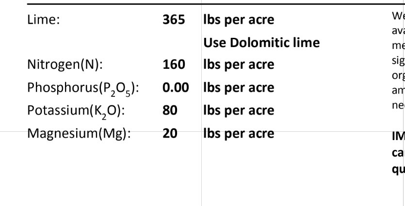

It's not a full acre, it's actually closer to 0.78 acres. Mine called for 375#/acre, but also listed it as optional, as less than 1000#/acre isn't typically feasible.
160# Nitrogen
0# Phos
80# Pot
20# Magnesium
I dont trust their recommendation of zero on the Phosphate.
I think i actually misspoke above, I'm adding 32# N (over 3 applications), 4# Phos, and 8# Pot. Then I'm going to look for (recommendations?) on a Magnesium and Potash combo, to get those up.
I know the numbers I'm adding don't exactly meet the target, but 96# N/0.78a, 12# (allegedly need 0) and 24# (need 80#).
I think Magnesia-Sulphate, with maybe 2nd application will put me at almost perfect? Does that counter my lime though? Sulphate should be acidic?

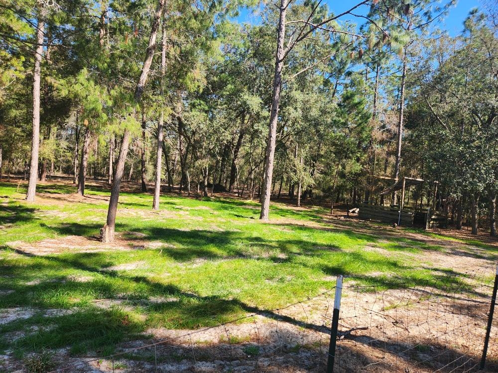

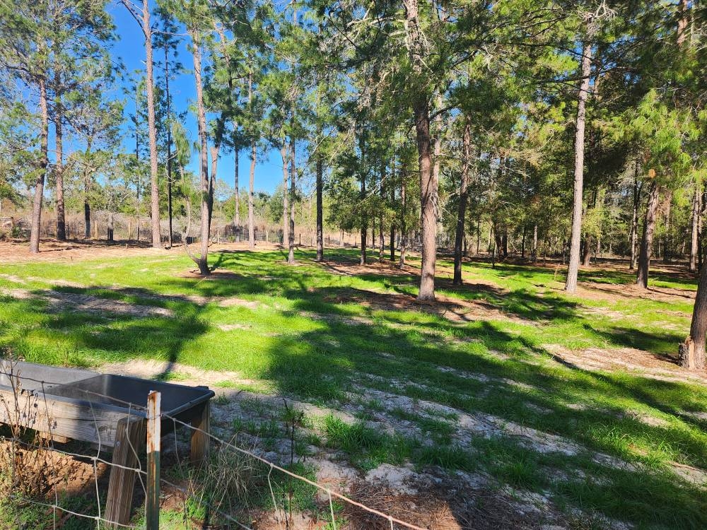

This is earlier today with the rye. That was right before I spread the lime.
