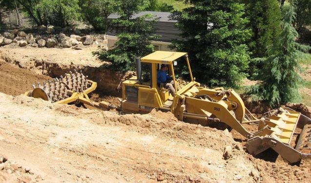

I had a slope that had an unknown pedigree for compaction. I had to have it dug out and put back in a foot at a time. Here is the Cat excavator with the poker it took to get it compacted at 95% (required, it came out at 98%). This is decomposed granite here in California. I dug a trench for a water line on the back hill in native soil and after I filled in the trench, it settled an uneven 2 to 3 inches all along the trench. You'd think undisturbed soil would be fairly compacted, but here it wasn't.
