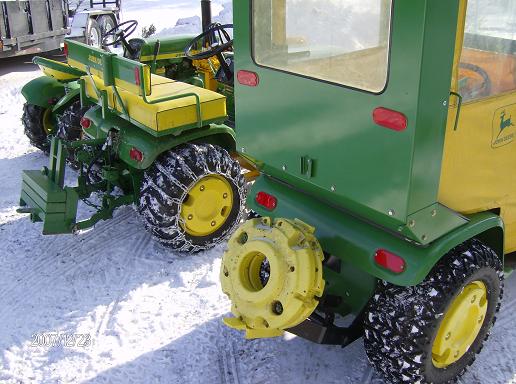

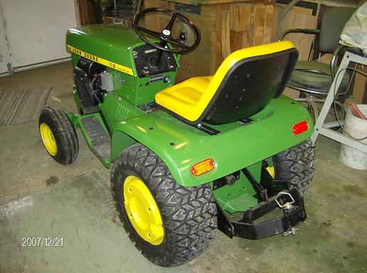

Haven't got them on yet, but I just got a pair of Carlisle All Trail tires for my 550 Mule. It always had the same problem with snow, HELPLESS. I have the All Trails on my snowblower tractor 74 JD-112, I have had no problem with it, even uphill on packed snow from a previous storm or on wet grass going uphill blowing snow!

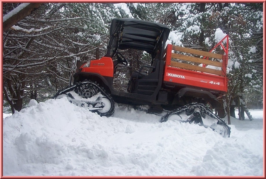

The ultimate snow machine & wood hauler
/ How is HPX in snow? #10
Do the tracks ride over and compress very deep snow sufficiently to take the unit's weight?
#11
Holy Lake Effect, Deerlope! You'll get no argument from me! If that isn't the ultimate, I don't know what is. Does it come with a little keg of brandy dangling from the front bumper? :) As attractive as that is, it's well beyond me. Got a little savings goal of a Kubota M-series that I don't want to derail.
