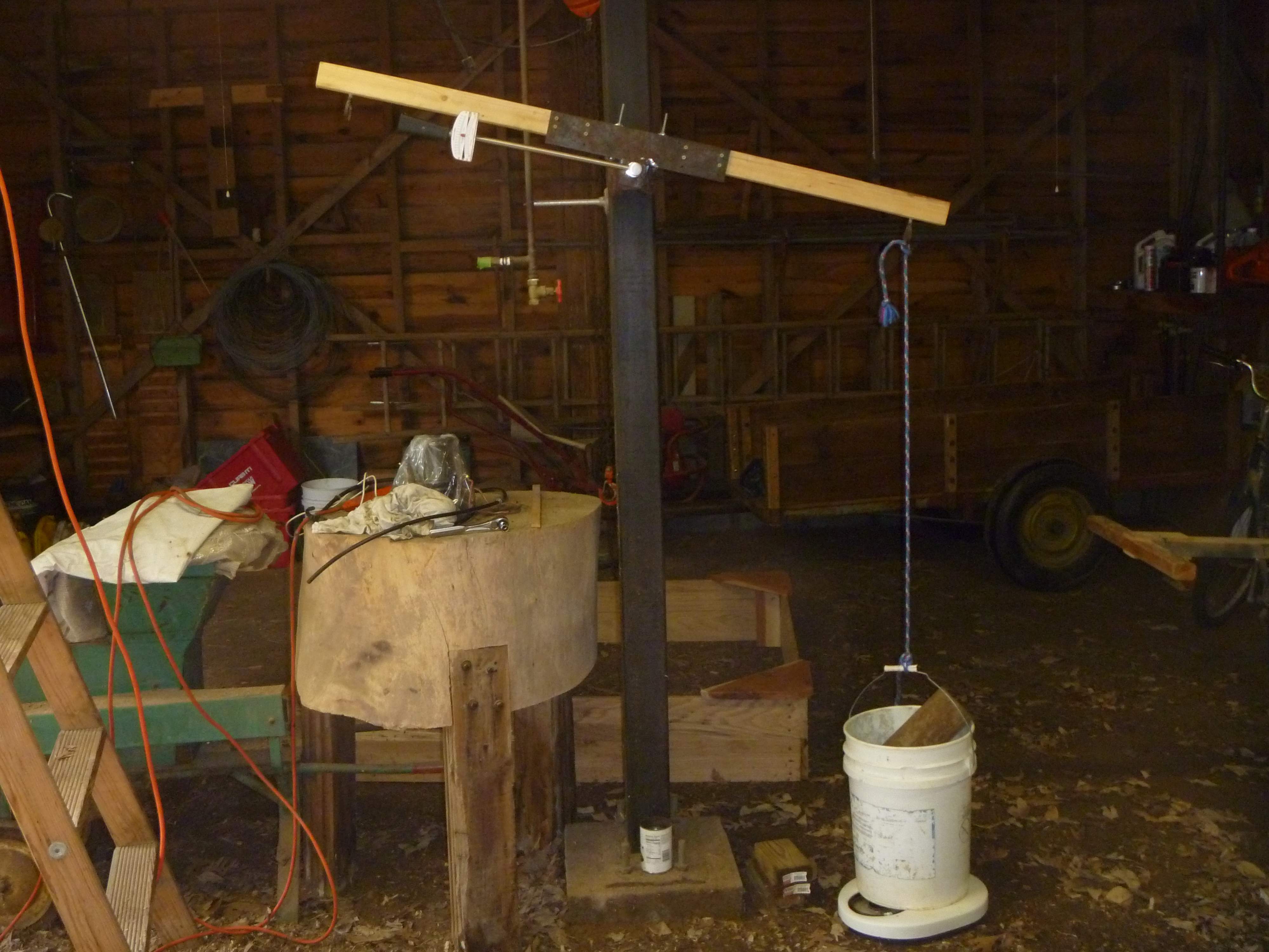

I got a lot of help on this forum when I was building my trailer including the importance of proper torque on the lug nuts. I bought an adjustable T wrench that clicked at the "proper" torque. I tested it by torquing a 1/2-20 nut at 10 ft-lbs. I stripped the bolt and it never clicked. Took it back equipped to demonstrate this but they had no vise or other equipment so I took my $ and went to Sears and bought one of simpler technology. I tested it too but more accurately.
I attached a "see/saw" arm to a vertical post in the barn. It pivots on a pair of pillowblock bearings and 2 feet away from the pivot point are hooks to attach a bucket filled with weights. I wanted to see if 90 ft-lbs on my wrench was accurate so I put weights in the bucket til it weighed 45 lbs. (2 feet x 45 lbs = 90 ft lbs).

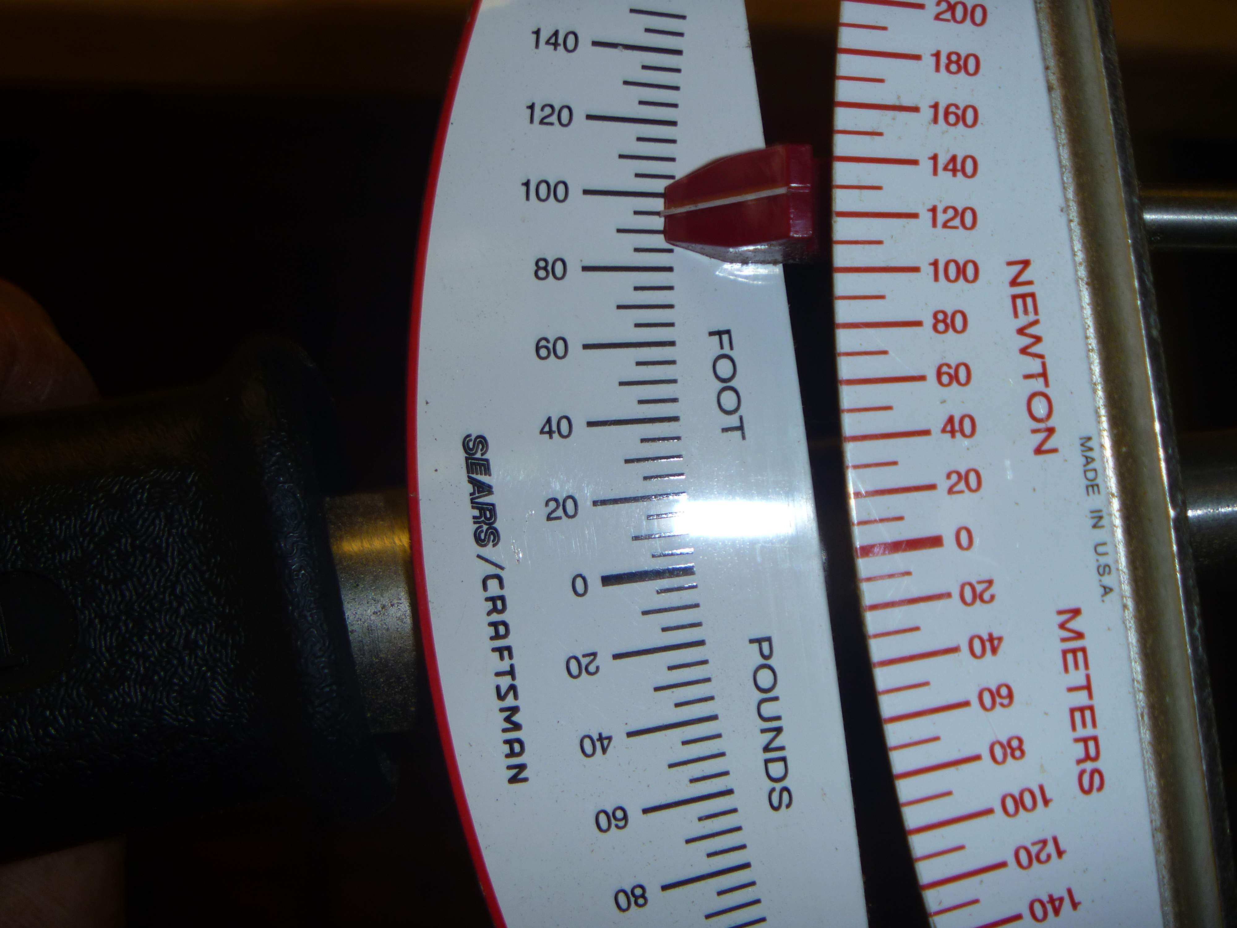

I put the wrench on a nut welded at the pivot point and leveled the "see/saw". The pic shows 95 ft lbs. Not too bad.

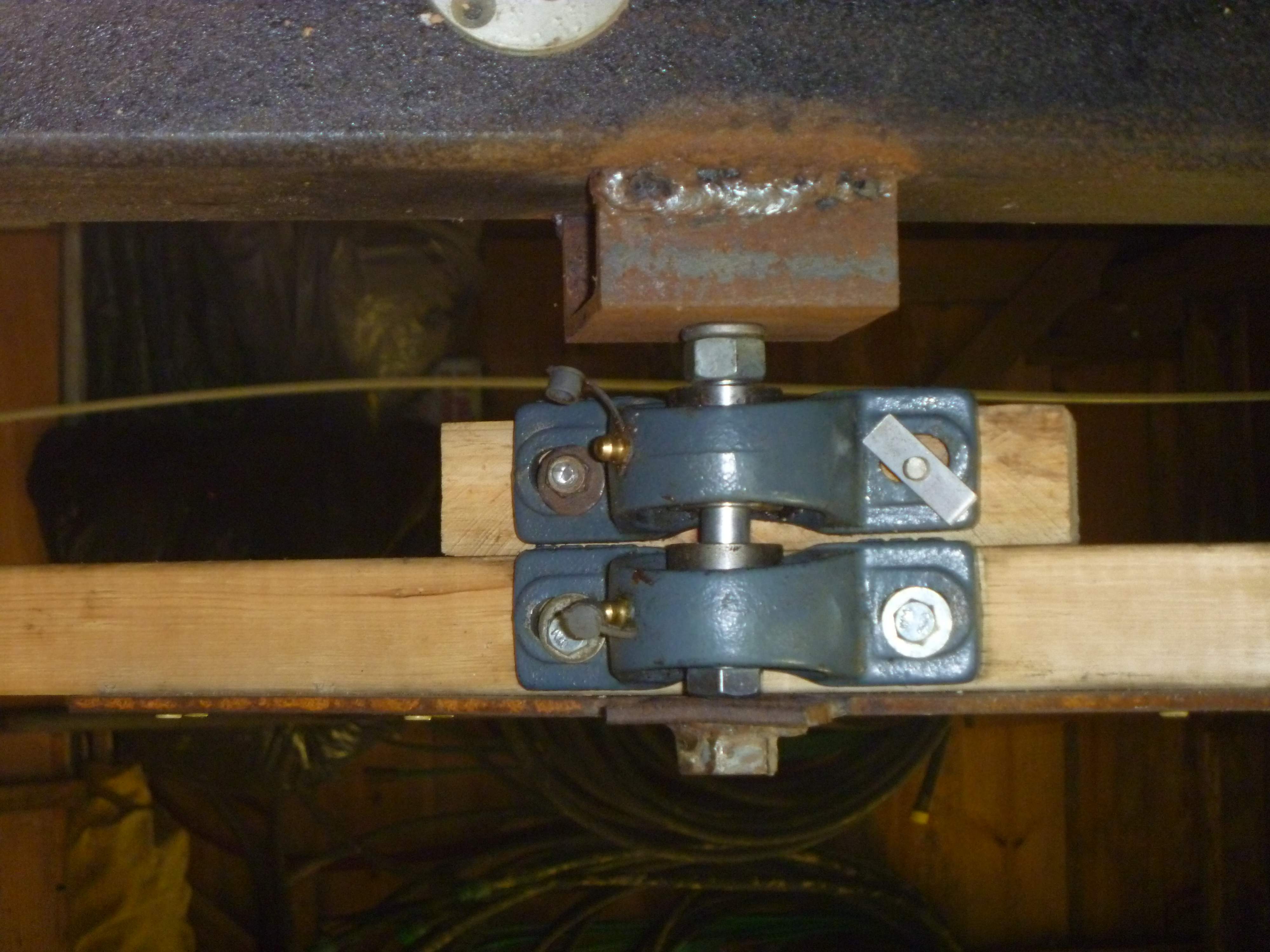

It is important to use 2 pillow blocks because I used self-aligning ones. Only one would misalign.

The assembly is well balanced when empty: It will remain stationary in the level position. It was a fair amount of work for a calibration that does not have to be done often but like most of us on this forum we like to do things like this and I know what my lugnuts are torqued to.

I would have thought you would make the bolt head unmoveable (weld the bolt), then hang the weight from the center of the handle with the appropriate weight for the arm length to see if it is accurate. Otherwise there is still some friction in the pillow blocks. But otherwise it is about 5% off. Good enough for gumvent work.
/ How I check my torque wrench #3
I just read up on this topic, by coincidence. Two thoughts. The longer your lever arm, the more precise your calibration. The site I saw recommended 8 feet. Also, they recommended calibrating all the way up and down the range, since the wrench's response may not be linear. They suggested buckets of water as easily adjustable weight.
