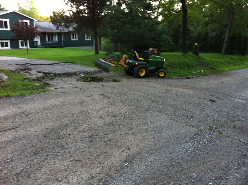

Here is couple of pictures of my rake setup. The first shows the nice tweak I've developed in the last three months. Upon further inspection it looks as though the rake bar is still straight, but the frame itself has the tweak.
I fell a long since dead tree into the road, and of course it exploded on impact. I needed to get the road cleared quickly, so I used the rake to pull all of the twigs into my driveway. Now I could pick them up without having to fear getting run over by a car. Normally I just drag the twigs to a burn pile, turn around, and "doze" them into the pile by backing up. I think this is what you're trying to do.
