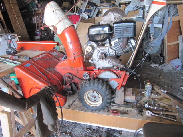

I have a project well underway to create what I'll calling my "Hotrod Snowthrower"! I've installed new bearings at the ends of the auger where there used to be bushings. Those were hoplessly worn into oval shapes. I have to wonder how the previous owner could endure the obvious clatter and hammering as the machine chewed away at itself. I originally bought it for the engine so I could repower a tiller. Now, some years later I'm in need of an improvement in what I use to clear my drive and turnarounds of huge amounts of drifted white stuff. At this point, I need to fix the tires. The problem, as the thread title states, is getting the wheel(s) off.

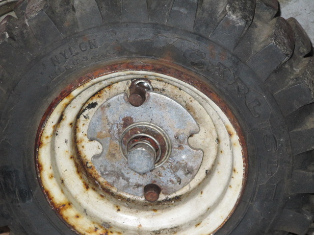

The first photo shows the wheel I'm trying to remove. The second one shows how far I got before the trouble started. To me, it looks like it should slip off if it were not rusted on. That spring loaded business in the first photo has me thinking it is for "free-wheeling" while doing turns. Is that what its for? In any event, the wheel is on solid and refuses to budge even when I use a puller on it. I'm fishing for ideas and advice from the collected experience and wisdom so richly represented here:thumbsup: before I do serious damage to something. I'm ready to use some heat on it but will wait for either confirmation or cautions regarding that route. The last photo shows the 13hp engine I'm repowering the blower with. The original was 8hp. The 13hp will have a larger diameter drive pulley to speed up the machine a bit.

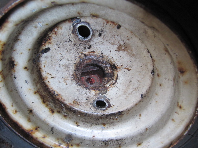

This is exactly what I have done so far except I also used a puller on it and "whupped" pretty hard with a 16oz ball peen. All I succeeded in doing was to bend the wheel where I fastened the puller. I took a closer look at the other side and discovered that the wheel is installed the opposite way and held in place with a pin. That one will probably come off with a little less difficulty but not by much. BTW this is a Simplicity - built by or at least marketed by Allis Chalmers in case that helps any.

looking fromthe back, can you see a keyway?
/ How does this wheel come off?
Nope!:thumbdown: I'll have to hook up the puller somehow and persuade it that way.
I went back out for another look. There is no keyway? Would this confirm my suspicion that it should freewheel? If so, would that hardware under the spring not prevent it? I don't see any way for that to work.:confused:

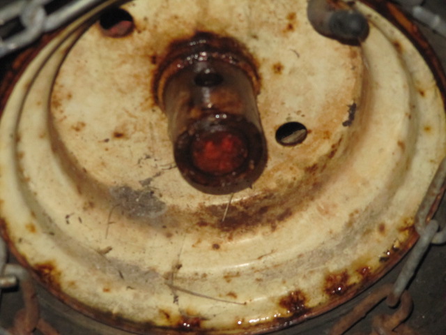

Anyway, I took another photo; this time of the opposite wheel. This shows how much DOM tubing is rusted onto the 7/8th" shaft - about 1 3/4th". I sprayed it thoroughly several times with a product called Moovit - a penetrating oil.

I think I know what you mean and the sentiment is shared.:muttering: If the penetrating fluid doesn't soon do the job I'll go with the WD40. But it's looking more and more like I'll have to custom fashion a puller for each side and do it that way. Too much beating on the ends of the driven shaft could mushroom it and then I could be screwed!:shocked:

but not tatoo'd. you can regrind the axles ends if they do mushroom.. though do try to avoid that. :)
