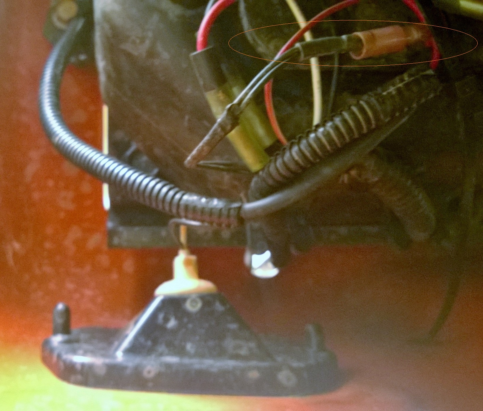

Here is my lighting thread as well.
http://www.tractorbynet.com/forums/customization/343738-fender-light-install.html
The under fender wiring had a female that my factory light kit plugged right into.
