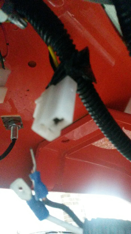

GOGO ok forget the under seat, stand behind your Bx and look at the rear PTO. To the left is a wire loom, you may see a bulge in that loom. That's where they placed additional connectors.
   / How do you wire the bx2670 for extra led lights.. need help pls? #18
The connector for the work light should look like this.
#19
Citydude....
Mine looks nothing like that :(
Crap.. I wonder what I pulled apart then?

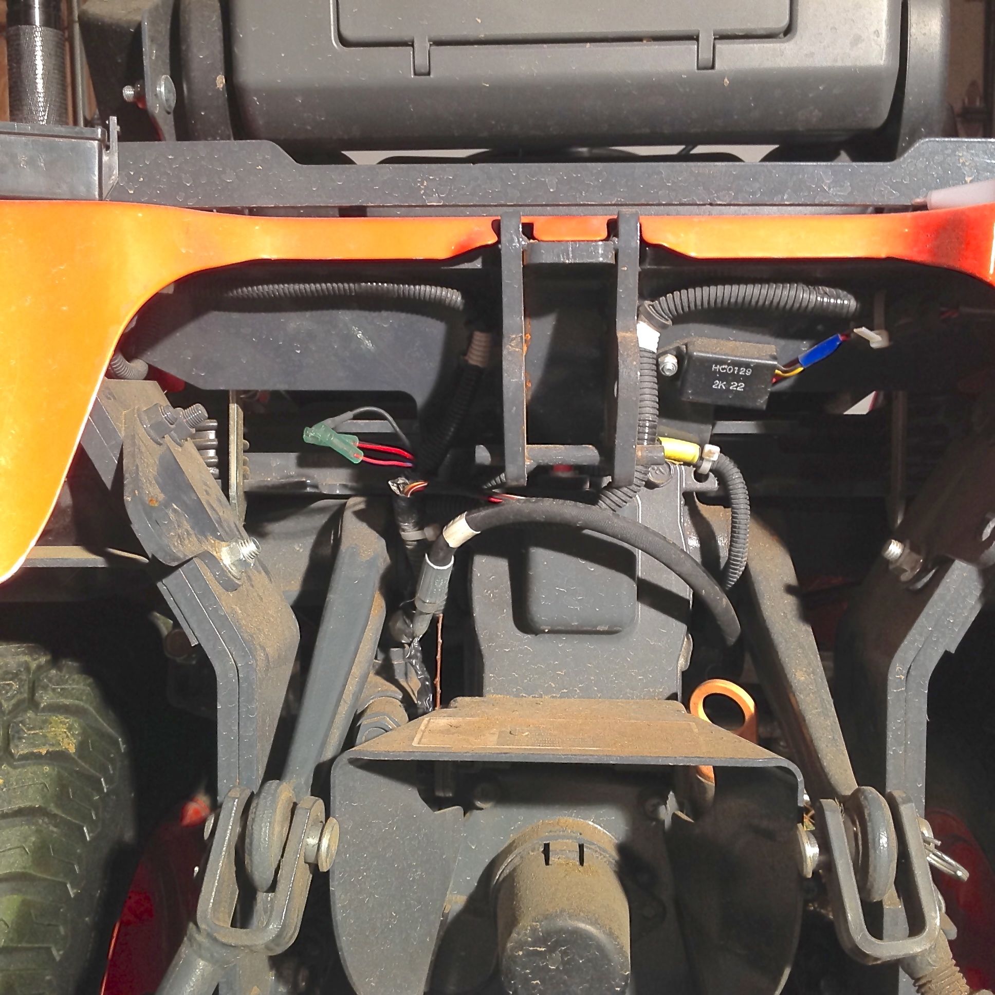

This is what I see from behind the tractor. Also.. I seem to have lost my rear red tail lights. Checked the fuses.. seem fine. Wonder what I did?
   / How do you wire the bx2670 for extra led lights.. need help pls? #20
Citydude.... Mine looks nothing like that :( Crap.. I wonder what I pulled apart then? This is what I see from behind the tractor. Also.. I seem to have lost my rear red tail lights. Checked the fuses.. seem fine. Wonder what I did? <img src="http://www.tractorbynet.com/forums/files/kubota-owning-operating/445273-how-do-you-wire-bx2670-image-jpg"/>
Well, durn. If you pulled any wires apart, put em back together. In your picture, there are green butt connectors with two red wires. Are they connected to anything as in dead ended? I also see a black wire behind the red ones. Is it connected to anything?
