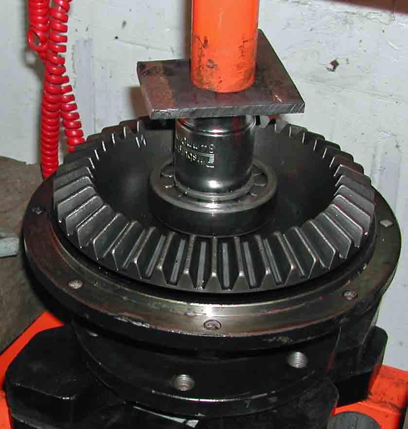

I don't know what the 30T deal is, but I bought the 20T HF for under
$200 years ago. I straighten bent hyd rods, press bearings in and out,
bend thick brackets (5/8") and other parts for steel fab. Etc, etc. I
have a home-made brake for it, too.
A tool like this is essential for most home workshops.
That said, sometimes I wish it had air-assist, but other times, I need the
fine control using the lever. I have a 20T air-assist jack that I use
separately, and you do not have the same feel or control using it in
air mode.
