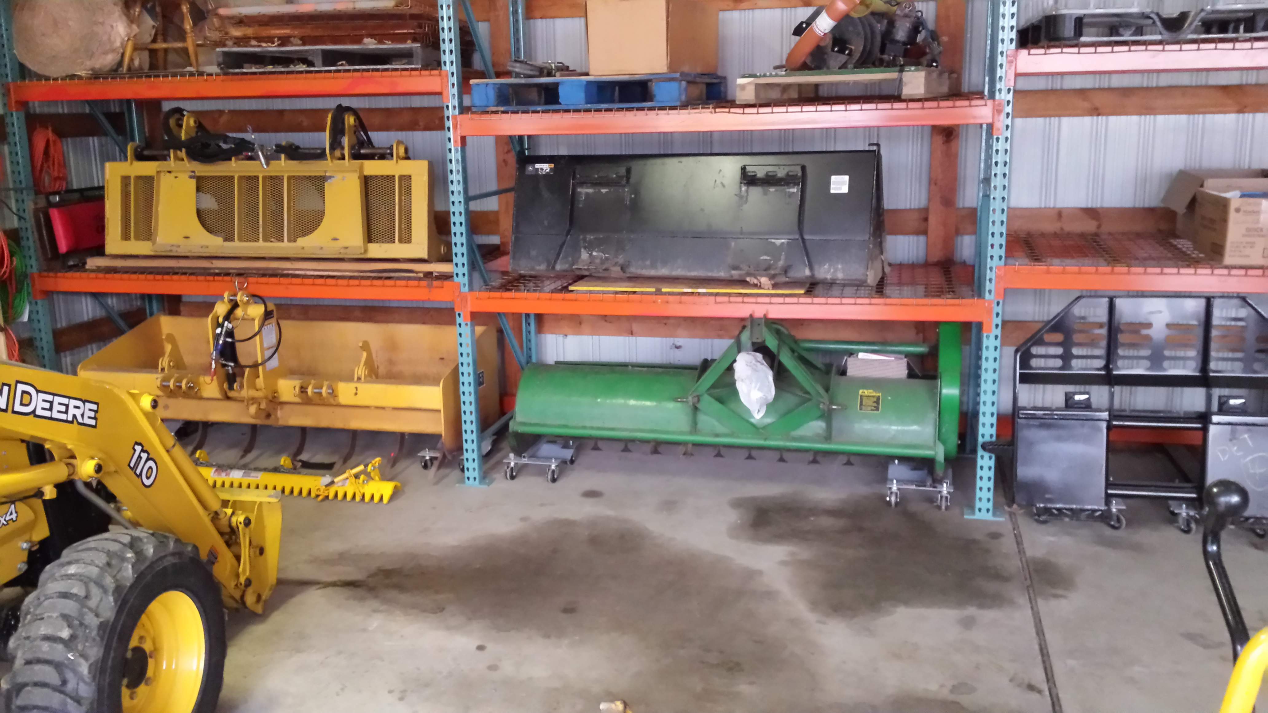

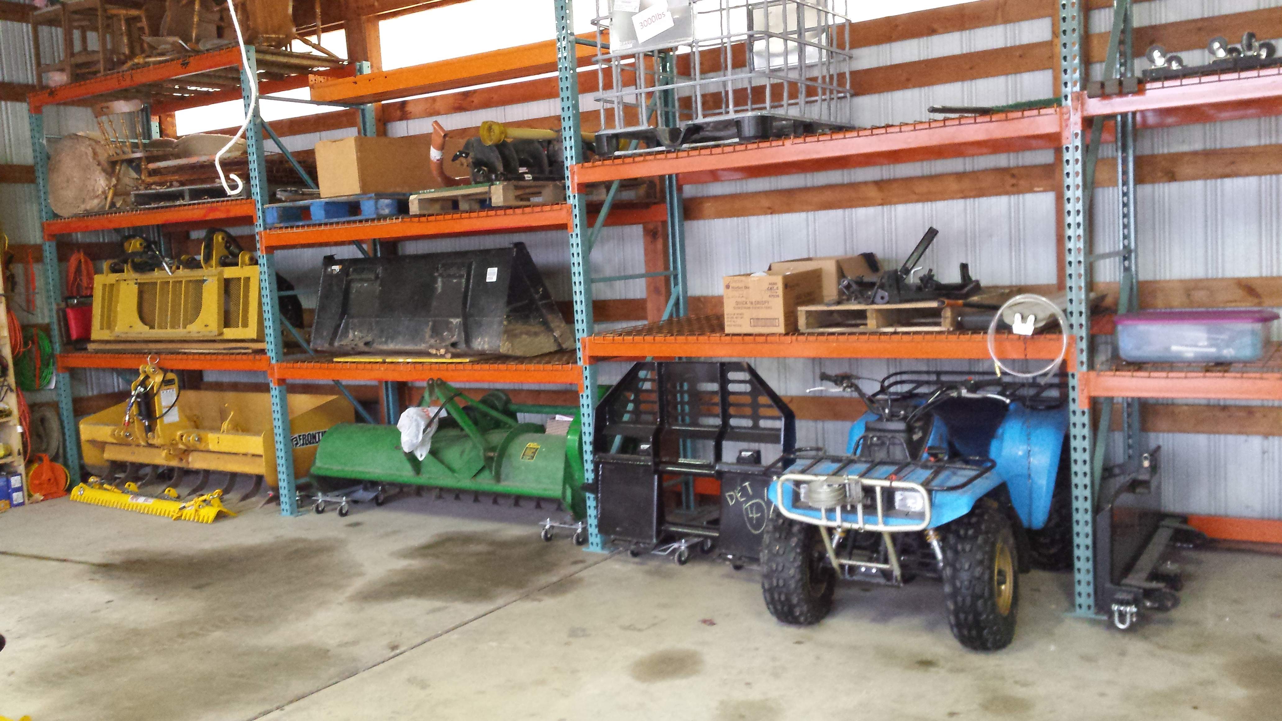

My attachments are stored inside a pole barn with a concrete floor and some are stored on pallet racks.
I use dollies for the attachments that are stored on the floor.
The dollies I use are from HFT.

My general plan had been to store nothing these mini-sheds but implements. Each unit would have room for a 3PH implement on the ground (supported by 6x6 wood blocks?) and a shelf for a FEL attachment. I imagine it would work out somewhat like the bottom left 4 shelves (2 bays wide x 2 bays high) in DocDryden's photos. Since he uses dollies, I assume there wouldn't be enough space to attach the 3PH to the tractor. I possibly need a new plan here.
If I use dollies, then I might need to pour a concrete pad. It looks like pneumatic casters might work well on dirt/gravel, but keeping them inflated might be a hassle. It seems like every time I use my hand truck, I have to inflate the tires. Hmm... back to the drawing board.

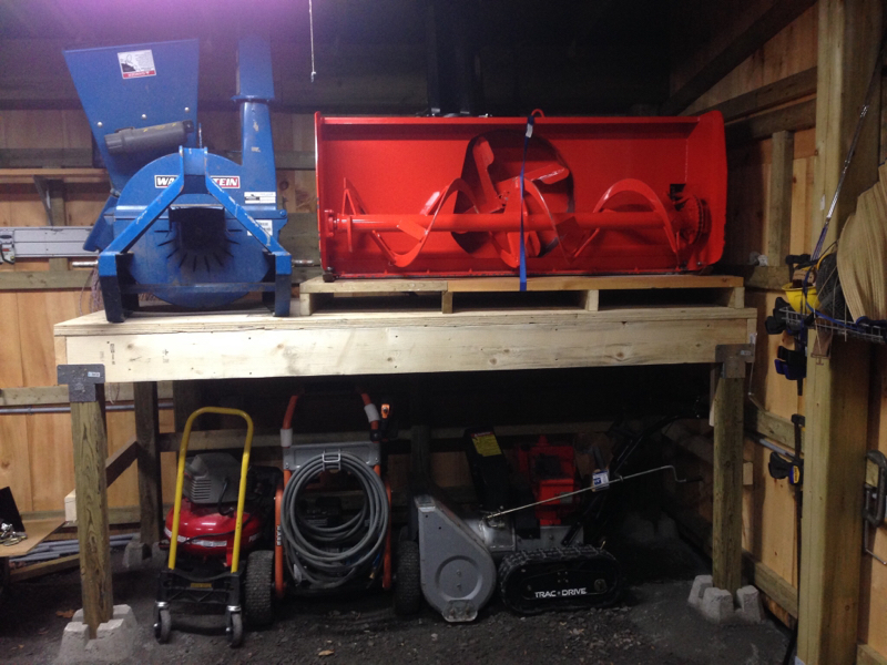

Here is my approach, not dissimilar from others'.

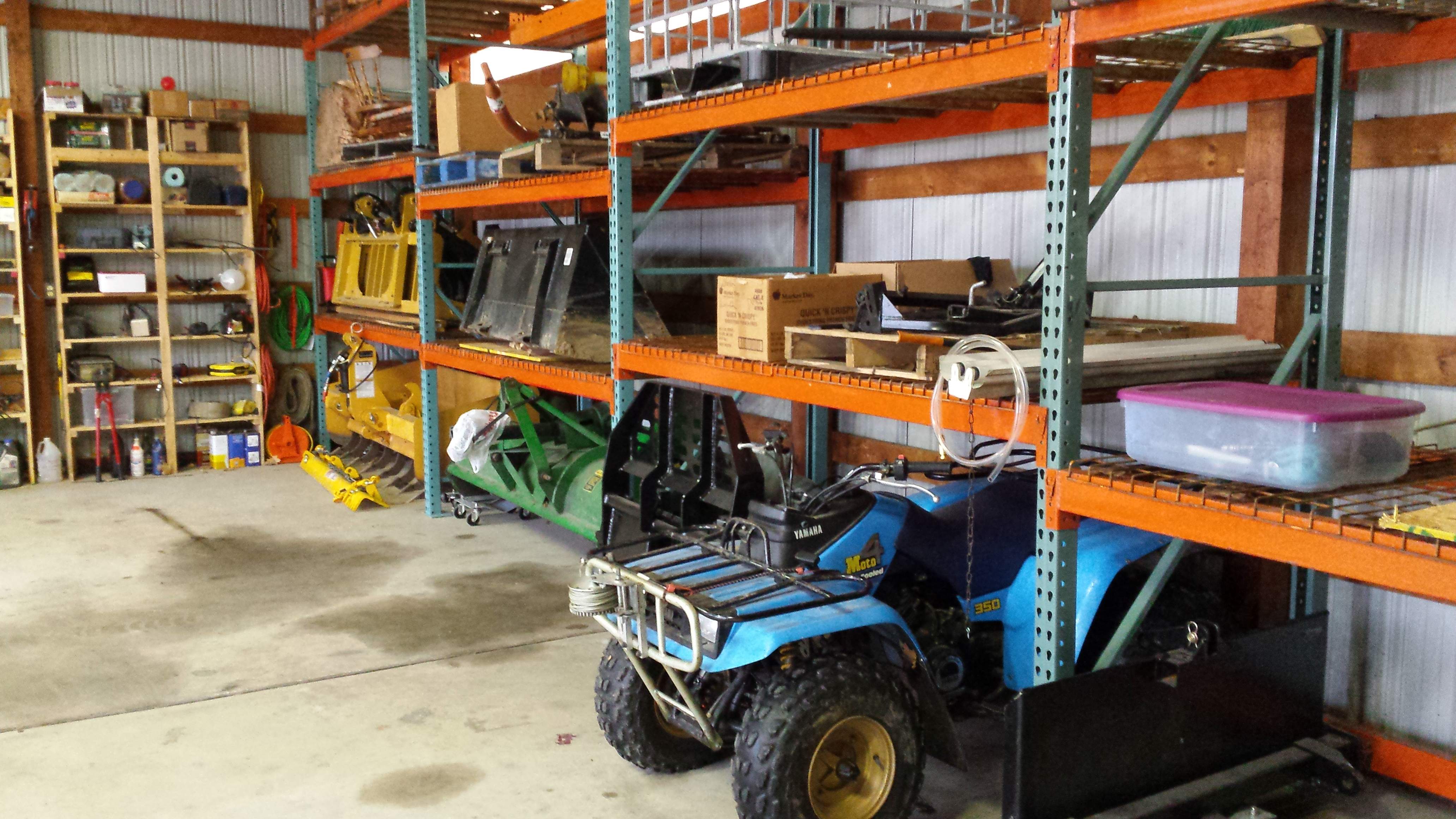

I have a Yamaha Moto4 exactly like that, bought it brand new in 1986!!
I bought mine new in 1987, I just keeps going. The only issues I have had is the Reverse Handle / Lever broke off
   / How do you store your attachments? Stacking options? #40
40 yards penalty for excessive neatness!:D
LOL............ You should have seen it before I got the racks.... better yet give it 6 months
